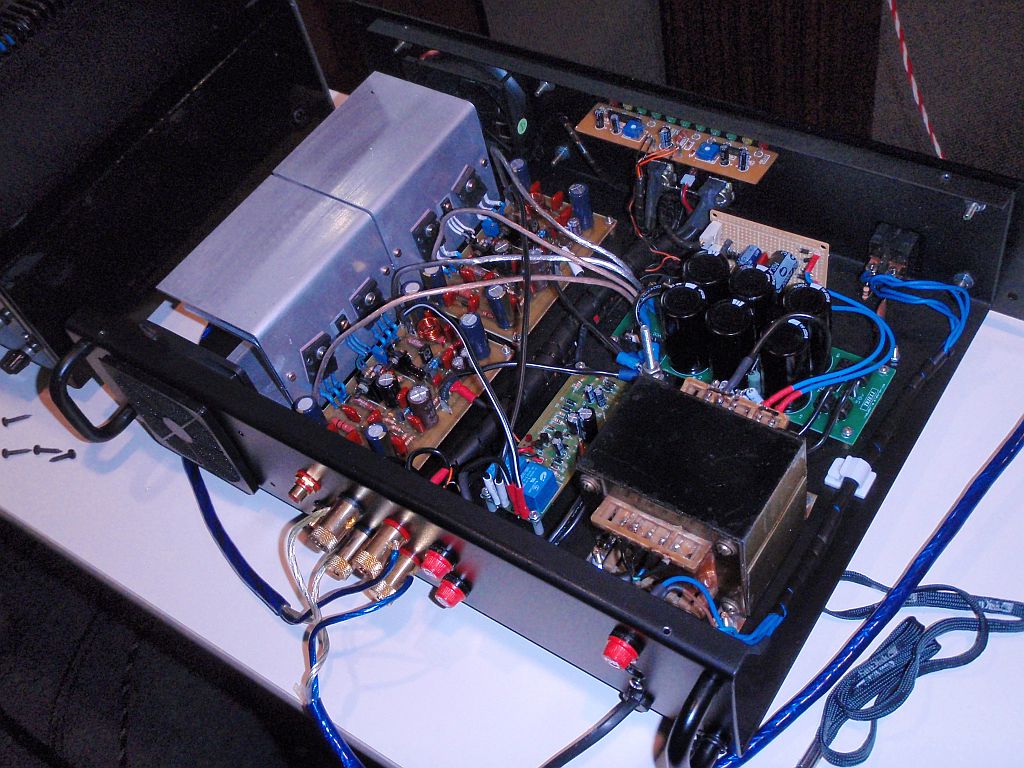

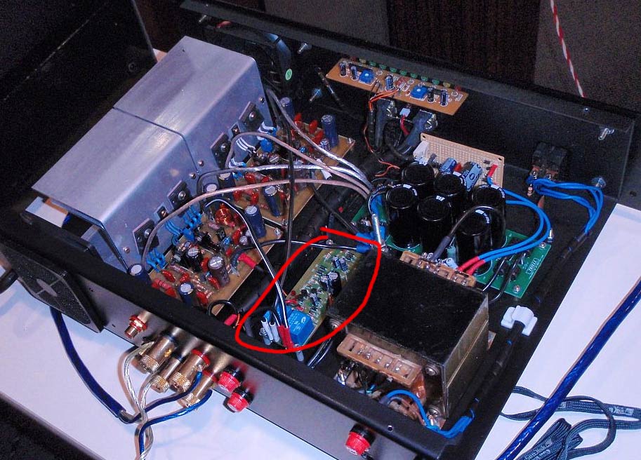

Yes, and the answer is: The transformer was scavenged from a receiver. About 26-0-26Vac. The supply board uses 6A6 diodes and about 18000uF each rail, with fuses.
