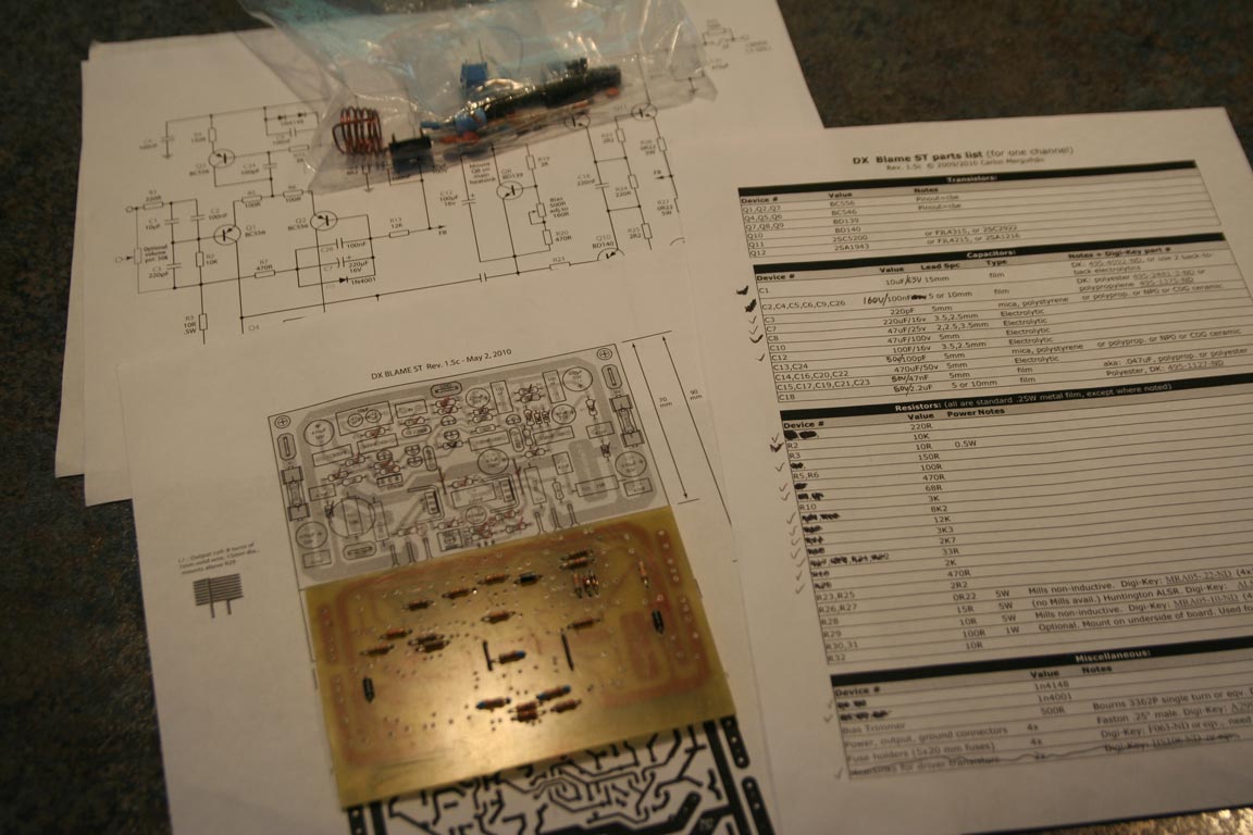

Two more questions before I try mine:
1) I found what seems to be a very good output coil in an old IBM PC PSU. Its diameter is 7 mm, and it is 20 turns long. I'm considering in using about 12 turns. How could we estimate the best length?
2) Wired resistors (not carbon or metal film) are not welcome for the 0.22R ones, right? But, as I live almost near the end of the world, having NO parts warehouse in a 150 km radius, my only option to turn on my prototype is using these guys. What would be the difference from using them or not? I know: it is also an inductor! But I thank for more information on this issue.

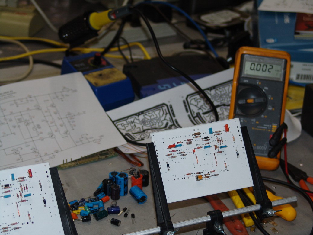

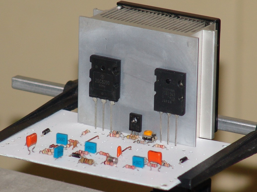

Welcome Mr. Sakis, from Greece! We have met in the Rod Elliot's P3A thread!
Due to the PCB bruhaha, I gave up and decided to enter Mr. Carlos' project thread.
I have already assembled 80% of 2 full boards, expecting to have them tested by the end of this week (I must attend to my job also!!!).

Smartx21..... your IBM supply coil will be good... 20 turns
and 7 milimeters diameter if air core... if has a core, then remove it.
knowing your wire diameter in AWG, them enter here.... from 2uH to 4uH is fine:
http://colomar.com/Shavano/inductor_info.html

Ok, thank you very much!
Max.
Air core is important..if your coil has a ferrite inside..then remove it
ferrite, or iron core, depending how big is the current, saturates and generates noises in the audio reproduction..also increases the resultant inductance..so..the 22 turns, having 7 milimeters diameter, if have ferrite core inside, in the place to air core, will jump high in inductance value.
