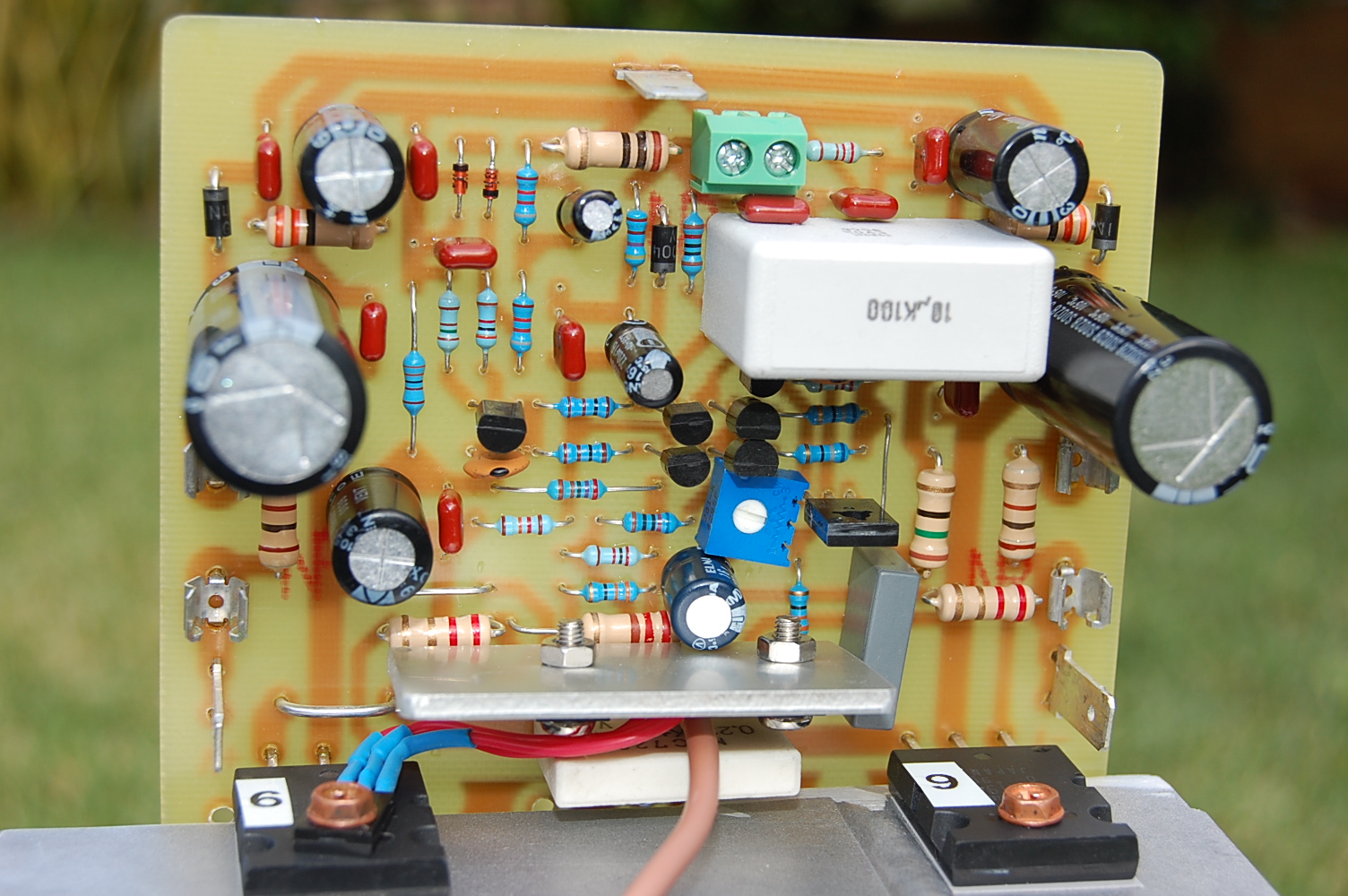

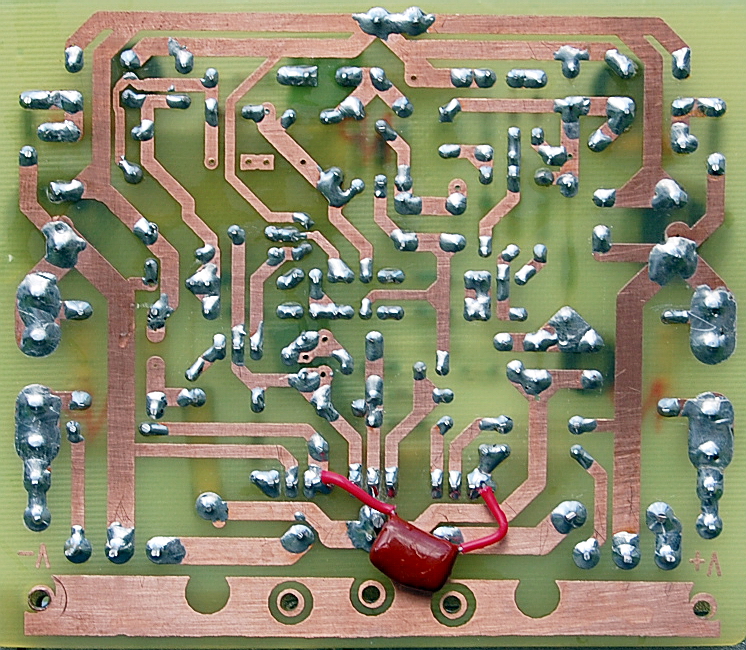

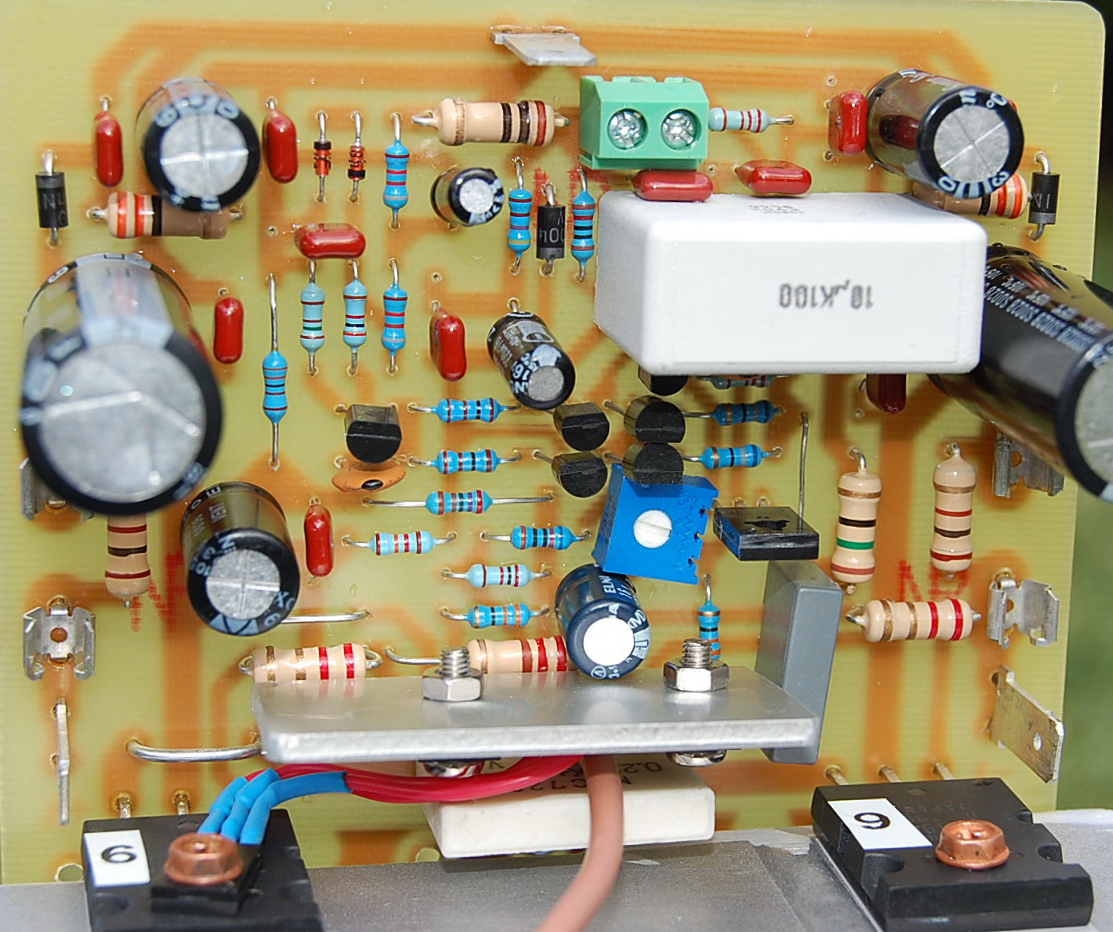

BlameST with Zharmo's layout
Yes, I cannot guarantee my boards style too. i just build what i wanted.

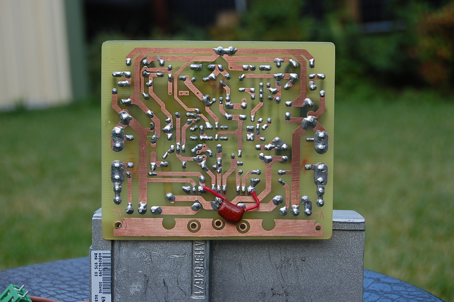

Zharmo,
I am happy to inform you that your Blame-ST layout (the one with the TO-220 drivers) had been verified.
I need a mono-amplifier to power my twenty-years old Magnat speaker in my study and I don't want to spend too much money.
Looking thru my parts bin, I found that I have most of parts for BlameST. I modified Zharmo's Blame-ST layout so that I can fit the monster DC blocking capacitor (C1).
The BlameST sounds very good and it is smooth & relaxing. The amp is quiet (no hum, no hiss) and the DC offset is 15mV.
KiCad is very easy to use. I made the following changes because I have these parts in my parts bin:
C1 : 10uF Evox film capacitor (it is huge : 30 x 23 x 13 mm)
C20, C22 : 1000uF, 63V
C14, C16, C10(bootstrap) : 100uF, 63V
C18: 270nF polyester capacitor (mounted under the board)
R3: 10R (I prefer a virtual ground for input)
R32: replaced by a link
R26 & R27 : Dual 0R22 in a single package (salvaged from a old AV amp)

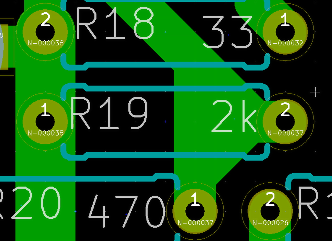

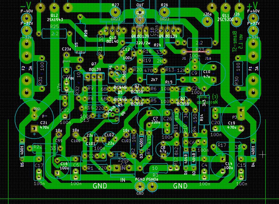

KiCad file for my version of Blame-ST
Thanks to Zharmo, who has done the hard work in putting together the schematic & the board layout. I had made minor modifications to his layout so that it will fit the Fubata MPC722 dual metal-plate resistor (R26+R27) & big input capacitor (C1) with lead spacing between 12.5 & 27.5mm.
I have attached a screenshot from KiCad & my version of KiCad files. I had build a Blame-ST successfully using these files and I made some minor changes so that the trimpot has better clearance.
KiCad is open-sourced and it is FREE and it also can output gerber files so it is good for professional board production. You have to check all the drill holes for size & grid spacing before you send the drill file off.
- Stanley

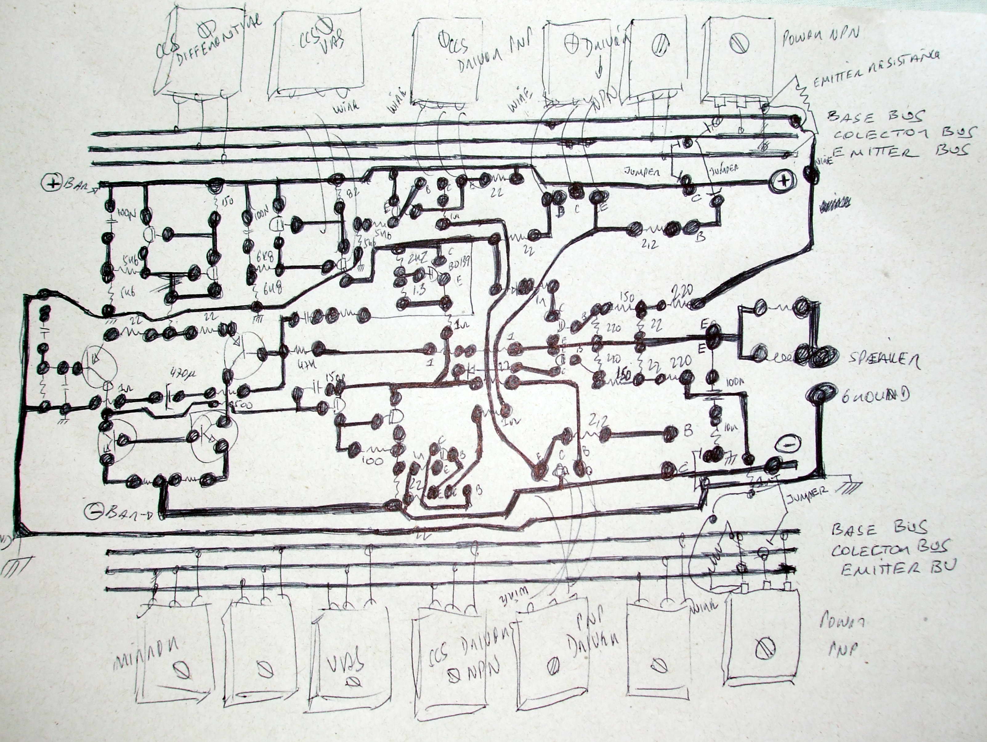

I gonna need, something to the Troyan amplifier....this one to be released in July, Sakis have started to make a board to be tested.
To this next one, the "demolition machine", cooperation is needed, i hope Sakis manage to have time to do..but for sure he has not too much free time to do this enterprise... this gonna represent a sacrifice to him.
I use to offer, as a tradition, a sketch, something from my own....not pretty... exactly to show folks that i really need help, that people has some intimate relation with layout software may do it better.
I am addicted to build amplifier... i don't care how they look but how they sound.... but, for sure, good looking is attractive to builders..and these ones are my main target, to reach them, to have happy people enjoying my amplifiers the same way i enjoy..to share..to be a part of a group where we all share the same sonics, the same experiences.
I could see, observing our friend's behavior these last years, the ones loves software, to make layout, sometimes does not like to assemble... also the opposite happens..the ones loves to assemble does not love software to make layout....a more complete guy was Alex mm...but seems he is busy... Alex used to build all circuit he produced layout.... Todd has never built...he said had not time.
Zharmo did it..the complete job..created the board and have built and tested the board... this avoids surprises, as sometimes long lines in parallel, or small distance between copper lines, output coil too much close to input and several others decision mistakes can drive amplifiers to oscilation..so... this should be tested in advance to the release.

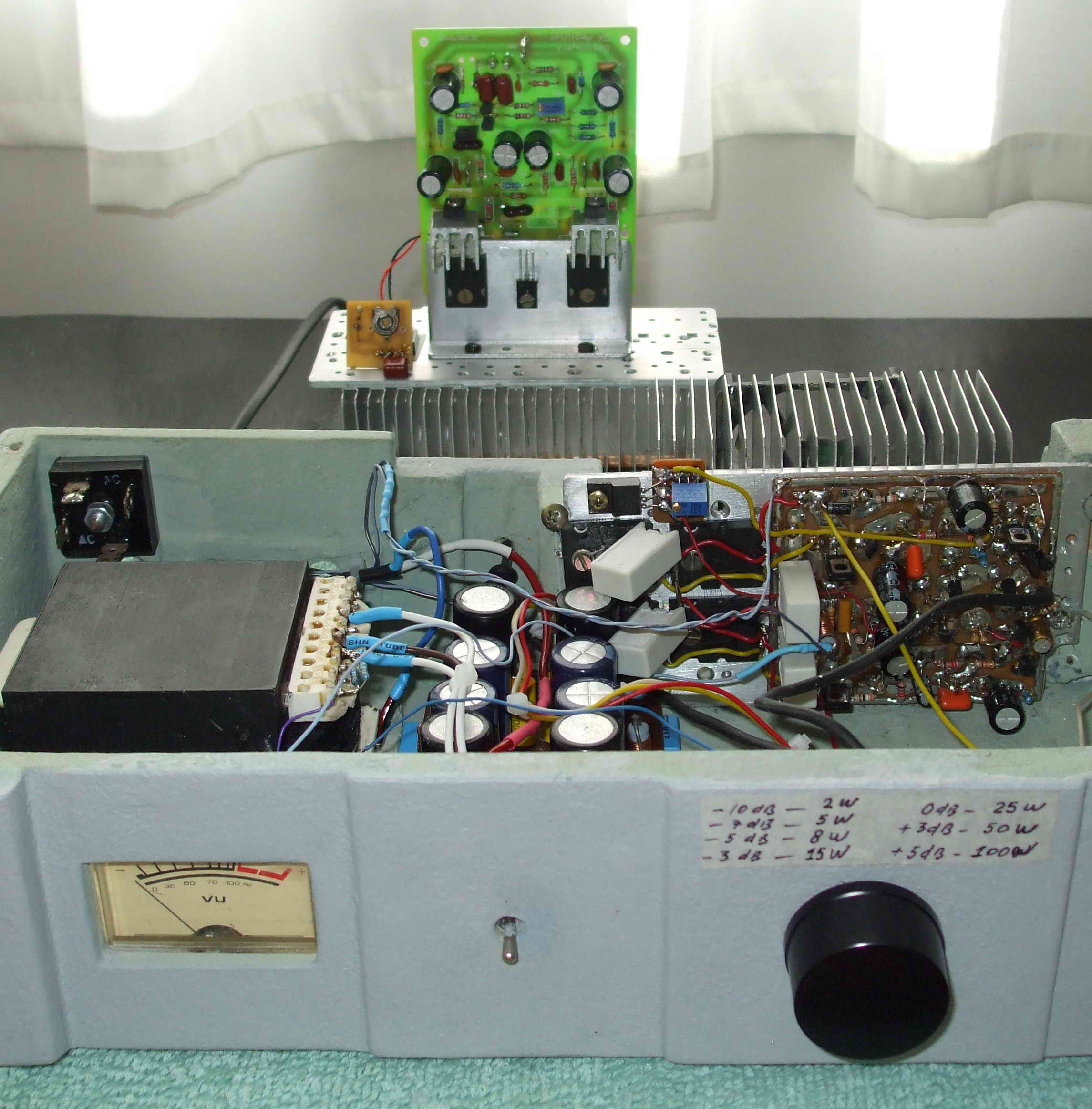

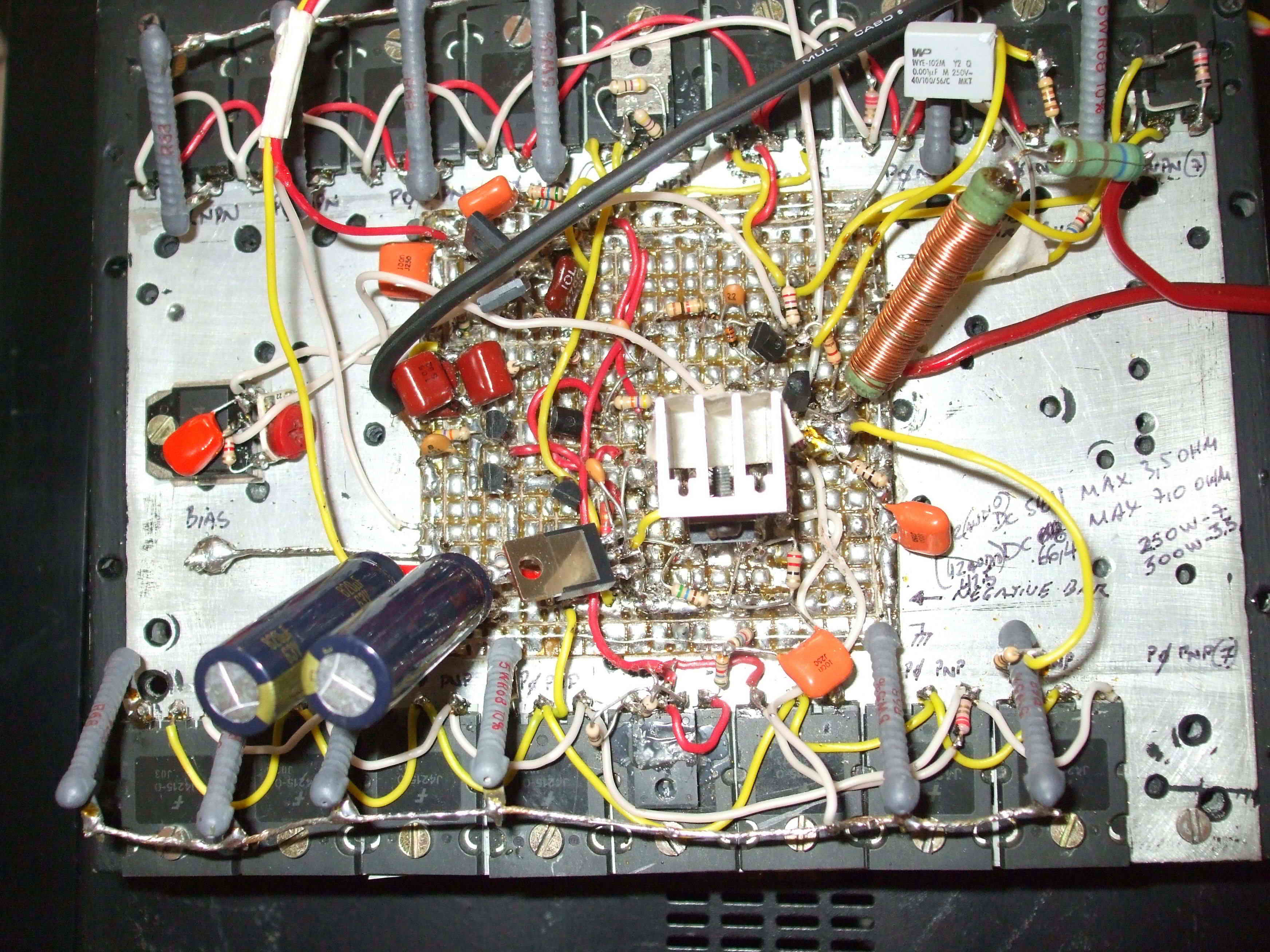

I will be happy with your pictures, as i knew you are producing using the real DIY
:)The spirit..... alike me, you gonna be one more rarity... now a days people order from factories or etch using photographic/chemical method.... old style was almost abandoned...some few guys still uses.
Mine boards, sometimes are point to point... a big mess.
Do you know what i think?.... if an amplifier operates this way, without oscilations, we do not need to worry too much about board layout...because the amplifier proved to be stable...not oscilating after this kind of terrible construction, will not oscilate when assembled in a decent board.
The one resulted better in sonics was this blue/gray one you see at your left... the schematic is old, from the Dx Blame ES.... having a lot of capacitors that use to slow down the circuit and result the ugliest think i have ever done...absolutelly awfull...but it is beating decent boards...not good to see...excelent to listen too...i had not courage to dismount the mess... supply is not decent too... transformer has huge voltage drop...even this way..the best unit i have .... and i have several Dx Blame ES and ST at my home.... parts selection counts too.... they sound a little bit different..even the two ones using the same board (some small differences matters)
These constructions were made by a man...the ones have not that brigth in the eyes.... macho style...no pink shoes, no hair styling emulsion...no perfum...no nail polish, no batton, no solar filter, not shaved. a male working...had sweat smell....a man you know..the one has strong voice and knowledge how to catch a woman going straigth to the point, not letting room to any doubt about his intentions (to attack and dominate)..... masculine style... without worries if pretty or handsome.... this is what means our board style, honoring the 100 women we had in this life.

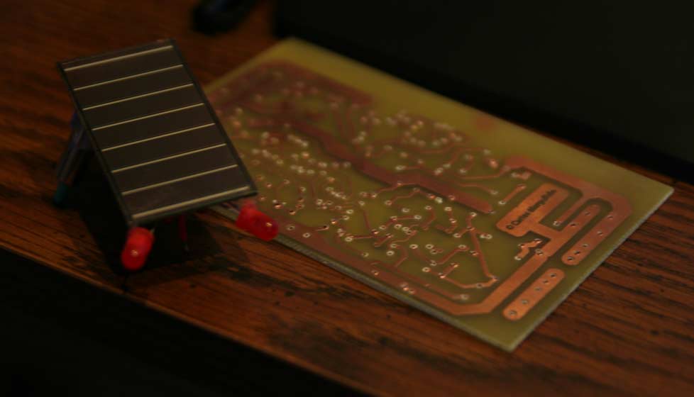

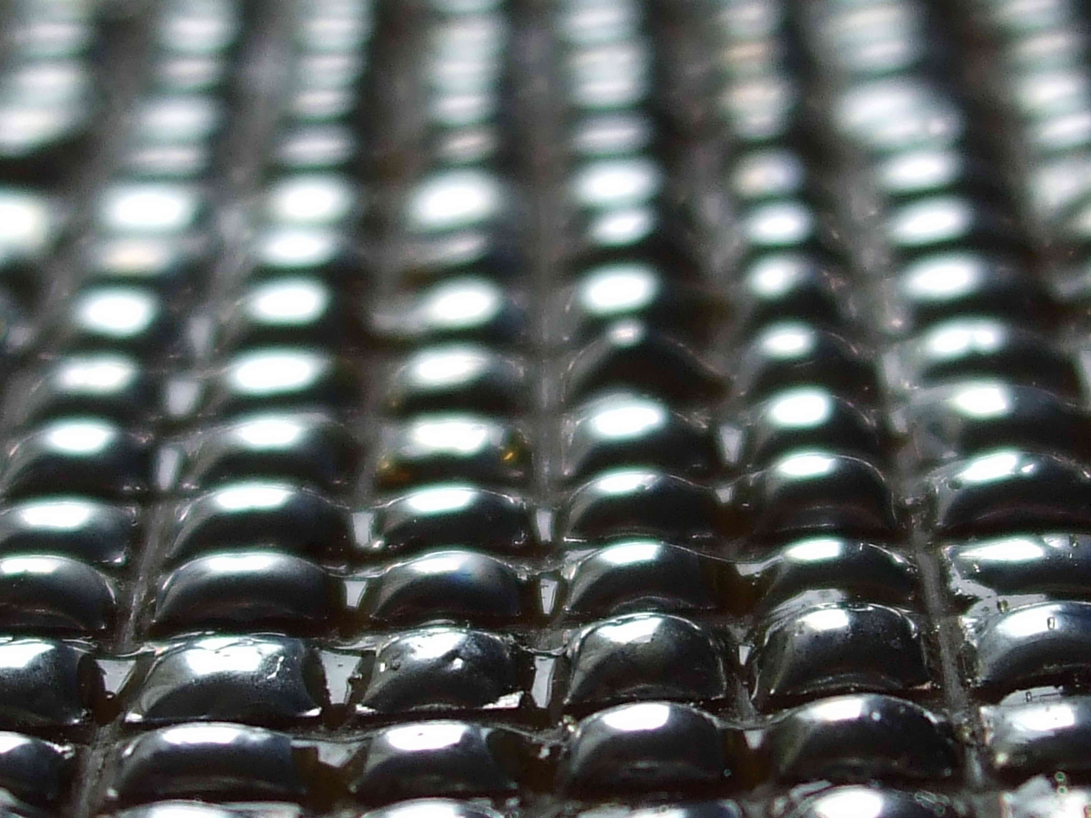

I finished my board layout all except for three (not one) hole.... it was fun drilling all 100 and some odd holes...
I'm going to start dry placing in all the parts i currently have (Or i might tin the traces), The possibility's are endless. I currently don't have any of the transistor or any of the high wattage resistors (Or even the high voltage capacitors).
If I'm not to lazy ill post some pictures :D
Got around to it
Here's some pictures that i have of the parts (the little amount that i have) and the board layout in all its messy glory... Oh yes, and a solar bug :D, little thing has been creeping in my crawl space!
You might not be able to see it in the pictures, but i have in fact missed four holes that i haven't drilled (and three extras on the ground track).
Kurtis
