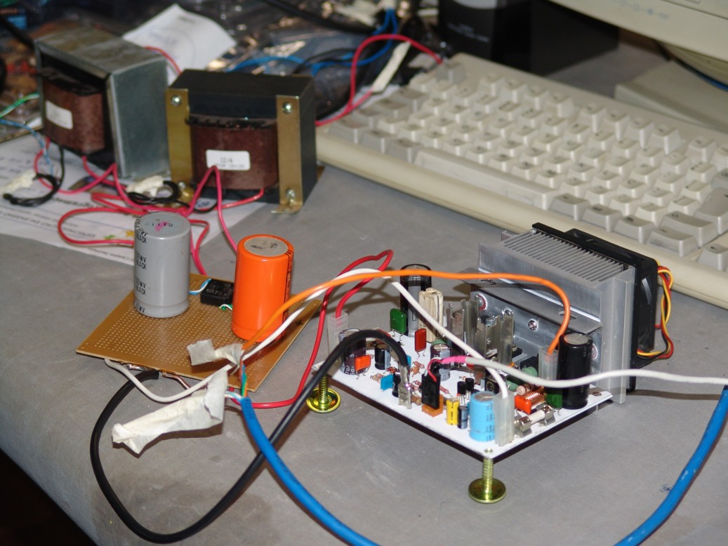

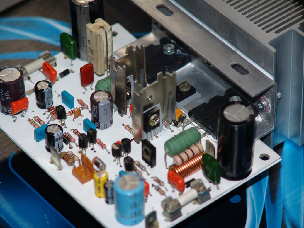

Try to adjust to 4.7V over the rail protective series resistances
the trimpot should be preset from 160 to 250 ohms during start up...then you adjust the stand by current turning the trimpot.
This trimpot, in the maximum resistance will provide you low bias.... reducing the resistance during adjustment, the bias will increase, and so on the stand by current.
Some folks forget to connect the fuse, and try to listen music loud having the series resistances not bypassed by the fuse...but for sure you have observed that.
Good luck.

I just have to say: SUPERB!
Miles away from what I ever have done in whole life!
Amazing!
Thank you very very much!!!
It surpasses all the expactations.
I let bias voltage at around 4V!!!
God bless you!
I will sleep well this night!
Sorry for all the boring mails.
Till next time.
Max.

Testing with two 12+12V 4A transformers!
YouTube - DX Blame ST by Max

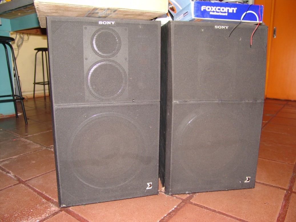

What a pity, my Sony DSC-F828 does not register all the sound (especially the bass) that comes out from the also Sony loudspeakers...
For not having the necessary parts, these two have been linked together, becoming a 24+24VAC!!!
