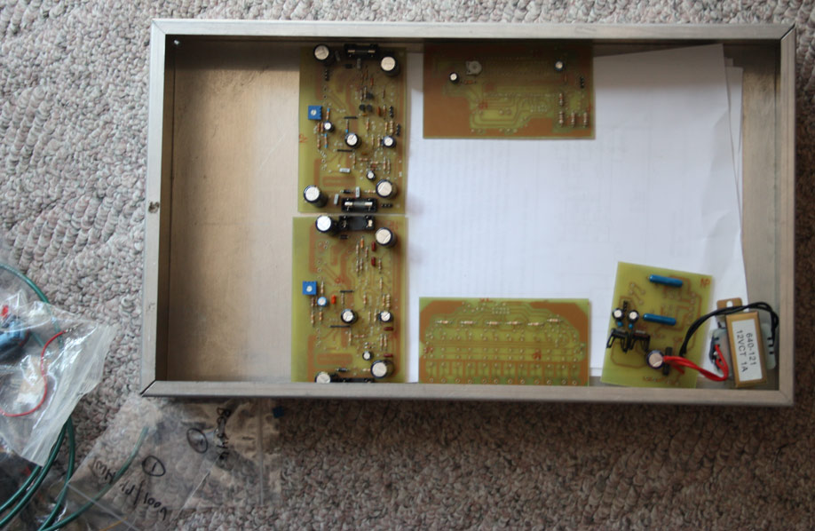

Just a small update, I picked up my enclosure today. It's an 33cm-25cm-7.6cm rectangle, I'm not quite sure what its made out of... sheet metal maybe? I'll post some pictures when I have something mildly completed

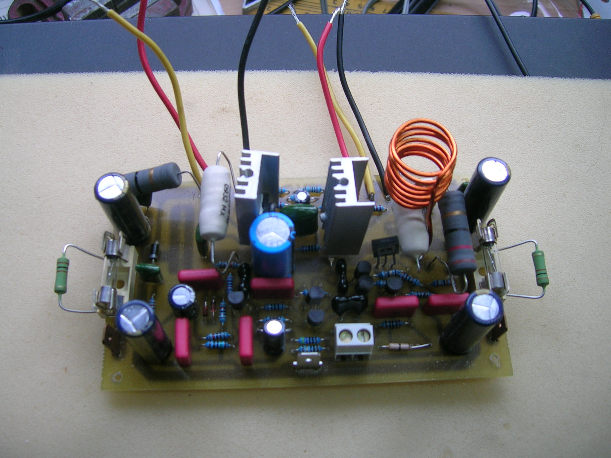

Didn't listen yet but it will be soon.I have to find smaller resistors but when I order 5watt resistors in Europe they're always that big.The white ones from the picture are induction free ones they are wound bifilar I can change them with the MPC71 ones.Maybe there is someone who can make a new layout of the amp for those big resistors?Post your evaluation for us as soon as you listen.
It is looking good, despite the big resistances.
The input condenser should not be bigger than 10uf..... increasing it is not increasing bass, the result is reduction of treble.
The amplifier, the Blame ES, is a little bit shy in the low end....the Blame ST, the last version, has much more bass.
regards,
Carlos

Update
I got some more parts! The amp is slowly comin' together. I also know what kind of power-supply I am going to be using; Bora's Universal power-supply without the soft start. The soft start that I am going to be using is Rod Elliott's: Soft-Start Circuit For Power Amps
