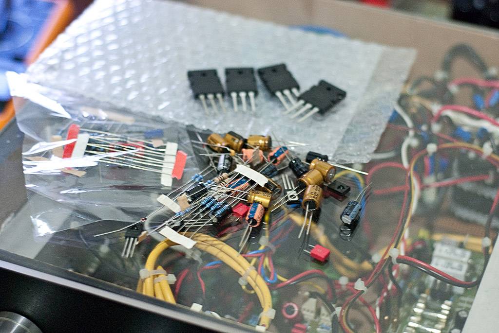

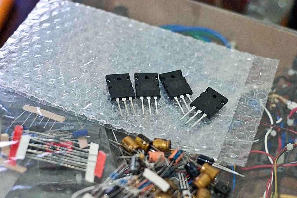

Some Pictures of the components
Im still lacking some of the Resistors and they are on the way, and the Fiber boards for the PCB's are also on the way, Im gonna etch the boards using the toner Transfer method..

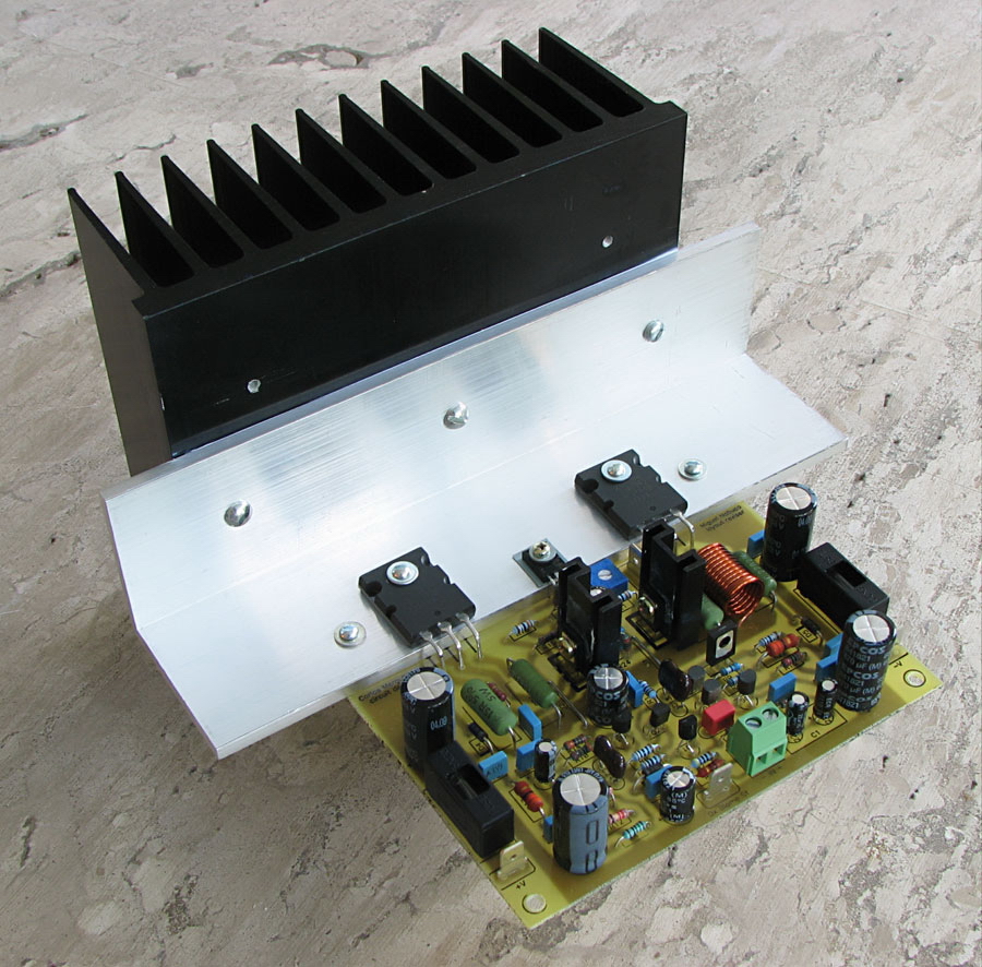

A group buy organized by Miguel Nabuco is collecting around 70 orders for kits that will have two supply boards (separated supplies, one to each channel), an circuit to protect against surge... an AC delayed insertion using relay and NTC, two boards (one to each channel) consisting a protector, Dc detector and speaker delayed insertion...and off course two circuit boards that belongs to the audio amplifier.
The board had the layout sligthly modified, but was based in Todd Johnson's layout that had 95 percent of Todd's original work....some room for output coils and some details, alike increase of space to Brazilian style fuse holders and things alike.

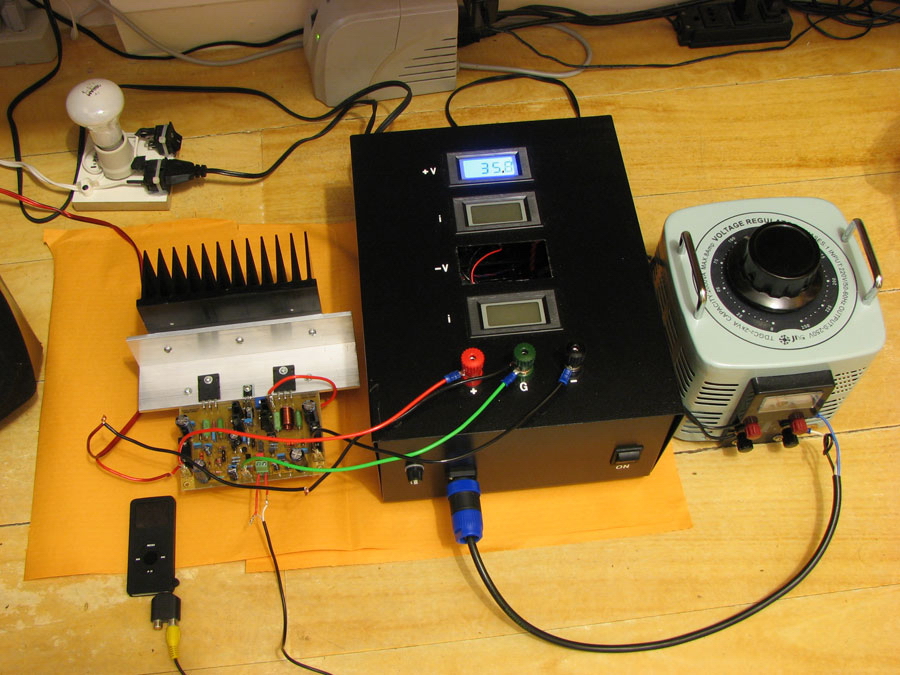

Here you have a video from Miguel Nabuco, where he shows his Variac and his supply...you see he is using Ipod (not recomended).
He will proceed more tests, using scope and generators and soon we gonna have more informations from him.

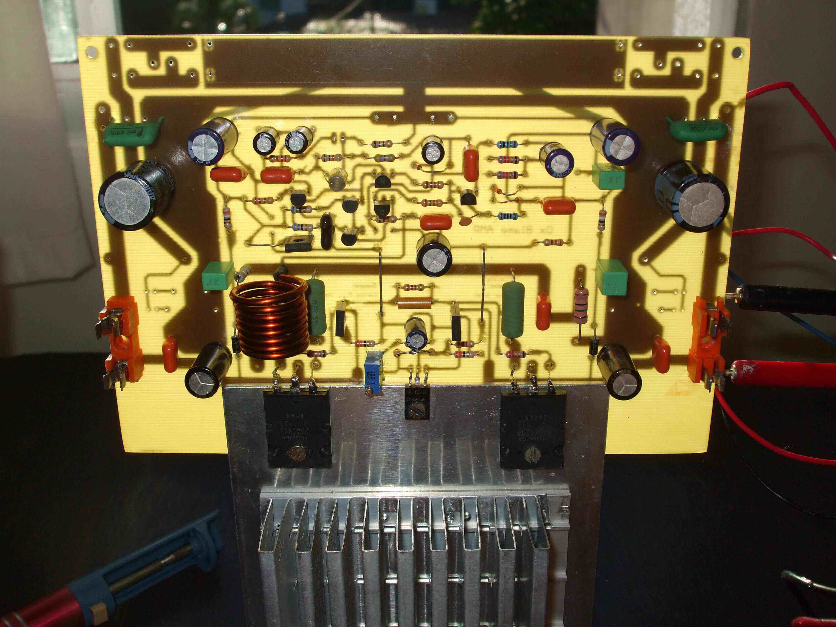

The image is the German board....this one is larger and has room to install high speed rectifiers and several supply filters...the whole Dx supply can go over this board.

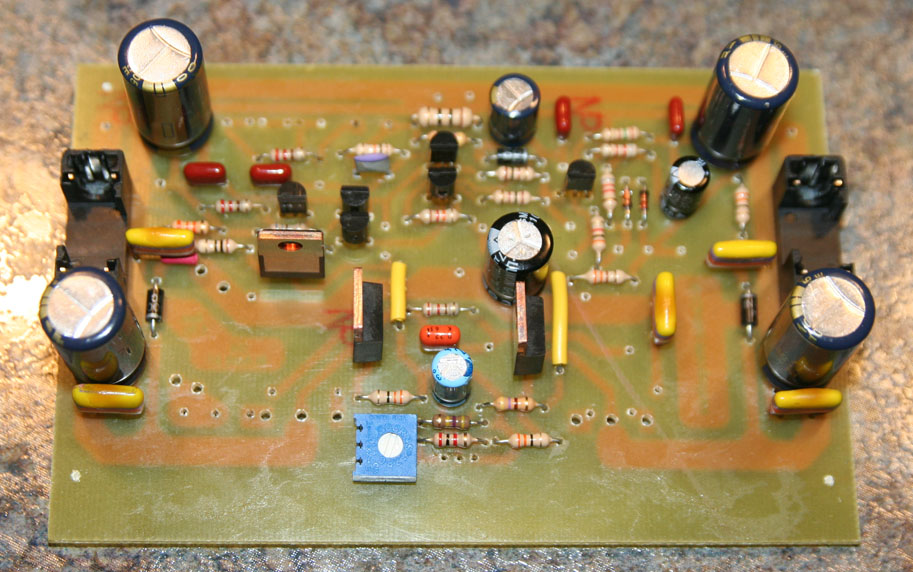

In my slow building process of building, I have some more pictures (and some some strange film caps ). Starting to look like a amp!
Dear Knight, which transistors are you using in VAS and Drivers?
These are MJE15034/MJE15035
Nice amplifier Kurtis.... a pity that you could not find BD139/140
These ones you are using, at the simulator, distorts more...but for sure the distortion is below the human audibility limits..so..everything gonna be fine....you will not listen the result of their presence in this circuit.
Good luck... i ensure you gonna have a divine experience in your life..the sound of this unit is awsome...we perceive this in the first second it plays.
Prepare yourself to feel good.... to dance...to smile and laugh of pleasure.... search for a good recording, the traditional PCM, wave format or Flac format..something with good sound quality to enjoy the excellence of sonics this amplifier can reproduce.
