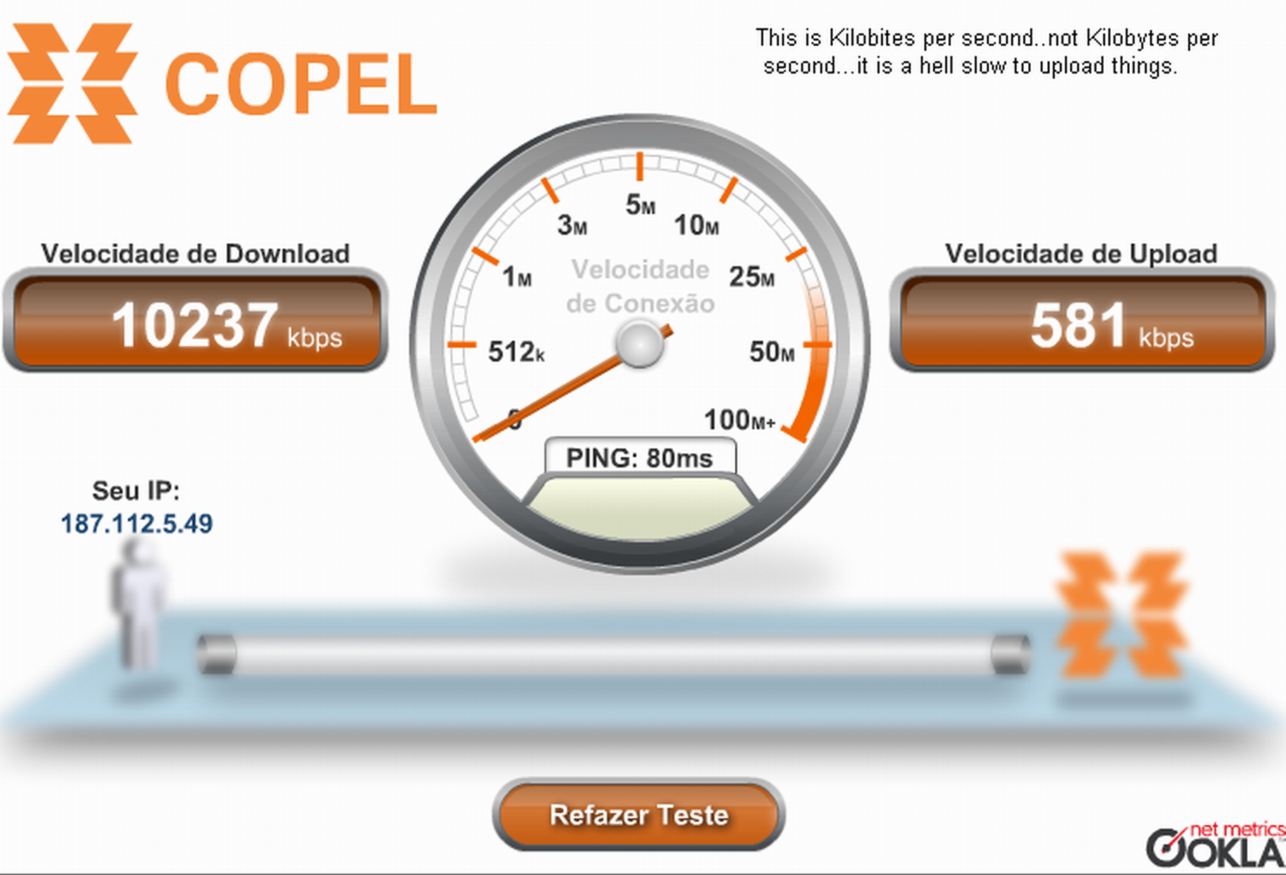

Too much big to be uploaded Kanwar
Also i have no Brazilian music in Flac format...the one may have is Mr. Professor.
I have one, but was traditional PCM format (wave)...and the one is even bigger.
My upload speed is slow.... maximum of 100 kbps.... the upload speed is 10 times bigger.
To send Flac or wave, represents 30 minutes of upload. (average)
