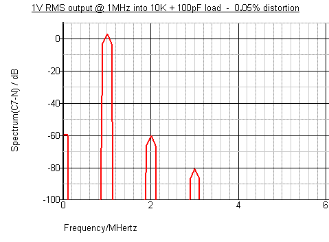

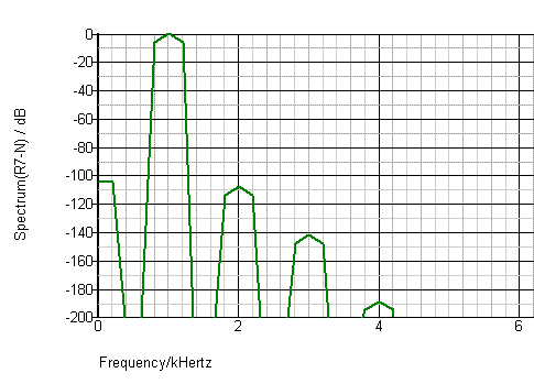

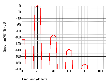

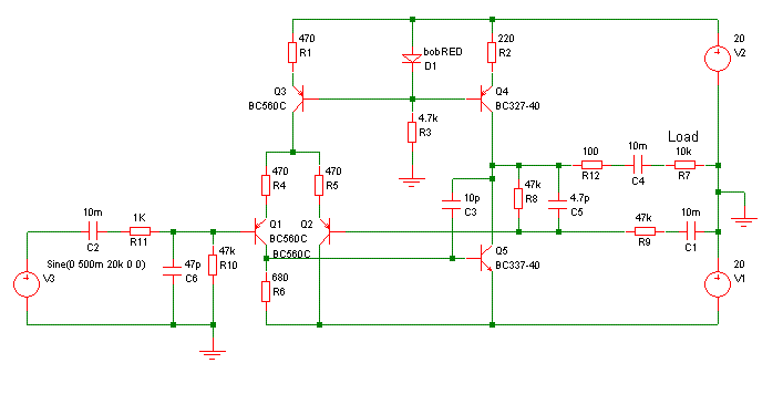

Out of curiosity, I simmed a simple circuit with no buffer and got pretty decent results. Distortion at 2V pk-pk output into a 10K load looks like about 4ppm @ 1KHz, and 30ppm at 20KHz. It's mostly 2'nd harmonic too; everything else is far down.
I did notice that a small cap across the feedback resistor is needed for good stability, mostly to ensure that the base of Q2 is driven from a low impedance at high frequencies. Also note that heavy degeneration of the input pair allows good stability with a small Miller cap.
Disclaimer: real world performance is likely to be different to the simulator results since the spice transistor models aren't likely to be very accurate.
P.S. The 10m caps in the circuit are artificially high just to reduce simulator errors.

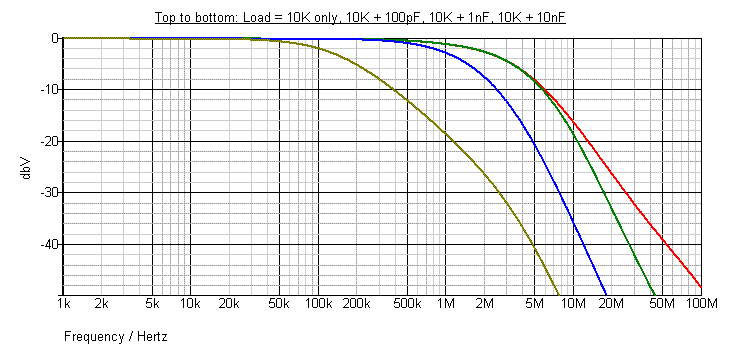

I don't think I have these options. See the attached screen shot.
Hmm... Looks like you can at least set the "sampling start time" to 5 or 10 mS. That might help. Getting rid if coupling caps, or using huge values also helps a lot. e.g. the 10000uF caps in the circuit I just posted.

Half the reason I did the sim above is that, IIRC, the OP never simmed the original circuit before going to town with the mods. So it was sort of a "back to the roots" exercise, sticking as close as possible to the original (except for the CCSs - the original biasing scheme deserves to be taken out and shot :eek:).
Edit:

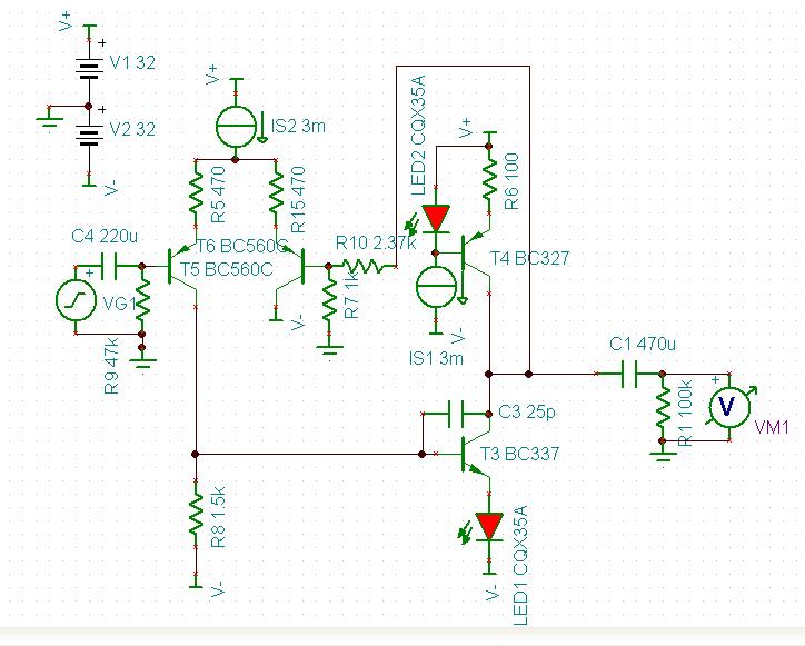

I just tried the sim again, but changed the transistors to Bob Cordell's models for 2n3904 and 2n3906 (i.e. good models of bad transistors). Distortion remained about the same at 20KHz and only got about 3 times worse at 1KHz. That's encouraging.
Adding the diamond buffer seems to drop the distortion about 10 times (0.02% vs. 0.002%, 1kHz, 1Vp-p), given the same values for the LTP and VAS in each of them. Fourier analyzer was delayed by 0.0076 sec. I left the buffer untouched. The CRD's have internal impedances of 1M ohm. The current in the VAS is about 7.5mA. I increased degeneration in the LTP as suggested. CRD's fit on the board much better than discrete components. Bandwidth is good with nice smooth roll off above 1MHz with no funny stuff. There is no phase shift in the audio range. I believe these transistors are current production so this could be built with them instead of using the originals, which are 2SA1015 in the LTP, 2SD667 for the VAS, and 2SB647 for the CCS. I did buy those already though.

Bandwidth is good with a nice smooth rolloff above 1MHz.

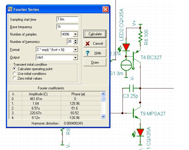

OK, I substituted a Darlington component, the MPSA27 from the Tina library for the BC337 pair, rebalanced the LTP and cut distortion even further.
Bandwidth remains good with a slightly earlier rolloff before 1MHz.

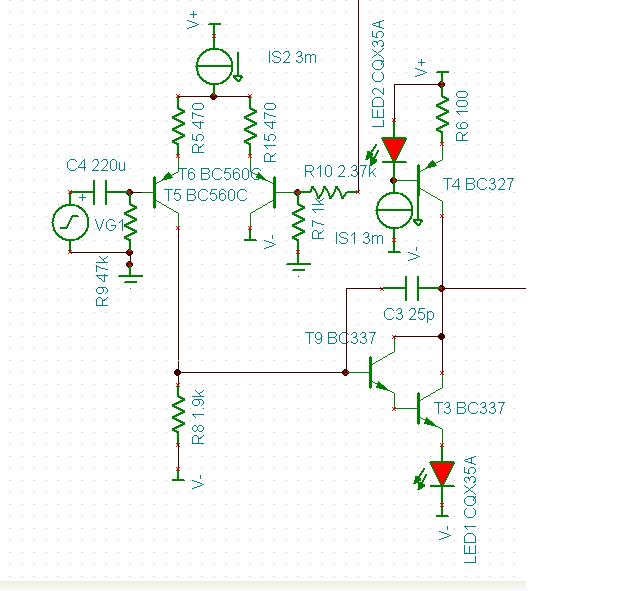

I added another BC337 to make a Darlington pair in the VAS.
That circuit should work a lot better with 2 little changes:
A) Connect the collector of T9 to ground, rather than to the collector of T3, so you don't have T9's nonlinear collector-base capacitance in parallel with C3.
B) Connect a resistor (1K to 2K?) between the emitter of T9 and the negative supply rail, so that there is always 1 or 2mA of current flowing through T9.

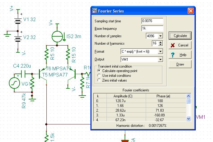

So, I got a little crazy here. I replaced the input pair with PNP Darlington transistors, the MPSA77, which is now End of Life unfortunately. I reduced the degeneration resistors to 10 ohms. Distortion is now 0.0017% with no buffer. Dang. I'm impressed. Bandwidth is still good up to about 1MHz.

Thanks but I don't think I have room on the board to make these changes, even if I use SMD's.
