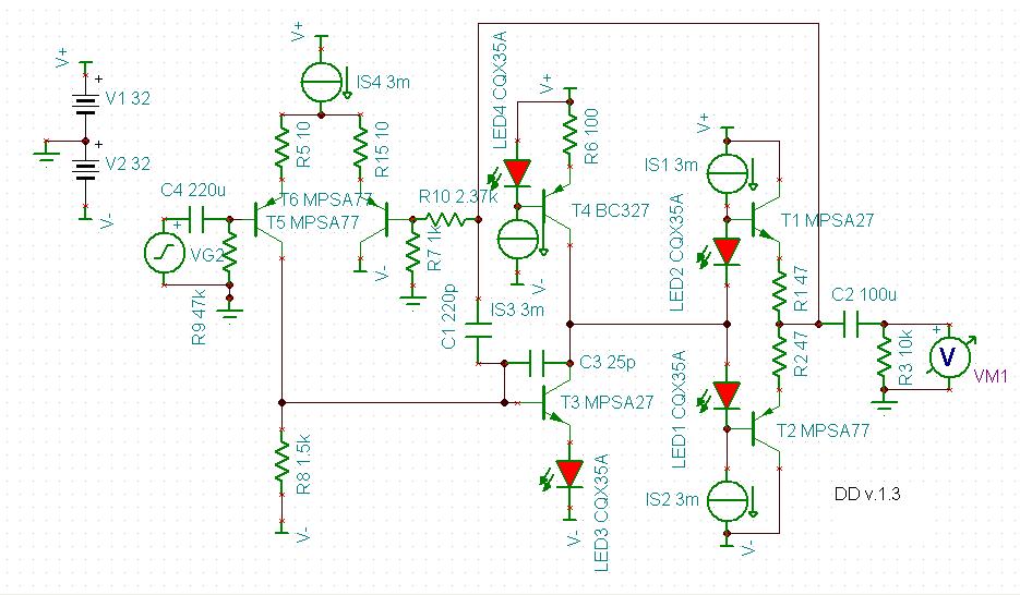

OK, so I'm feeling a little nutty. Now we are in the really low distortion region. Input pair is the same as the other circuit, but this one has the buffer as well. This is pretty freaking low distortion if you ask me!
Thanks for the ideas!

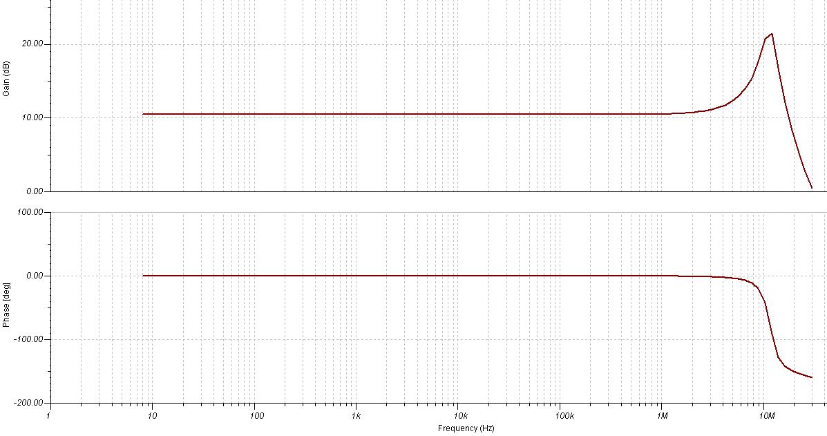

OK, this is the first version with double darlingtons in the input stage, and a darlington in the VAS. Distortion was as before, but resonance remains. I call this "Simple Line Stage DD v.1.0". There's a resonance peak at about 12MHz. I tried killing it with the Miller capacitor but it's gets so large that the slew rate probably suffers.
Try to put a cap over R10.
Fortunately, this time it's effective. In previous versions of this circuit, that cap wasn't useful. I know this is the normal thing to do, but it was performing very well before without one. So, I put 47pF across R10 and it's fine now. Thanks.
Distortion is back up @ 0.007%. Capacitors are evil....

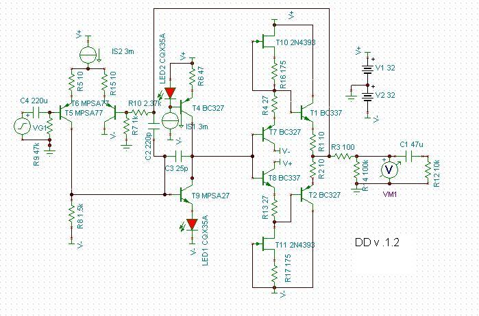

OK, someone suggested adding a capacitor between the output of the VAS and the feedback network. So, I did this. I added the 220pF between the Miller capacitor and the feedback network. This makes for a nice smooth roll off (with a very small bump) at about 2MHz, and the bonus is that distortion is actually lower! It is now 2.2x10^-5 (0.000022% I think). I can have the roll off I need as well as the low distortion I want!

Attempts to close the loop that way are frequently found to entail high frequency oscillations, at least in power amplifiers (see Self's article in Linear Audio Vol. 0 for example, "Inclusive Compensation and Ultra-low Distortion Power Amplifiers"). Self shows a way of doing it partway without typically having difficulties. However, the motivation is usually reduction in output-stage distortion, and your output stage is pretty free from the need for that. So maybe it's worth doing for other reasons.
I think it's getting to be time for you to heat up the soldering iron and get your feet wet. Wait, maybe that's a little too mixed of a metaphor :D

PS: My guess is that "beta enhancement" probably just refers to the insertion of an emitter follower between the diff output and the "VAS" input base, which as Godfrey pointed out is not identical to using a darlington --- you want to ensure some emitter current that's a good deal more than the "VAS" base current, and avoid the voltage modulation of the new device's collector-base capacitance and the attendant distortion.
Thanks. I have no idea why that capacitor works, at least in simulation. It was just a "let's see what this does" kind of thing.
Unfortunately, I don't have the means to test a circuit like this in the real world, so I have to just trust the sim for now. I'm working on getting some of the MPSA77's, since they are "on order" at Mouser. Fairchild is discontinuing them. There seems to be very few PNP darlington transistors in the TO-92 package.

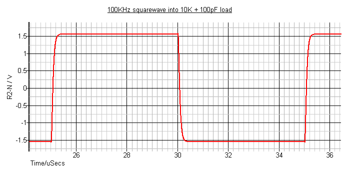

Well then, as you continue to live in Simland, it may be time to start simulating the circuit's response to fast square waves, as you have just added a whole lot more work for the available diff pair current in changing the output voltage.
Do you at least have an oscilloscope?

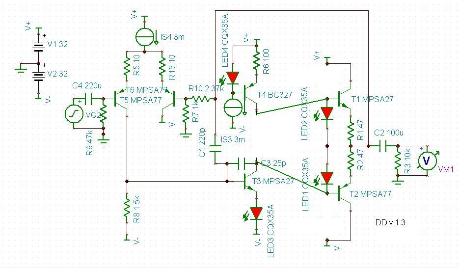

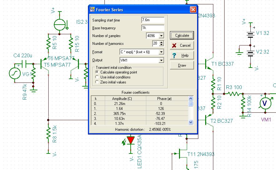

Working on this thing is addictive. I simplified the buffer. It's now a simple push pull darlington arrangement, but I don't think the MPSA77 and MPSA27 are compliments of each other. Anyway, distortion is 2x10^-5%, bandwidth rolls off as before with that funny 220pF capacitor in place.
Actually that's not too bad an idea, although what the sim will probably not tell you is that the standard red LEDs have a tempco of forward voltage about the same as a single bipolar's base-emitter voltage, and the Darlingtons have more than twice this (the tempco is a weak function of collector current density, rising at low currents). The diamond buffer is better temperature-compensated (although PNPs are usually not a perfect match to NPNs). However, with the 47 ohms in each emitter you're probably fine in domestic environments.
I simplified the buffer. It's now a simple push pull darlington arrangement...
Nice! You can save a couple of parts by biasing the LEDs with the VAS current, instead of dedicated CCSs (See untidy pic below).
I share bcarso's lack of enthusiasm for Darlingtons though, and would probably use a single LED with the BC327/BC337 pair (or similar) and 22R emitter resistors.
...tempco...
I don't think that's a big deal here in a class A stage with a few hundred mV across the emitter resistors. A temperature change of 20 degrees centigrade only changes the idling current by 10% or so (rough thumb-suck).

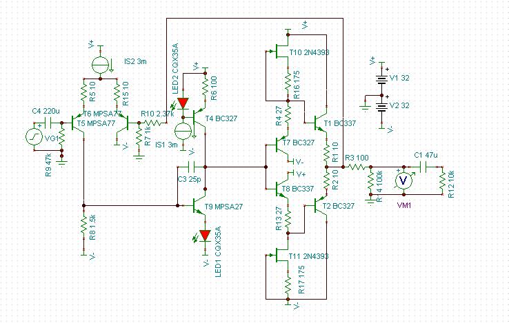

The CRD's have internal impedances of 1M ohm....
CRD's fit on the board much better than discrete components....
Oh OK, so they're not too bad then. Why not use one to load the VAS as well? That would free up some valuable board space. You could probably even include a simple output buffer on the original PCB. Something like in the circuit below.
BTW, don't get trapped into thinking you have to add more parts to improve something. Often simpler is better. A couple of examples that come to mind, from the masters of high end audio design:
Nelson Pass's F5 power amp contains a grand total of 4 transistors in the signal path (plus 2 in the protection circuitry).
The CTC Blowtorch preamp, widely regarded as one of the best in the world, has no output buffer.

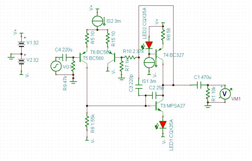

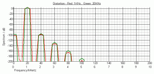

This is an updated version with no buffer. Distortion is 0.0009% into 10kohms @ 1kHz, 1Vp-p. I changed the input differential back to the BC560, adjusted the load resistor, and increased the current in the VAS. Bandwidth has a nice smooth roll off above 1MHz. This version is very simple, with just the 220pF capacitor needing to be added to the board. Everything else has a hole or some kind of landing spot.
