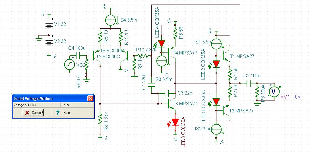

A couple of thoughts:
C2 and C3 are in parallel now, giving a total of 245pF of Miller compensation. That really is very high. The problem is that the Miller cap has the full signal voltage across it and all the signal current through that cap has to be supplied by the input stage. The bigger the cap, the harder the input stage has to work at high frequencies. A smaller cap gives lower distortion and faster slew rate.
The emitter resistors in the input stage aren't providing much degeneration. The dynamic impedance of the emitters is about 20R anyway, so the 10R resistors are only reducing the transconductance by about 30%. Increasing the resistors to say 100R would give a 5-to-1 degeneration. That not only directly reduces the distortion of the input stage, it also allows you to use a much smaller Miller cap.
btw, Doesn't R8 need to be adjusted a bit to balance the currents in the LTP?

Thanks.
Distortion @ 20kHz is 0.001%, a little higher.
I tried connecting C3 to the output of the VAS, but the bandwidth had a nasty resonant peak around 10MHz. Distortion was mostly unchanged. I put it back and it's fine now. Adding a bypass capacitor in the feedback network increases distortion.
When ever I increased the degeneration resistors, the distortion became worse, so I left them at 10ohms.
I adjusted R8 to 1.55k ohms. The currents are virtually identical in the degeneration resistors.

If the currents are balanced, then the voltage across R8 is 1.5mA * 1.55K = 2.325V for the circuit on post 140. For the circuit in post 147, it's 1.75mA * 1.33K = 2.3275V.
That seems too low. According to the MPSA27 datasheet, the voltage between it's base and emitter should be about 1.15V, meaning there's only about 1.2V across the LED. With any normal LED, the voltage drop would be much higher.
In your simulation, what is the voltage across LED3, and between the base and emitter of T3?
btw, what is CQX35A? I can't find a datasheet for it and it isn't stocked by Mouser, Digikey or RS components.
P.S. How much current is flowing in the VAS and the output stage now?

That's not encouraging that our sim results are totally different.
Voltages:
across LED3: 1.56V
base of T3: -29.66V
output of VAS: 351.83mV
current in R5: 1.76mA
current in R10: 1.77mA
current in R6: 12.43mA
Current in R1: 12.47mA
current in R2: 12.37mA
across LED1, LED2, LED4: 1.47V

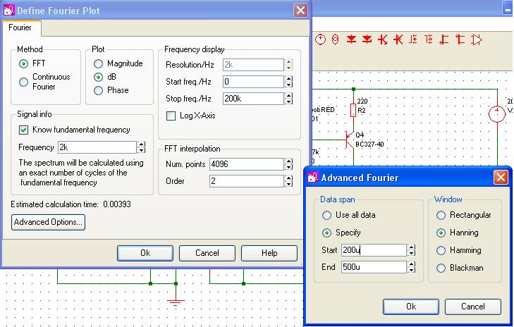

I have a question about the coupling caps. If I do the math, I only need about 4.7uF, but the Fourier analyzer gives much higher distortion if I use those values and the distortion goes down if I increase them to something large. I'm picking parts now and I was wondering if I'm supposed to believe the Fourier analyzer or not when it comes to this.
So with 32V supply rails, that means there's only 0.78V between the base and emitter of T3? For a Darlington? Tina must be pretending MPSA27 is just a normal single transistor. Spice models are often bad, but that's ridiculous.across LED3: 1.56V

Small caps are fine, that's just a problem with the simulation.I have a question about the coupling caps....

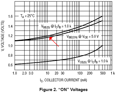

The datasheet for the MPSA27 I think shows this is fine.

OK, thanks on the caps. I'm trying to fit them on the board.

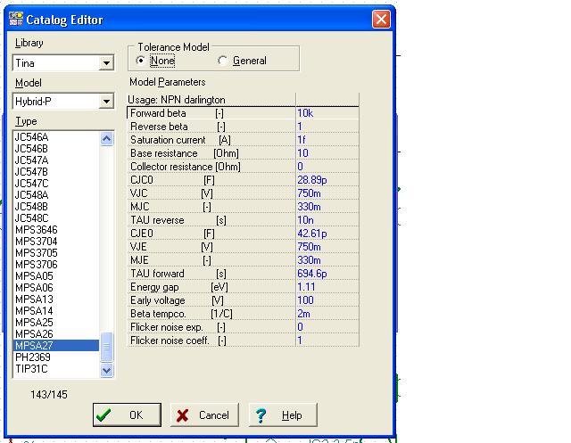

I don't understand the parameters either, but it seems to be using the same model for MPSA27 as for e.g. TIP31C and MPS3704, which are ordinary single transistors, so nevermind the parameter values, it looks like it's not even using the right model.Here's the data on the MPSA27 used in Tina. All I know is that the forward beta of 10,000 is correct. I don't know enough to determine if the other parameters are accurate.
First pic below is from the MPSA27 datasheet, indicating Vbe should be nearly 1.2V, not 0.78V.

That makes no sense. You could leave the caps out altogether in the sim, so there's one less excuse. Increasing the delay might help too, maybe to 100mS, i.e. a few periods of the waveform at 20Hz.Does anyone know why the distortion would go up at low frequencies in this circuit? I can't for the life of me figure that out. I even increased the coupling caps to 10mF! The distortion is at least 10 times greater at 20Hz than it is at 1kHz in this circuit.

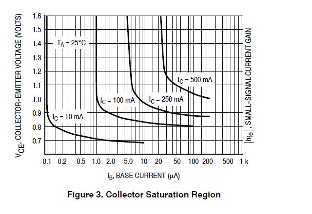

The graph you posted shows the collector-emitter voltage when the transistor is saturated. When that happens the collector voltage is lower than the base voltage, so even when the collector-emitter voltage is below 0.7V, the base-emitter voltage will be above 1V. Actually the base-emitter voltage will be a bit higher than when the transistor's not saturated.It seems to me that this transistor is saturated. Vce is about 29V, Ic is about 12.5mA. But, I'm not good at looking at curves.
All that's academic though. In your circuit none of the transistors get anywhere near saturation.
I looked at the models of the BC560C in Tina and in SIMetrix and they are different. I mean the values are different. They are in the same ball park, but I don't know if that's good. I couldn't find the model of the MPSA27 in SIMetrix. I like the interface of Tina better than SIMetrix, but I suppose I can get used to it.
If this simulator is really far off the mark, then I've just wasted a week of experimenting. I'm not happy.
