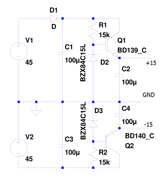

Sorry for another stupid question.
Can I use psu like bellow (sorry for D1) ?
Or better of is to load zener diode with some current and take the voltage from it ?
|Thanks
Yes, this is serial regulator and you can use it it's also capatience multiplier if you connect cap in parallel with zener. This regulator is better than only zener.

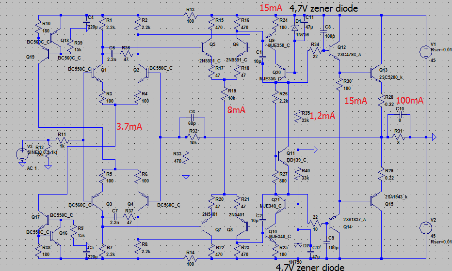

I have ordered some zeners. Next week I will try it.
But for now what we have is:
- I have changed feedback node for 10k/470R + 100pF cap
- increased vas emiter resistors to 47R to keep DC parameters more stable
- I think that vas compensation caps can be removed with similar config, te amp is bit slower (around 35V/us) but is rock stable with capactive load.
The overshoot is gone, I found that close to clipp square is a bit not symetric, I found that behavior with mje340/350 VAS pair in different amp too, after replacing them with eg toshiba driver tranies - all perfect (I will test that later on)
Now the amp is playing some acoustics alchemy on my founteks fr89ex and must say that top and middle frequences are extrodinary good. I do not know if this is good complain but looks like there is too much details in sound (some like some may not like)

Can you post your prototype schematic with this measurement?
It will change nothing if the voltage across the VAS emitters
resistance is not increased as well , you ll still have the same
delta with temperature variation , the thing is to increase this
voltage such that the VAS VBE variation ,2mV/°C , is rendered
less influencial.
As an axemple , if VAS emitter voltage is 0.2V the variation
will be 1%/°C , raise this voltage to let say 0.6V and variation
will be reduced by a 3 factor , wich will reduce accordingly
the VAS current variation.
This can be done either with slightly higher input stage current
or by increasing the input stage collectors resistances , or
a combination of both.
wahab

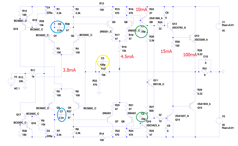

Bellow the schematic of measured amp.
It is bit overcompensated, the yellow cap can be bit lower (68pF), the green caps can be 22pF (i think),blue caps - looks like that they have to remain the same.

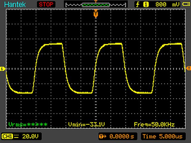

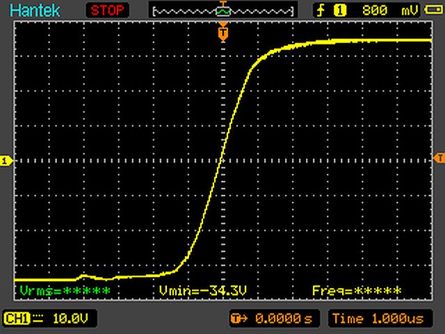

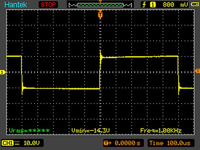

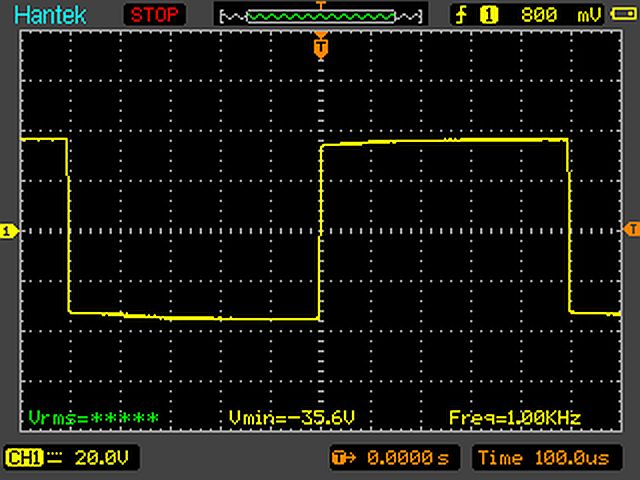

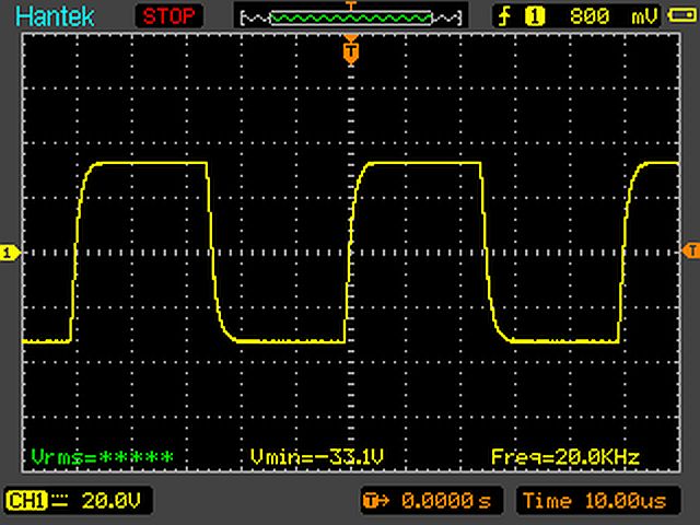

Something seems not quite right with the pics, or the test, or the output load used for the test.... The overshoot is gone, I found that close to clipp square is a bit not symetric...
At 1 KHz in the 3rd pic, also labeled 10V/division, reading -14V.3 min, there is visible overshoot about 4V, with some ringing (probably would be more visible on expanded time scale, or if the freqency is increased to 10KHz from 1 KHz). 4V overshoot on a 10V signal peak (if real and not an artifact of the test), is a lot.
That suggests that (depending on speakers) higher audio frequencies would sound brittle at low-medium volume.
Then, last pic, at 20V/division, reading -35.6V min, no overshoot, but square wave shows signs of power supply being loaded, or some capacitance in the circuit becoming dominant. In other words, something is different.
You would expect your better behavior at the lower pk-to-pk voltage. 14V pk corresponds to about 12W power into 8 ohm load. A more realistic listening level than 35V pk (75W).
Perhaps I am not reading the pics correctly?
PMI
The 1kHz with overshot is 8R + 0,47uF in parallel, no inductor on the end of the amp.
With resistive load there is no overshoot at all, at all amplitudes square is clean.
The last pic is the 1kHz with 8R only, there is visible small disproportion in hight of square but this is my generator at lower frequencies is giving signal like that.

Ok, I get the issue w. the signal generator, but the rest seems wrong, somehow, I just don't know enough to guess at a reason. I've been lurking here, and reading, and your work looks great.PMI
I am guessing the test is being affected by something else.
Here is a test I ran recently, with very old test equipment....
50KHz square wave, 7.5R||0.2uF load
Second pic, 20V pk-to-pk, no Zobel, and no inductor on the output.
My slew rate measures higher, but at 1KHz, that will make no difference.
If the overshoot is an artifact of something else, and you are adjusting component values based on that result, you may be fixing a problem that does not exist...
The vssa amp is a lot faster amp and behaves really ok, but I was getting with it overshoot too with 0.47uF in parallel with resistor (even bigger overshoot, config -->renesas latfets + 22pf in drivers).

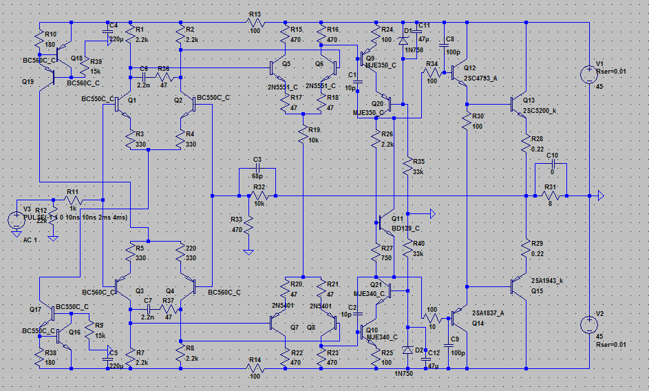

I didnt tryed other tranies there, I have a big bucket of mje with hfe around 200, so I decided to use them. I know that they are not perfect but first prototype is playing suprisingly good. Prapobly for voltages not over 45-50V BD139/140 pair would be good but there is a lot of better parts for this place.
I have incerased emiter resistors in first stage and amp is stable.

Use BC550/560 instead MJE340/350 for Q9/10
