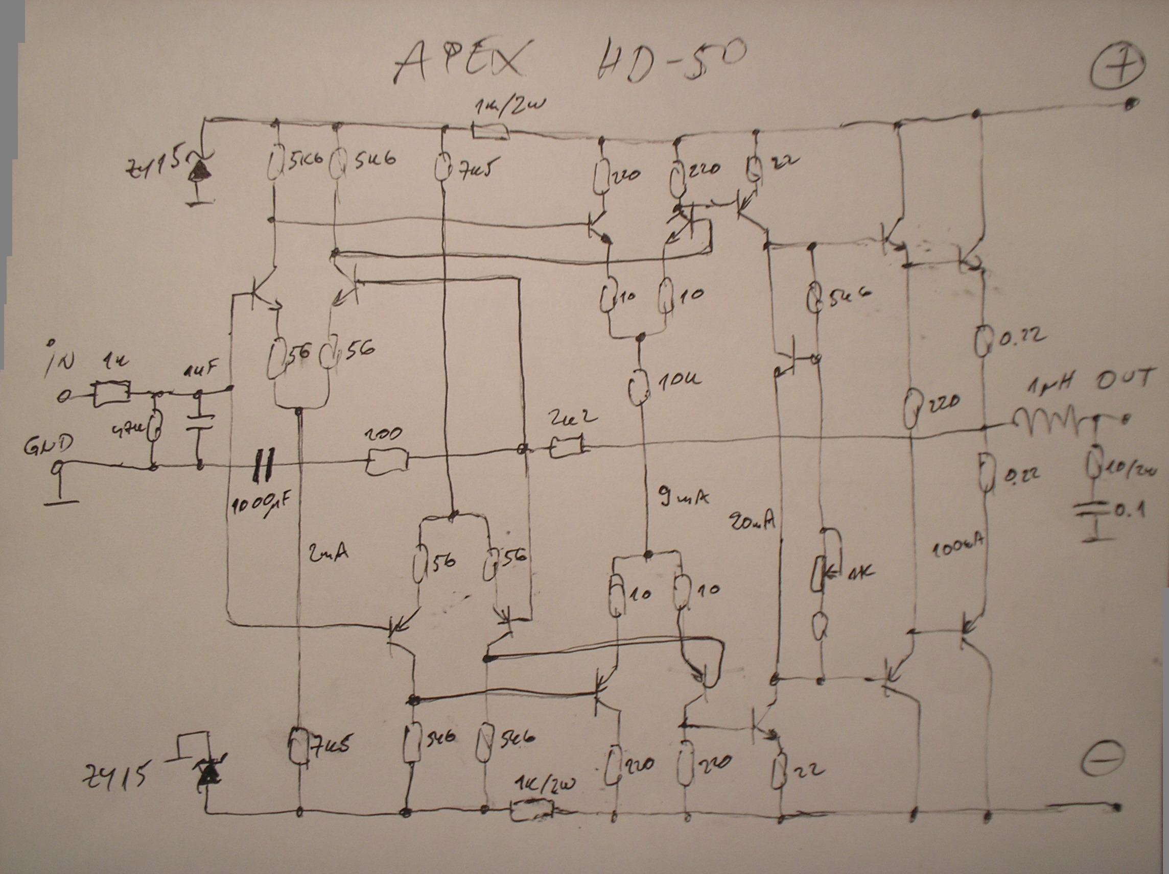

Diamond Differential Amplifier
Idea for full symmetrical amplifier...

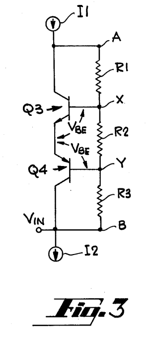

The "bias spreader" circuit is not fully symmetrical. I have attached a figure from US Patent 3,995,228, issued 30 Nov 1976 to Nelson S. Pass of Threshold Corporation. It shows a bias spreader circuit which IS fully symmetrical.

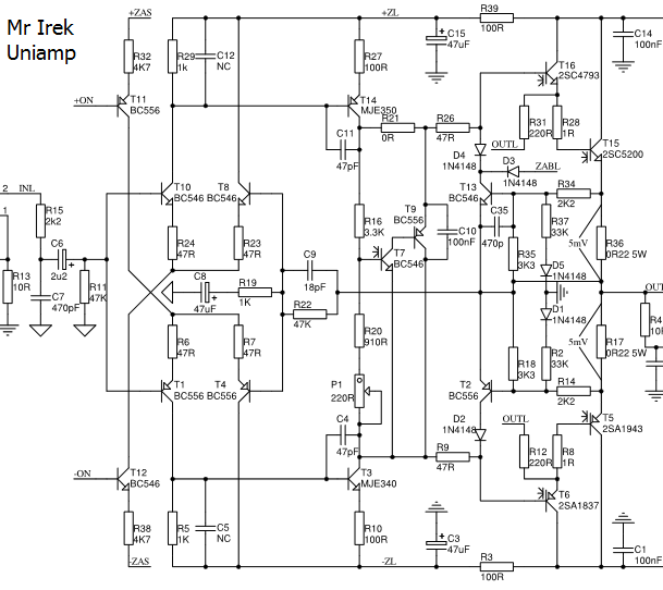

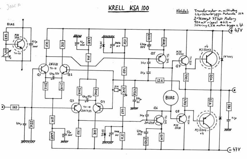

Maybe You can use similar topology as krell ksa 100.
Few examples bellow + diamond amp I have made recently.
For two first stages maybe it would be handy to use ccs instad of zeners supplies ?

One question, why 4 differential amps ? Two amps (as ksa100) + predriver+vas+driver+output stage should be good too.
KSA100 is simple symmetrical amplifier, it's slow with high THD, I want made low TIM amp with high SR... Input stage in HD50 work with +/-15V rail I add another gain stage (diamond differential) with gain 20X to drive VAS...
Why your diamond amp use current divider instead multiplier in VAS?

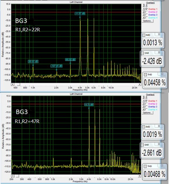

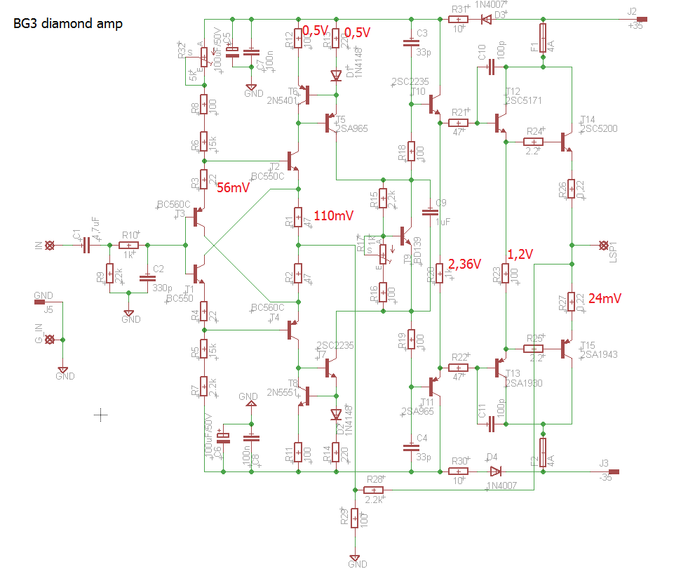

I just was wondering if there is anythink special in diamond topology, diamond buffers are all over the net, so I just added 2 current sources and tef stage into it and it worked just fine and is simple. The results are there SR around 60u/us and thd nearly not mesurable:
http://www.diyaudio.com/forums/solid-state/240848-bg3-diamond-amp-simple.html
I was thinking how to improve the input stage but I have lack of knowlage and ideas.
Your amp is very interesting, buffored front stage is really good idea (I will defenetley build it).
There is one think that I do not know how to explain, I did listening tests of 2 nearly same circuits (one has toshibas TO92-mod second has 2n5xx1 tranies), there was audiable diffrence heard strigt away in bass area, the one with 2n5xx1 was bit deeper and more soft.
Another think - I just had changed 2 resistors in second diamond stage (reducing biasing by 50%) and harmonics character has changed totally - I do not know if this is specyfic case of my circuit or kind of diamond topology characteristics. It looks like that there is a way to fine tune the amp with listening test.
In your amp prapobly there will be a way too to fine tune the amp with listening sessions. I would put j-fets at input buffer anyway.

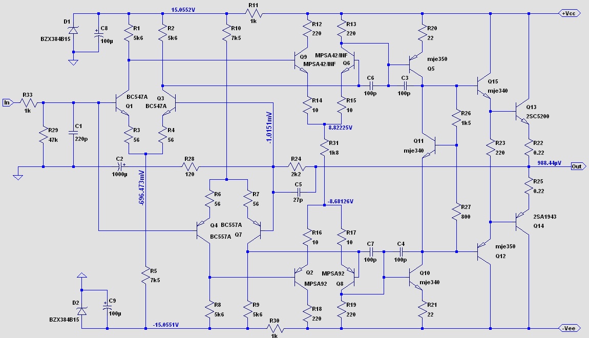

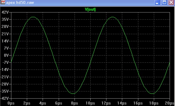

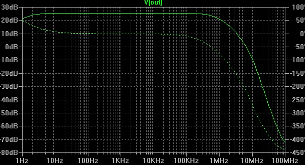

I tried the schematic on ltspice.
I replaced R10K with 1K8 & added some capacitors for amp stability.
