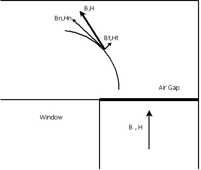

On second place, let's consider boundary conditions for B and H
(B₂ - B₁) n = 0
(H₂ - H₁) x n = 0
Let's perfectly clear, that the goal of this thread is to analyze our beloved transformers, so, pathological cases as that of your second graph will be avoided, after all we need them to listen music, not to magnetize all our neighborhood.
Furthermore, the scale of your picture, tells us that it is an EI375 core, i.e. 1.375" x 0.938" or about 35mm x 24mm, an air gap of 0.003"≈0.076mm looks reasonable, but an air gap of 0.053"≈1.35mm, seems insane for that core. What do you think?
With this proviso, and in order to design reasonably good transformers, we must achieve a negligible fringing flux, respect to the total flux, i.e. use as small as possible air gap.
Then, boundary conditions on the air gap, tell us that B remains unchanged in the air gap, because it is perpendicular to the air gap.
attachment.php
Changes on B, outside of the air gap, are due that B must pass through magnetic domains, and its tangential component changes, it is an effect due to core geometry/material, not due to the air gap!!!

Just in case, let me clarify that drawings are merely illustrative, and them try to explain the issue on areas where the field B tends to reduce due to unfavorable alignement of magnetic domains.

When you use common language to describe a physical fact, you must be very careful with words.
Note that I did say (sic.) most magnetic domains become "pre aligned", because the material is magnetized by the external field Hdc.
If I had said "all magnetic domains become pre aligned in the same direction", would be close to description of saturation.
So, the field B graphed on Fig.5.(d) is quite homogeneous, if it were perfectly homogeneous would be all green!!!
That is not the case! The gap helps but it won't make it perfect.
I already said it on post#362, and I will repeat one more time
I was simply saying try to imagine what happens in fig. 5d when you increase Bac. It will start to get similar to the previous 5c (i.e. you will get saturated areas when most of the core is still fine). I say similar not identical!
In Fig.5.(d) when you increase Bac, you will obtain something similar to Fig.5.(c), if you increase even more Bac, you will obtain something similar to Fig.5.(b), if you increase even more Bac, you will obtain something similar to Fig.5.(a)
