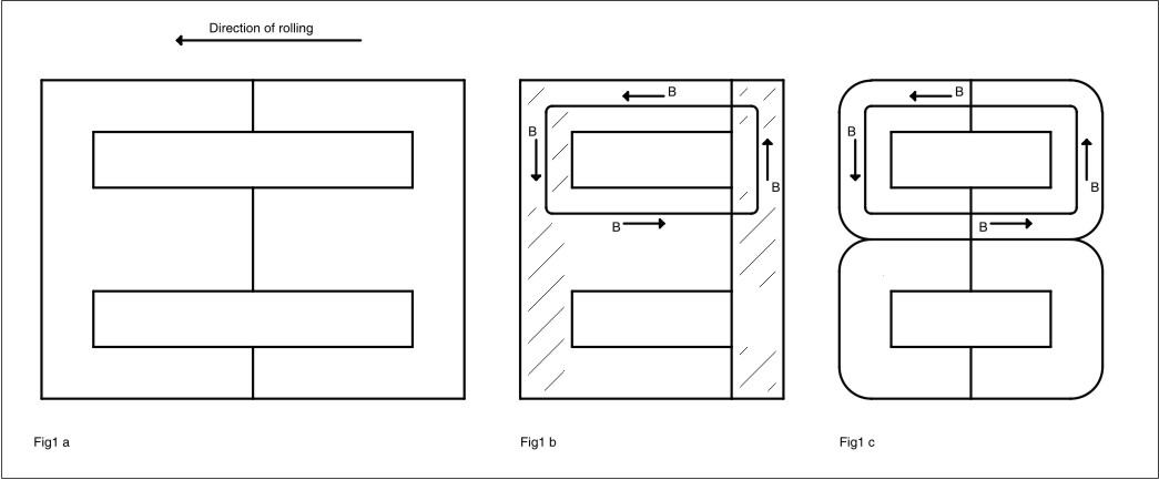

Tip#13 C vs EI
Let's consider now the most common shapes for transformer cores, we suppose GOSS lamination.
On Fig 1 a, we can see the waste-less pattern for most commercial EI lamination, as a consequence of magnetic domains orientation are mostly coincident with the direction of rolling, on Fig1 b it can be seen the issue with an applied field B.
Clearly it can be seen that over shaded area, the direction of B is not perfectly coincident with the direction of magnetic domains, and over more unfavored zone both directions are perpendicular.
As consequence, the work made by magnetic fields is incremented in those areas, so hysteresis loss is also increased.
Even on NOSS, when applied field B is deviated from the direction of rolling i.e. from 0º to 90º, increases Barkhausen noise.
On a C core, the direction of field B is mostly coincident with the direction of rolling, and then with the orientation of magnetic domains, consequently can be minimized both, hysteresis losses and Barkhausen noise.

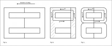

I already mentioned that with C cores, can be used ridiculously thin lamination, and eddy current losses can be also reduced.

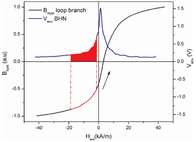

Tip#14 Zero Crossing
Maybe is a truism, but surprisingly, higher movability of magnetic domains it produces when field B has a zero crossing, B=0 on magnetic hysteresis curve, i.e. vector B changes its sense of direction.
On that case, Barkhausen noise, BHN, reaches its maximum, and achilles heel of SE OPTs becomes on its major advantage, because due to static field Bdc, Bac hysteresis loop will avoid zero crossing.

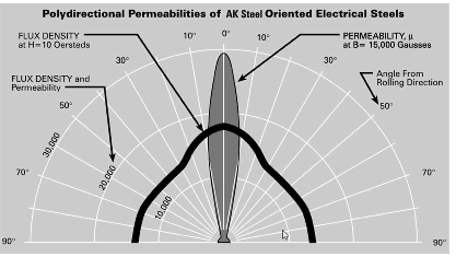

Manufacturers' datasheet refer to laminations sheets in the rolling direction not to EI cores, unless specified. Then there are treatments and tolerances when EI cores are made. They often refer to AST A-346 protocol which was dismissed 20 years ago for good reasons! One reason that came out recently? People demonstrated later that the average path length of that set-up needs to corrected for induction above 1T and so measurements are not so accurate as one might think. The higher the induction the stronger the correction.
But....there is more. In EI cores the flux lines are basically along the rolling direction for about 2/3 of the path only, in the best case. Have you ever seen how permeability changes (decreases, to be precise) in any direction not parallel to the rolling one? Which is the worst direction?
Have you seen what the fringing flux does?
Can the induction be considered approx. uniform when B is no more moderate?
There will be areas where it will be poor and also areas where it will be quite higher, up to 40-50%, than average (Hint: inner corners, especially around the gap). When B is moderate these are just small hot spots at high induction. When B is high they will grow up in volume and saturation will take place even if most of the core is at safe levels! This explains why you can't assume mu AC constant up to saturation on the basis of design values. The design value for B in the basic equations does not reflect this.
