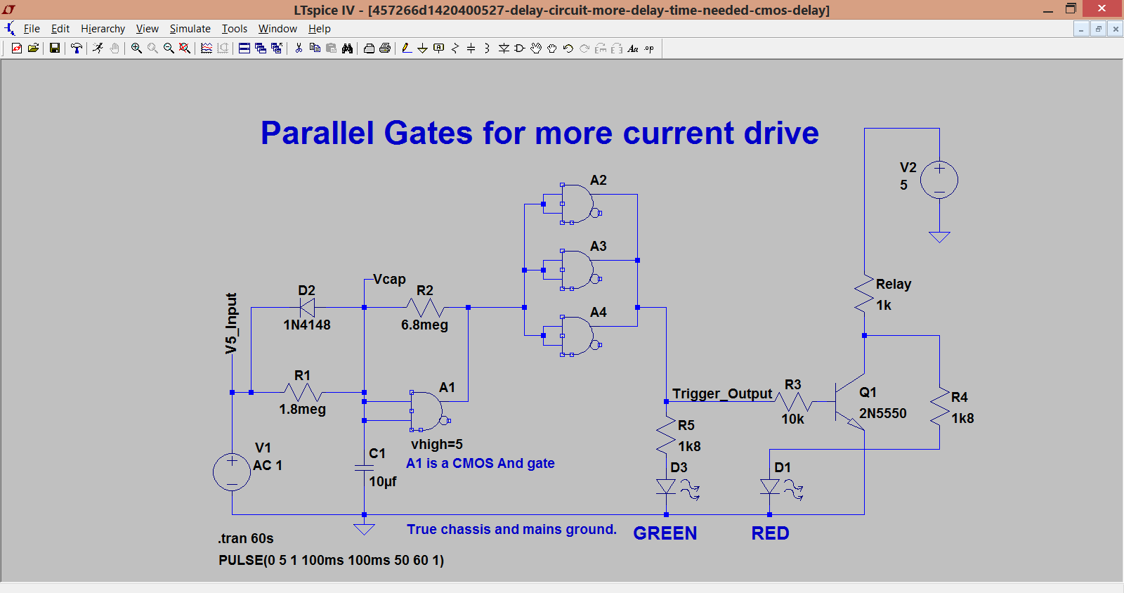

Here are the two circuits you need for the LED depending which type it is. The third diagram shows how to parallel the unused gates to use as a buffer to get more current drive. I would recommend that if driving LED's as well.
The output voltage from a single gate will fall under load, that's normal. Paralleling the gates will help stop that. Alter the LED resistors to get the brightness you want.

Hello Mooly,
Thanks, really learning a lot with these schemes. Needed some time to figure out the common anode version, but I understand that you are using the 0 of the AND trigger as GND for the Red Led.
I tested my led and it is a common cathode version.
In the meanwhile I also drew a scheme (Just PowerPoint…:D). I have attached it. I used in my version a separate relay to switch between green and red. One trigger is send to the existing relay on the separate board (in the dotted area) and the same trigger to the additional “LED relay”. Updated it with the high current version of the AND gate.

In the common anode version the red LED lights when the output of the AND gate is at logic zero. The gate sinks the LED current. The green LED is simply across the relay coil. When that is active the green LED lights.
The common cathode is similar but upside down and back to front. Now the red for off LED draws its tiny current through the relay coil (the current is so small it won't pull the relay in). When the relay is on the voltage across the transistor is essentially zero and so the red LED then goes out. The green LED does the opposite and is fed from the gate output.
Your circuit is a little scary :eek:
The input trigger signal doesn't correspond to the relay drive on a time scale... the whole point of the delay circuit... and so using that to light one of the LED's would be out of step with the relay. Also the trigger signal disappears when off and so the other LED wouldn't light because its 5 volts would have disappeared :)
Administrator
Joined 2007
Just looking at your circuit again... of course your driving the transistor from the delay output... so just the problem of you using the input trigger as the 5 volt supply for the transistor collector. And no LED limiting resistors... don't blow your LED up when you get it. Solder the limiting resistors to it first to save accidents.

Using a relay to drive the LED's is very messy and wasteful tbh. The voltage source V1 is now the supply with no separate trigger input.
If you replace the And gate with a Nand type (such as a 4011, its similar but it inverts) then you can run the LED's from the delay circuit directly.
