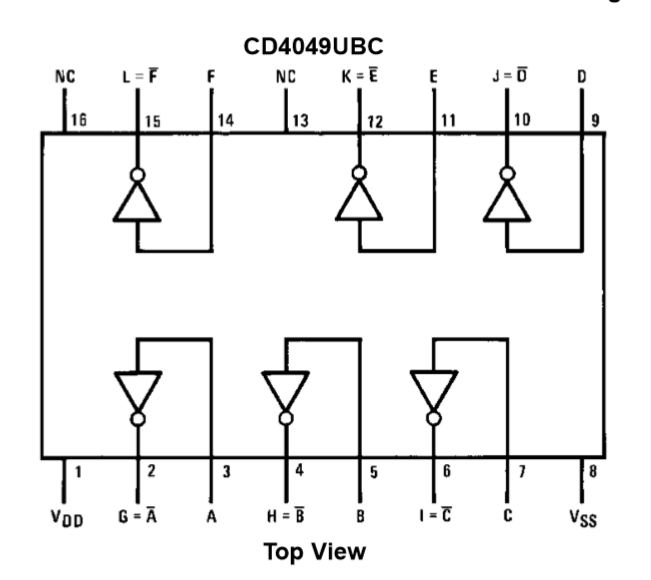

If you need more current then we could replace the NAND gates (which are all used as invertors) with a 4049 HEX invertor. That has 6 invertors of "high current ability". The word "high" is relative but it is high for CMOS. Each invertor would be used in place of one NAND gate. You then have another option (if needed) of paralleling invertors to drive the LED's as there are six in the package.
Note the positive supply is on pin 1 for this IC. Don't leave any unused inputs floating.

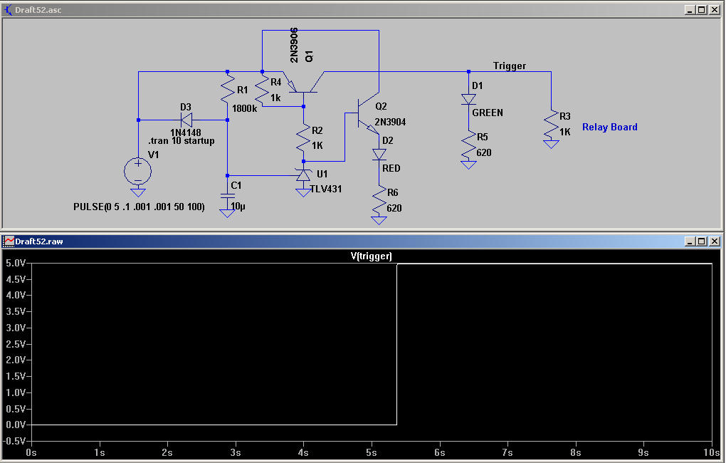

Delay a little over 5 seconds with status LED's and fewer parts.
You've come up with a totally different approach to anything so far...
One thing I would say... and I'm sticking with the CMOS over this... is that you have to look at how the circuit behaves during the transitions. I like to see a 'clean' change in logic level. The opamp solution of CC requires low voltage rail to rail devices and the circuit doesn't seem to have any hysteresis mechanism.
I suspect the same 'clean switching' issue may happen with the discrete version too as the devices slowly come into conduction (but I see you simulate a clean transision ). It all depends on the ultimate goals of the design.

Of course you have to be careful with your choice of opamps too, but most members deal with them a lot and have them on hand, while still regarding a 555 as outré.
Obviously there are a whole range of options available if we are concerned with how clean the transitions are, starting with using comparators instead of opamps, but this is hardly a demanding application.
