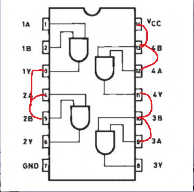

The easy way to tie the inputs high or low. Tagging them on to the gate in use has no effect on its operation.

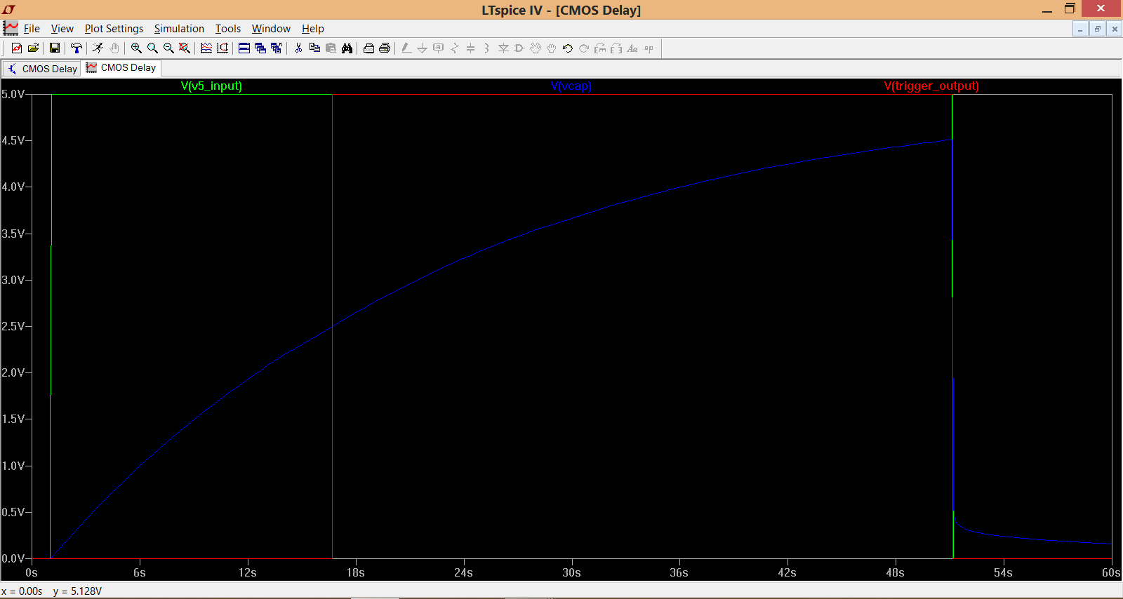

A 47uf cap and the 470k should be about right.
This shows the 5 volts appearing for around 50 seconds (green trace). The blue is the charging curve of the cap and the red the trigger output. The great thing with CMOS is that you can use really high values of resistors and small caps. You could even use something like a 2.2meg and 10uf cap and a 10meg feedback resistor across the gate.

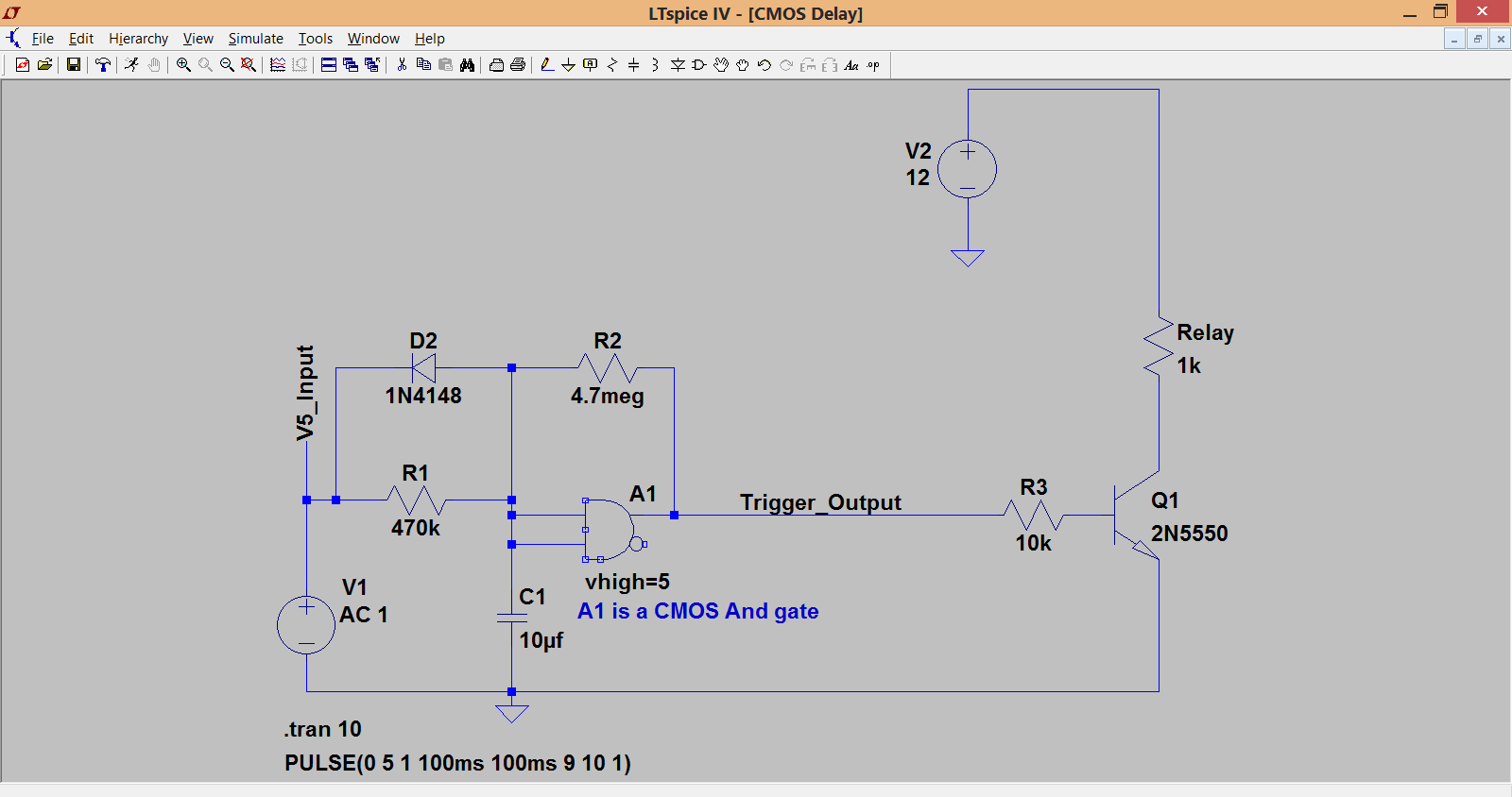

If I’m not mistaken then the circuit does not differ very much from the one Elvee has drawn. But this one has the benefit of a clear switching pulse.
Terrific that you can calculate the values of R1 and C1 and then simulate the pulse. I would however need 15 seconds. The 50 seconds is not needed. Can you find values that would fit this time?

The exact values of R+C will vary a little from a simulation to real device but it should be pretty close. A 1.8 meg + 10uf cap and a 6.8 meg feedback resistor are around 15seconds.
(The 50 seconds above was just the length of the "on time" I used for the simulation)
I have attached the LTSpice file in case you (or anyone else) wants a play :D Just click my signature for a guide on how to install and use it.

However in the diagram I do not understand the Vcap between D2 and R2.
Would have expected a higher C1 value versus a lower R1 value. Can imagine a very low charging current, but what after 5V is reached and the input is "high" will the IC not use power and then drop off again?

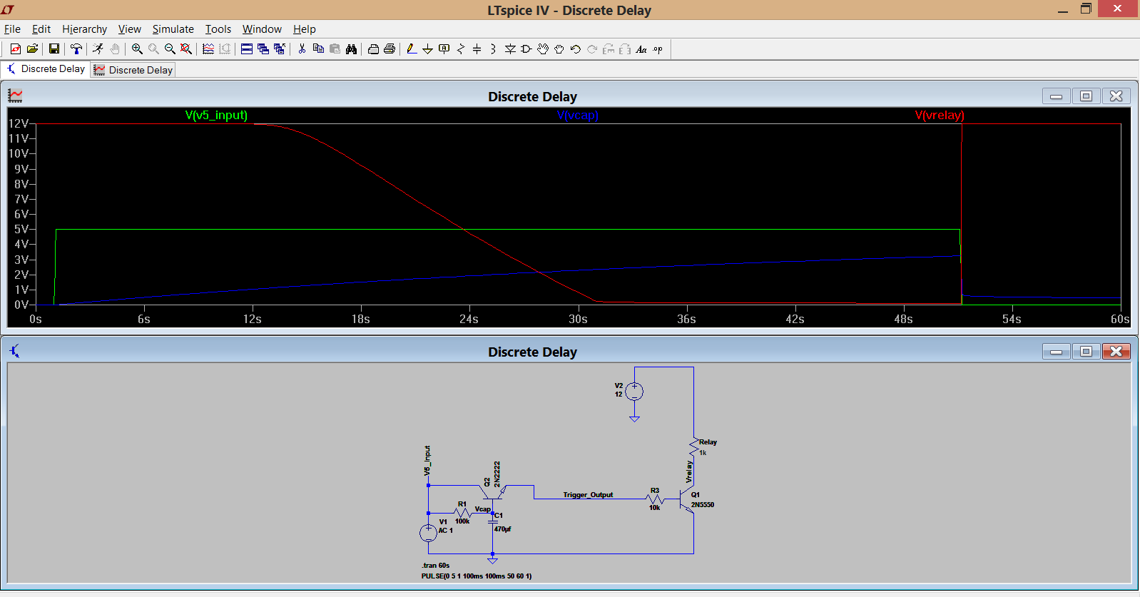

These suggestions are unecessarily complicated. It is pretty clear that the relay board consists of a simple transistor driving the relay (probably common emitter). All Hoihn needs to do it to remove R2 as it serves no purpose, then increase R1 and/or C1 until he gets the required delay time. I suggest 100k for R1 and 470u for C1.
Its, what shall we say, somewhat inelegant. Here is the relay voltage (in red) At what point on the slope might the relay pull in ? Would it pull in cleanly ? or would the contacts move so "slowly and softly" that there could be a moment of a "poor contact".

Vcap is just tag on the diagram to easily identify the scope trace.
That's a really good point you make on the cap although modern electrolytics are pretty good with regard to leakage. Yes you could certainly alter the ratio to give a higher charge current. When 5 volts is reached on the cap the gate output stays high. The CMOS IC draws no current when powered (under 1 microamp). It only needs current to change logic states... and at this single slow speed its zero in the roundest sense of the word.
Preferably I would not make any modifications to the original relay board. There is not much space and SMD… I’m not that confident in soldering yet.
You don't need to modify anything: I have drawn the components on the right for comprehension purposes, and also to make the sim work realistically, but all you have to build is on the left, outside of the dotted box symbolizing your existing board.

All CMOS logic IC's have limited drive ability and so the transistor is needed. The 5ma or so available is more than enough to fully turn on a small device like a BC546 etc. If you are running the circuit on just 5 volts then lower the 10k base resistor to say 1k5.
You only need the one 4.7meg ohm (not 47:)) Its function is to add 'hysteresis' to the switching action of the gate to ensure the output switches ultra fast and cleanly. As the timing cap charges and approaches a voltage that might just start to flip the logic state of the output a problem occurs where the output of the gate can be 'noisy' just for an instant. The resistor stops that by ensuring that as soon as the output goes positive even for a microsecond, the current through the 4.7meg then adds to the charge on the cap and pulls it across that 'indeterminate' level of neither a 0 nor a 1.
