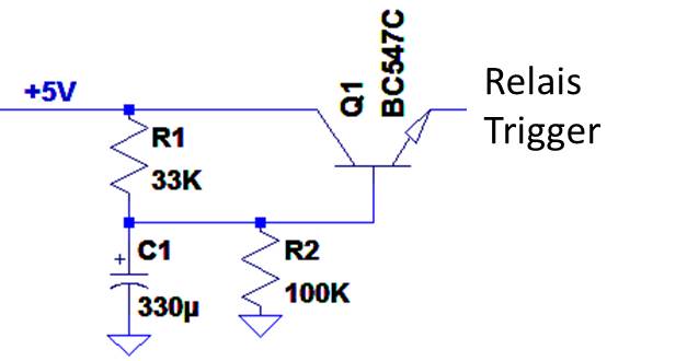

I’m using the small circuit below to delay a relay. The circuit 5V input of the circuit is delayed and then fed as trigger to a relay circuit.
The setup below doesn’t allow enough delay, so I updated the C1 capacitor to 470uF, now I’m only a second or two short of what I need.
The person I got this circuit from indicated that I should not use more than 470uF, I expect this is due the current flowing through the resistor.
Is there an easy way to add the 1-2 seconds delay?

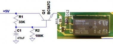

I have attached the circuit below. Including a picture of the Relay part of the circuit board I am attaching the delay to.
Unfortunately I do not have a diagram of the board I’m adding the delay to.
There is a control transistor in smd under diode d12. The 5V trigger is applied to the top side of r13. It is at 0V when the relay is off.
The output of the delay circuit is directly applied to the top of R13.

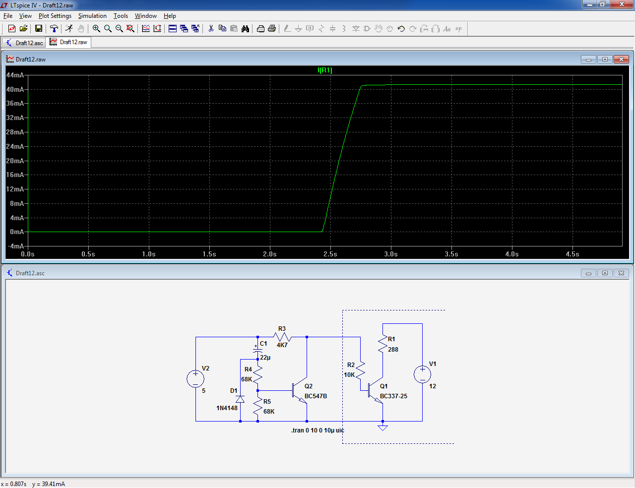

You could... and this is a simple approach... try adding a IN4148 diode in series with that 10k on the relay board. The diode would have to be between the resistor and the base of that transistor (in other words nick the print with a craft knive and add the diode over the break). Then just add a low voltage electroylitic (but it would need to be large for a reasonable delay, say a 2200/6.3 volt)

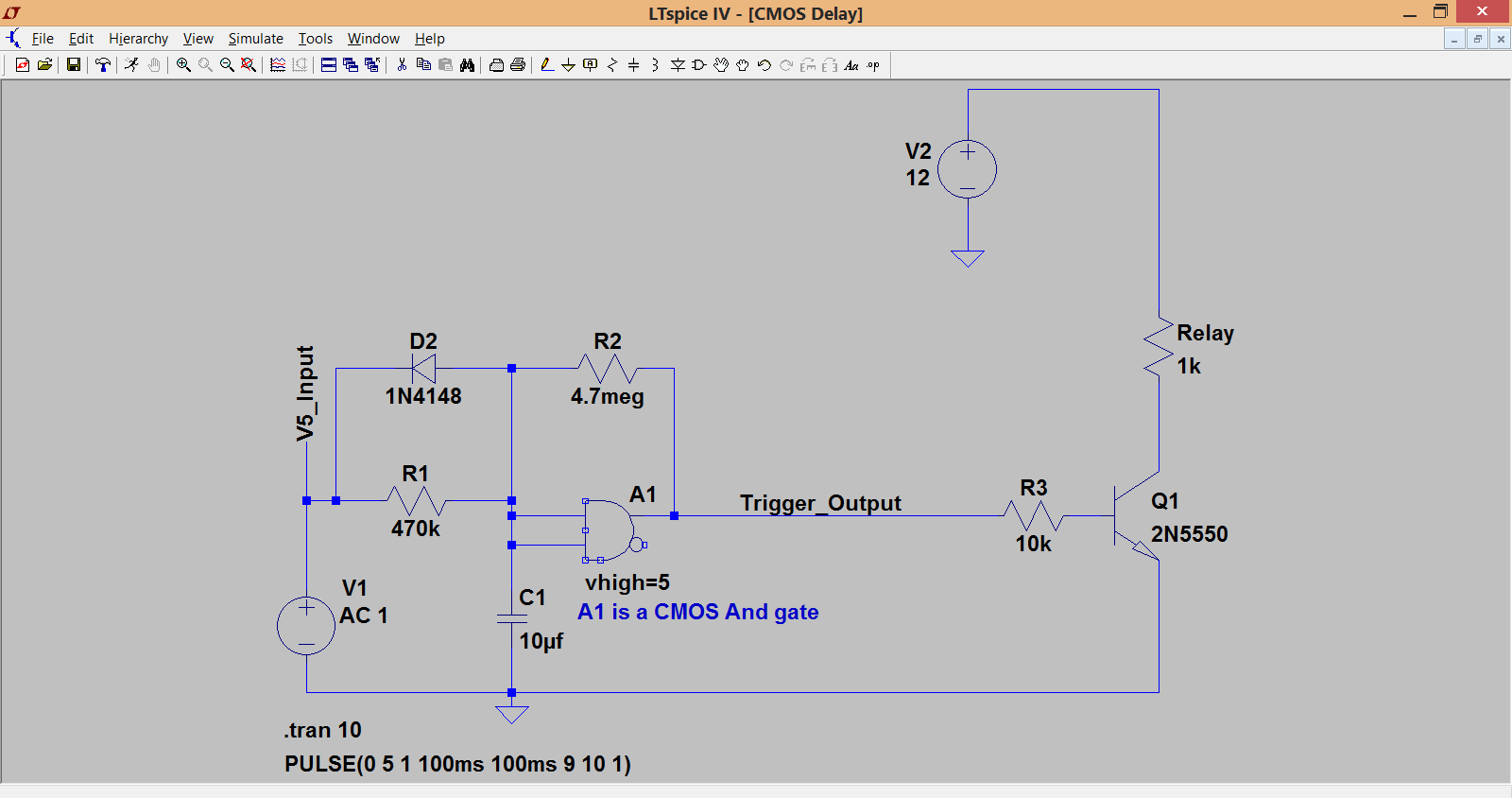

A much cleaner solution to all these, meaning cleaner in getting a sharp trigger pulse, would be to use 1 gate from a CMOS package. Minimal component count and a reliable and clean trigger. The transistor and cap method give a slow rise time and poorly defined relay close action because the voltage switch slowly.
This shows the idea. The transistor and so on is on your PCB. The delay is set by altering the cap + resistor to suit. The diode ensures the circuit is ready to work immediately following a quick on/off sequence. That is something the other circuits will struggle with.

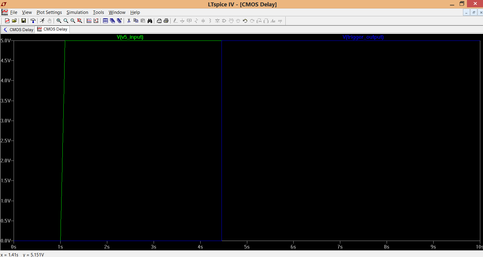

The green trace is the +5 volts appearing and the blue trace the trigger signal which appears some 4 seconds later.

Yes that's it, and you can use any one of the four gates in the package. The other unused inputs should not be floating but all tied either high or low. That is easy to do... just connect the output of one to the inputs of the next and so on in a chain. Or just connect to ground. The outputs are fine floating.
The 4.7meg (not critical) ensure the super clean switching action by adding "hysteresis".
I was actually thinking of the 4000 series of IC's, 4081 I think is the AND gate but the 74HCT should be fine too.
