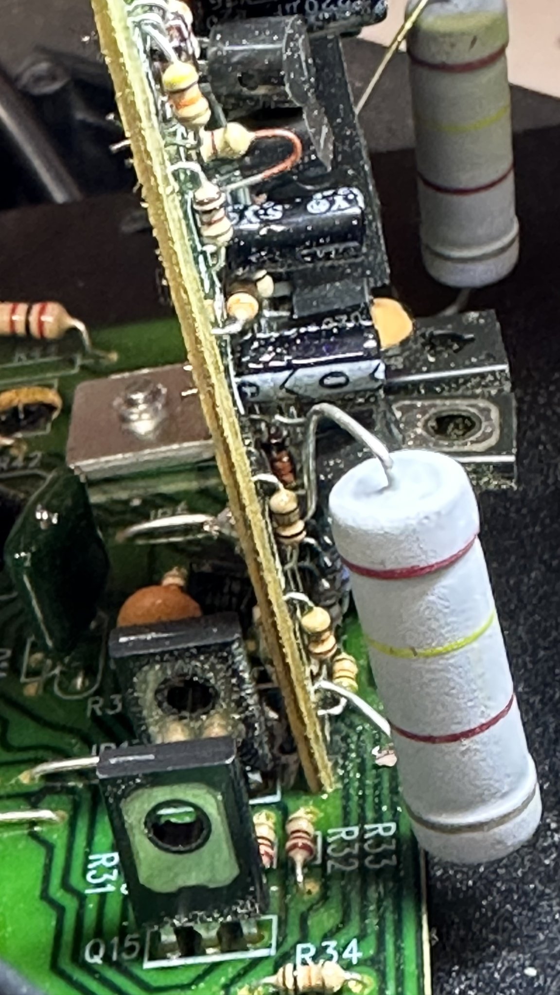

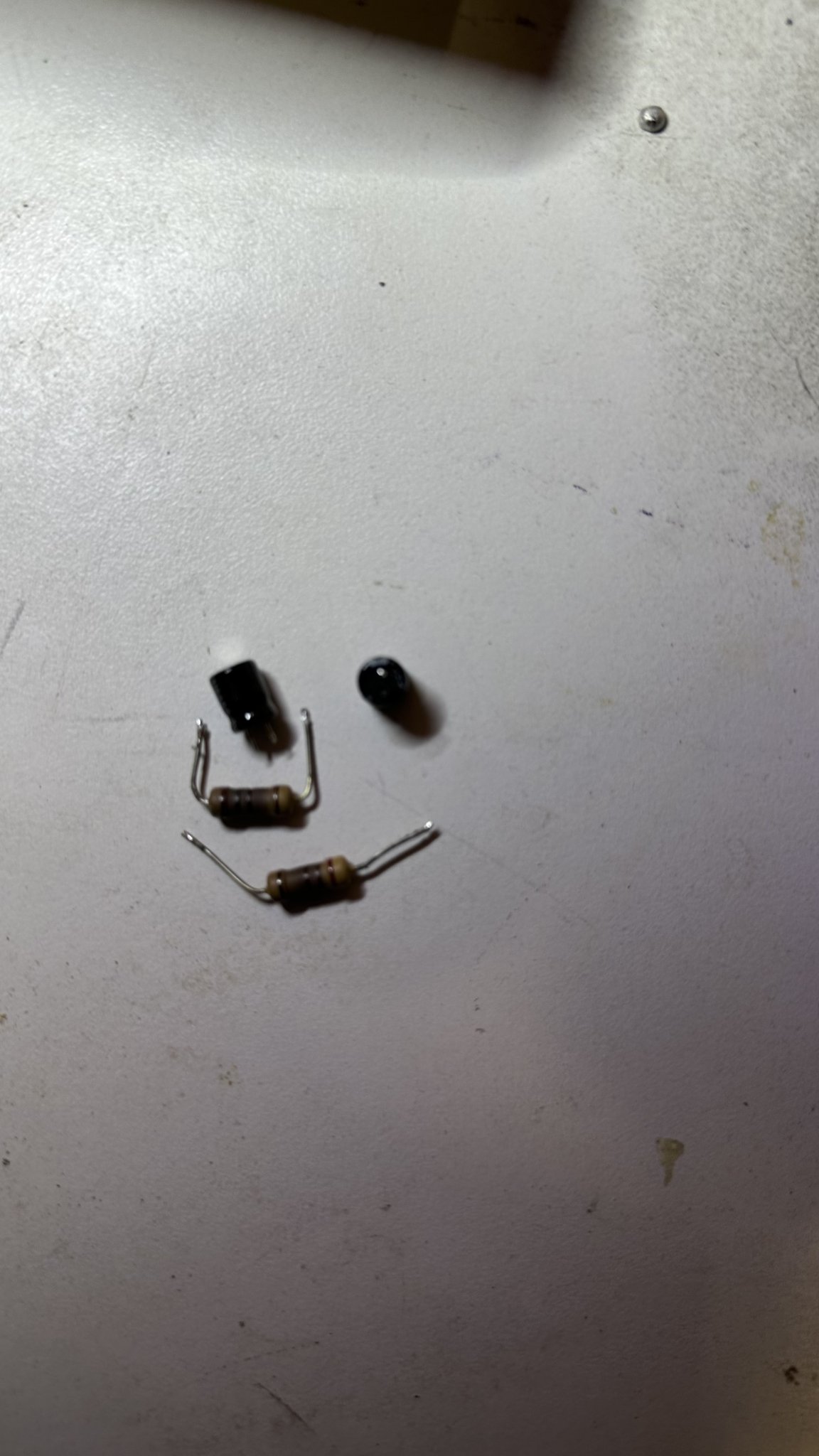

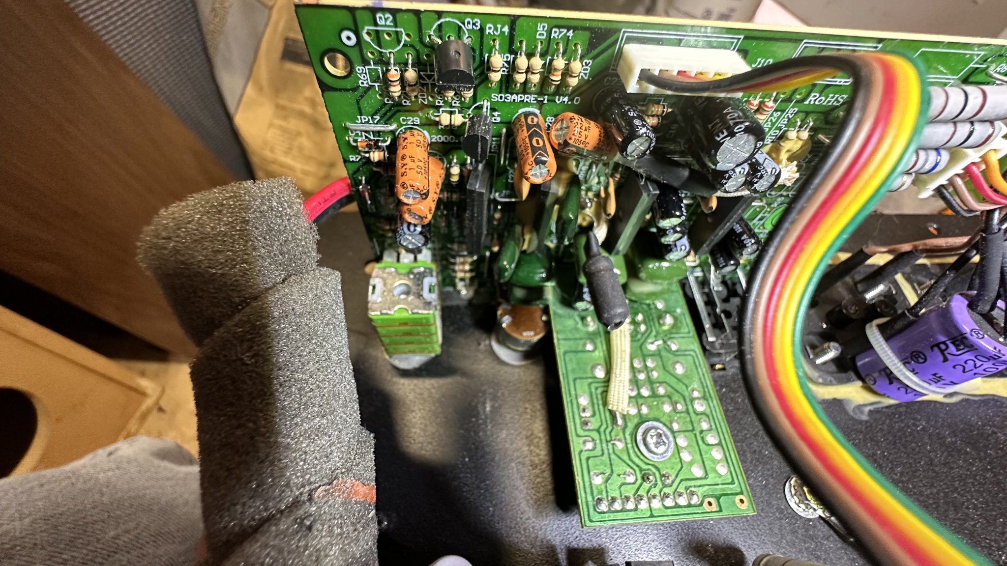

I have an SA240 - low output, crackle and loud pops, and the resistors were getting hot and cooked. I replaced C10 and C11 with higher voltage caps - no change in output. I also changed the cooked resistors to 5w and they haven’t gotten hot yet. I haven’t used the amp long enough to see if the crackles or pops happen still, but if they return I will clean out the switch.

What I noticed from pictures of the burned soft clip PCB: The burn and heat marks show the amp has been operated face down for a long time. Heat goes up, not sideways.
This doesn't matter from a customers standpoint, as the Zener/ resistor regulation is simply a construction fault, made by someone who wanted to save on the proper parts, an extra transistor and capacitor. They knew how critical it was, as they put the resistor on long legs to give better cooling. The usual 7818 and 7918 regulators are not suited for the high rail voltage. Anyway, if the plate amp is operated in the "normal" orientation, they might last longer, until another "no quality" part blows. Like the other capacitor problems, a few centimeter away: An average 105°C 25Volt cap should stand 18V forever, so these must be the worst China had to offer.
For the burning resistors, simply replacing them with more Watt versions may be the wrong way, as the next part to fail is the Zener which is working on it's limit too. Double of the resistance ( 2.4k stock) reduces the dissipated heat and may still serve the opamp. I would try 3.7k Ohm.
How to do such a voltage reduction correctly is shown in the amps PS: A Zener, transistor, resitor and capacitor only burn the current needed. These 35 Cent in parts are too much for a poor company like PE. They seem to earn more money by replacing any 3rd amp they selll with a new one from time to time...

Heat marks were on my amp’s PCB since shortly after I bought it and the crackle started. It has always been operated in the proper position. Of course it gets hot and stays hot here in Arizona, USA.

I have never seen this amp, but it is supposedly similar to the SPA250. Known problems include the resistors for the Zener diodes and the bleeder resistors for the main filter caps. (New Values are 3k0 @ 2W). The caps are notoriously cheap and unreliable. Use a magnifier to carefully check for bulging endcaps. I had a bad one at C8. Good luck and please let us know what you find. Cheers- EVMan

The SPA250 has indeed gone through multiple revisions. I have had three SPA250 units go bad (Zener Resistors, DOA, C8). The first thing to check is mechanical vibration. Can you feel any vibration at all? If you can probe with an orange stick, the whine’s pitch might change when you get close. Hopefully, a visual inspection will reveal the culprit. Good luck. EVMan

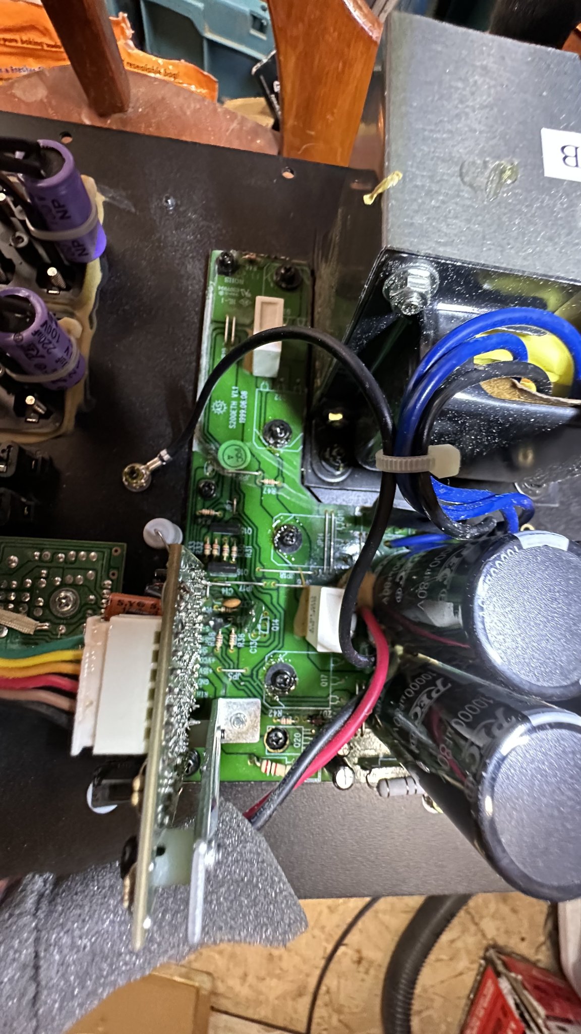

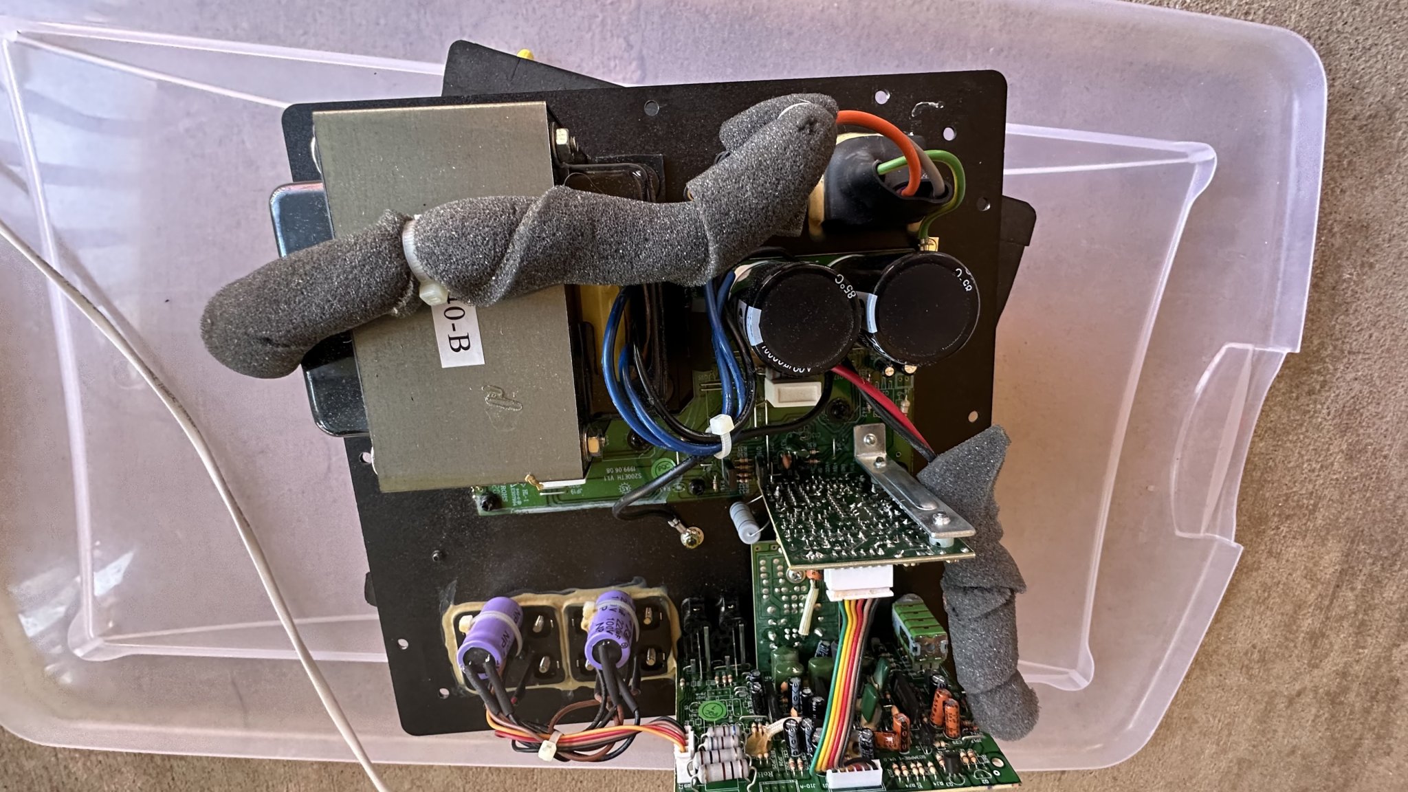

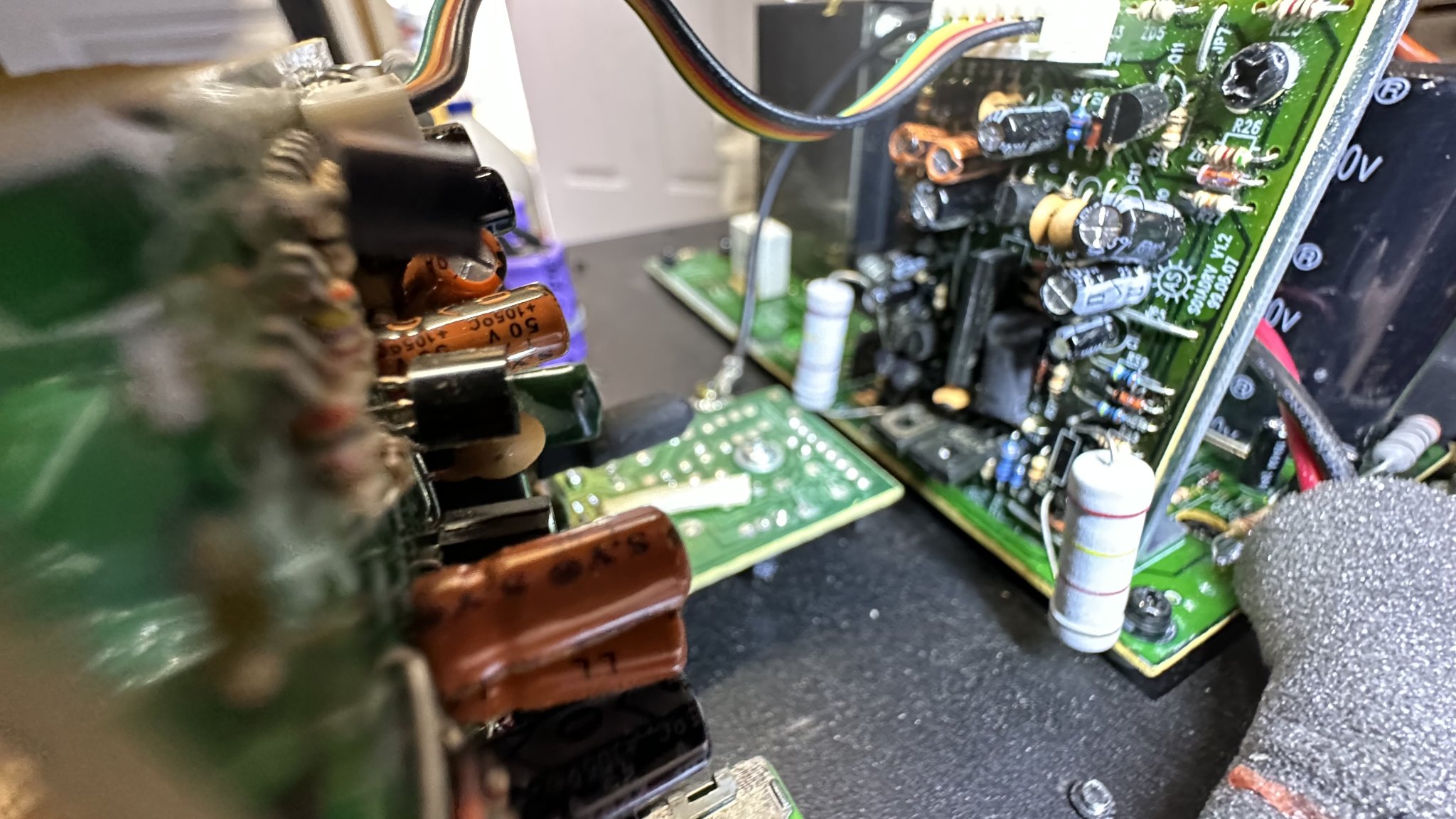

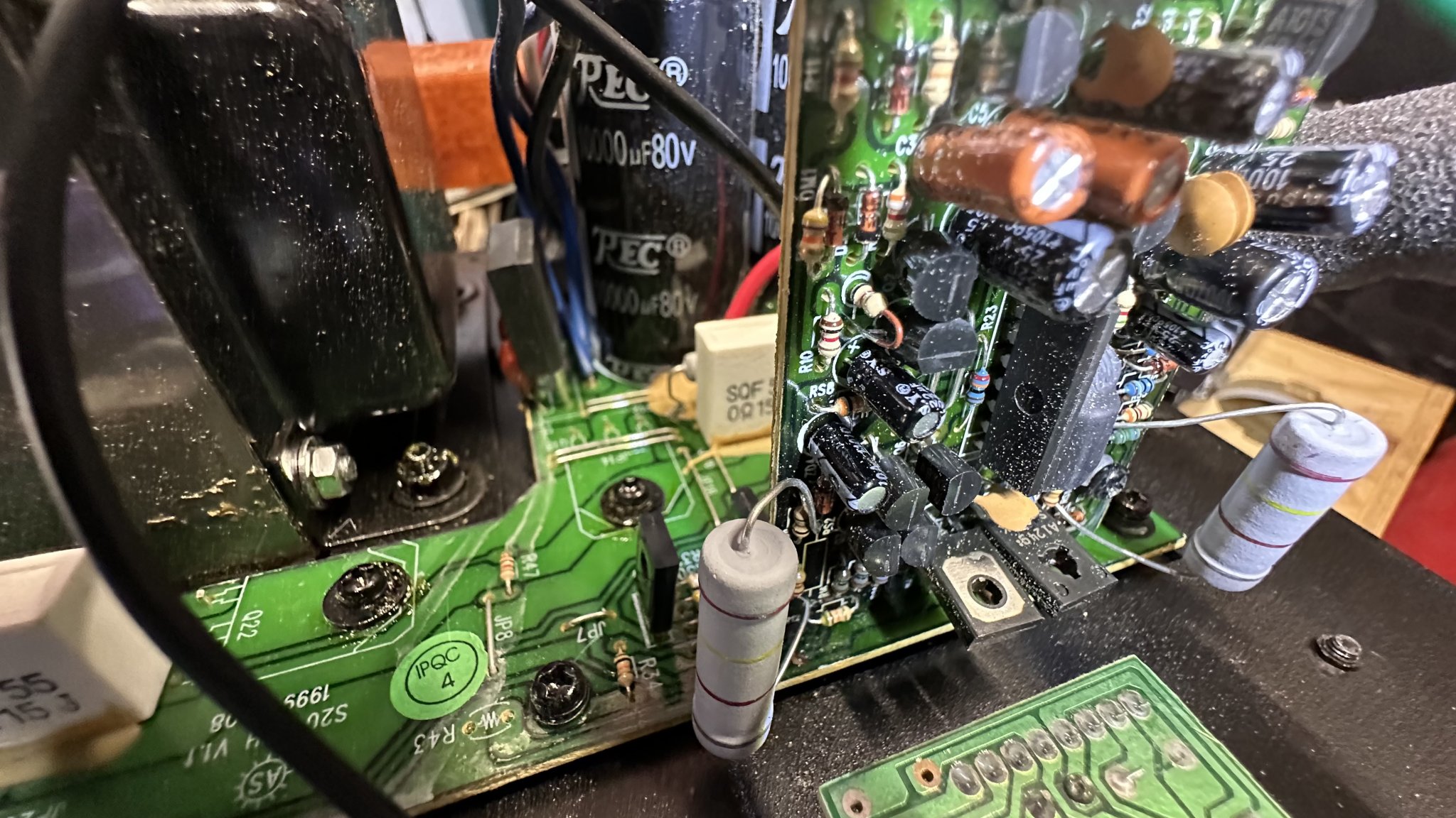

EVMan: Haven’t been able to find a schematic. Here are recent pics of the guts:
