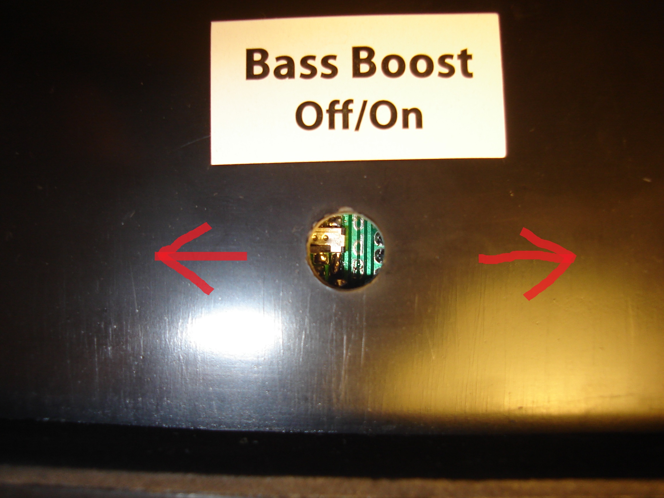

Hello everyone :
I have bought the Dayton SPA250.
I do not want to use bass boot, I wanted to test its operation but applying a small lateral pressure, either left or right, it does not move ......
It seems that it has a lock, you have to lift it first and then move? This would be impossible to realize for that small hole, would have to remove before the plastic shell that protects the whole amplifier.
I enclose my correspondence with Dayton:
Question
" I have the following questions about the bass switch.
1) I have tried to slide the visible part (see photo) gently and does not move. I'm afraid of hurting something if I exert too much pressure. Can you please inform me how is the correct method ?
2) The position of the switch (as I received it from the factory) corresponds to Off or to On ? "
Answer
" It is a little micro switch that is what you typically find on PCB's, so it is not very robust. But it should be set to off all the way to the left. And if you want it on then it slides to the right."
Can you help me, please ? I just need to know if in the position you see in the photo is disabled, then I would leave it like this ....
Thanks since now

See post 43
The problem was that the black sliding knob of the microswitch could not be seen with the naked eye as the hole-peephole was moved from the correct point, the adhesive poster is correct.
And yes, my vision is not the same as it was at 20 years old ...

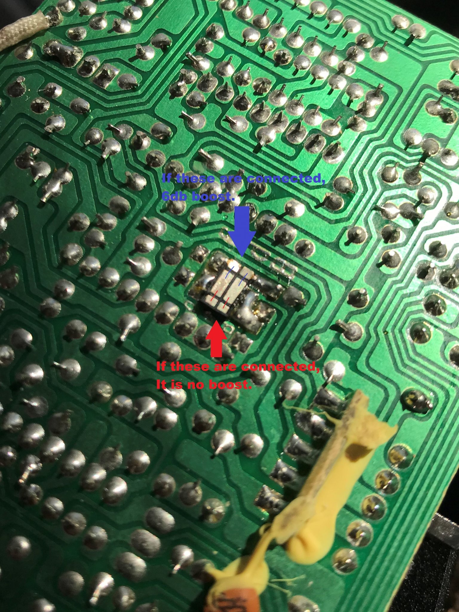

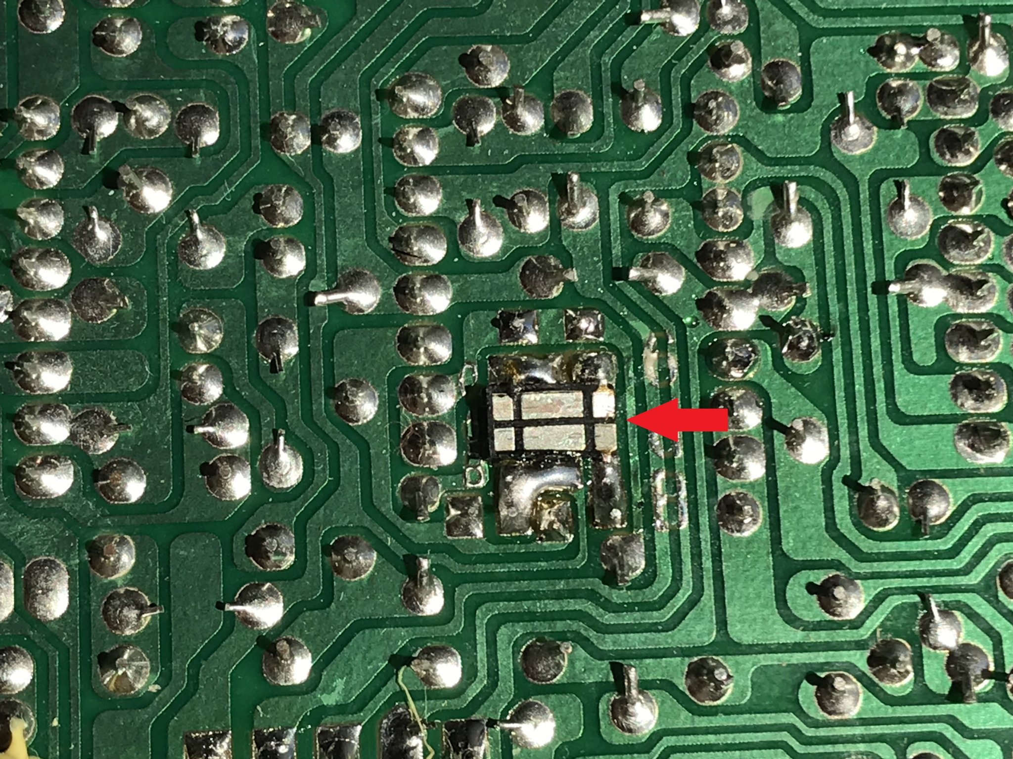

Hello. Reviving an old thread here, but i'm getting so-so results with the mod in this thread; ive replaced the U2 with a 10k resistor and removed the burnt rs1 and rs2, but i need to put the gain at the very max to get sound from the sub. Anything special i can do to fix this, use a different value resistor or something else ? thanks for any input.

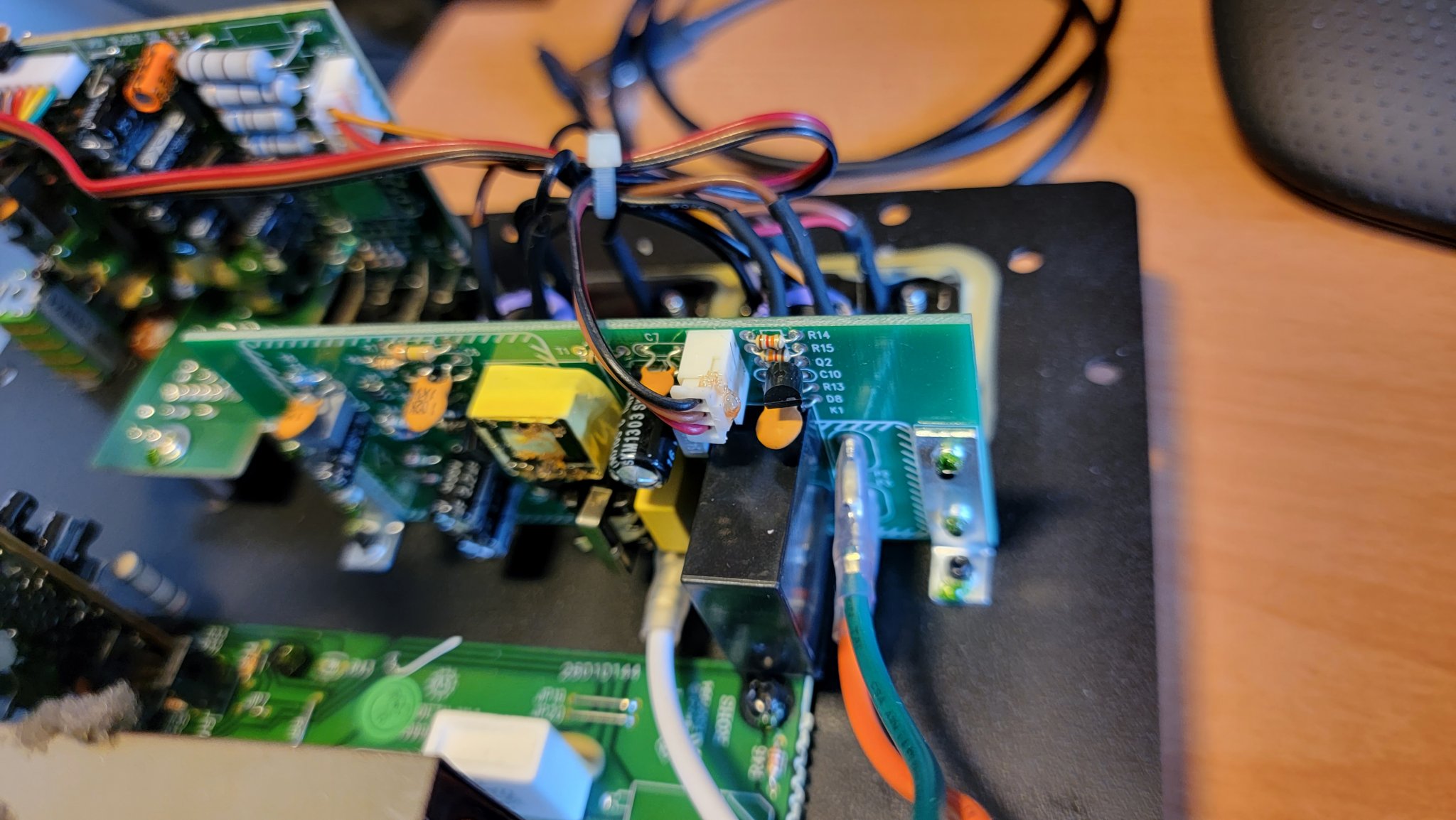

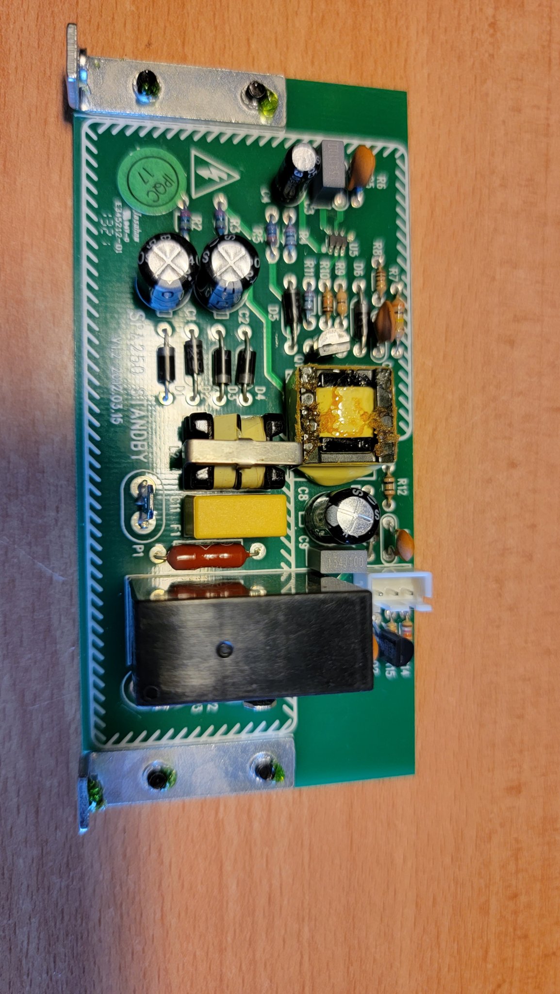

I am just reading this thread, I have a brand new out of box that pops every so often, its a 7hz 25vrms oscillation that comes and goes. Seems to happen more when running amp above and average of 4-6vrms output. I am just getting into why is it doing this and will report back later with findings/fix.
Going by a pervious posters comments about the power switch issue (my issue closely related his issue), I got looking into this to start. What I found was this "popping noise" issue on this brand new amp was indeed originating in the "preamp board". "scoping & reading voltage showed nothing, but I did notice in that the issue seem to get less as the unit played longer. (heat??) I did check caps, (not that there should be issue with NIB amp but built in approx. 2019 by date codes), I moved IC's to different locations to see if problem would move / change. What I discovered in that is if I tapped on board around U2 I could get it to act up. So I resoldered the entire preamp board with decent leaded solder and it has not acted up since. Not scientific troubleshooting but issue seems to be resolved so I'll take the win! Good thing to cause Dayton will NOT respond to my warranty claim emails, which I've read else where they terrible for warranty claims. 5 Year warranty which they will never honor / cheap Chinese solder / bad wave soldering leaves me with this advice, stay away from DAYTON buy something else where possible

My ~4 years old SPA250 was not turning on and clicking of the power relay can be heard. I was about to write off this unit given all the horrible stories I read here and elsewhere, but I got bored one weekend and opened it up. Armed with the schematics of the amplifier section of a similar model I found on the net, I planned to measure power supply rails, but I never got that far. Turns out the power control board (to which I have no schematics) that detect audio and turn on the amp was attempting to turn on the amp and clicking the power relay. This board (photo attached) has a DC power supply that supply standby voltage (12V) to the preamp board. This power supply has a puffed capacitor "C8" (in the photo, it is the round black can with silver top left of the 3 pin molex connector). Replacing this cap with a salvaged cap (16V 470uF or larger) from a broken PC power supply repaired the unit. One would not expect electrolytic capacitors to fail so early, but I suspect Parts Express had these units on the shelf for years before selling them.
