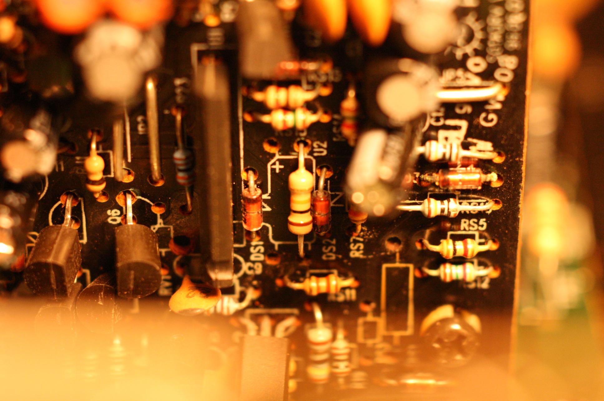

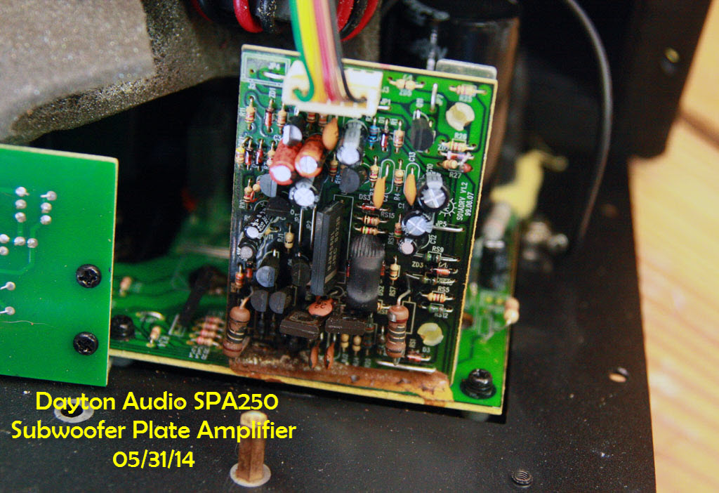

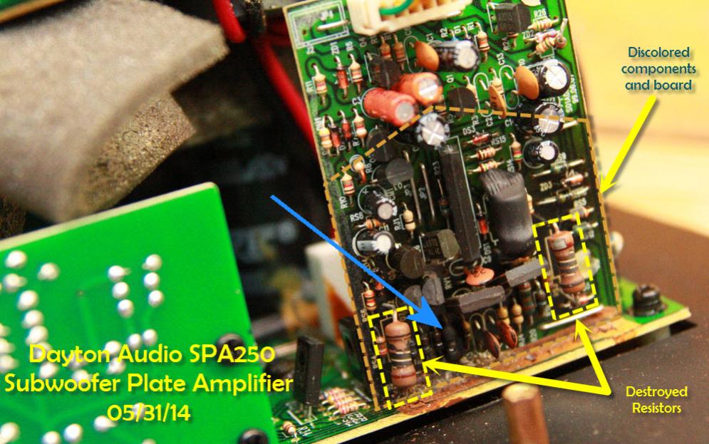

The bad SPA250 finally got pulled. That action "only" took a month. A quick once over did not reveal anything that was visibly obvious. No bulging caps or burn marks. The unit does have a unique smell. It's 11 AM and the temperature is already over 100° in the garage. This looks like more than a 15-minute repair, so it is time to evaluate options: (1) Buy a new unit (backorder at PE), (2) Troubleshoot and repair the unit or (3) go the modification route.
