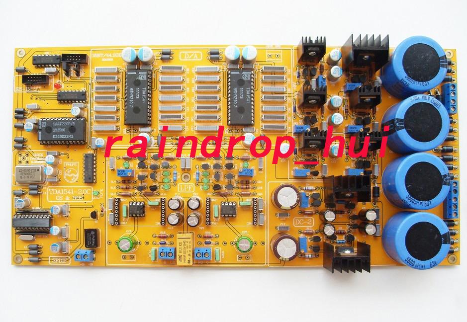

Here's Thorsten's evaluation of Raindrop's 8805/dual 1541:
DAC Kit WM8805 + TDA1541 2.0C parallel output OS/NOS | eBay
from:
http://www.diyaudio.com/forums/digital-line-level/203511-any-good-tda1541a-dac-kit-4.html
Folks,
Okay, lets do some analysis of the kit from pictures, shall we?
First, one quick look suffices to note that this "kit" is mostly a "cut'n'paste" job from a number of sources, not something that I would call a "design".
Let's start at the beginning. The WM8805 circuitry is "bog standard". But the decoupling, instead of following best practice, is based on audiophoolish notions of using through hole film cap's with arrangements that produce long loops on chips that run at frequencies of 10's of MHz all the way to around 100MHz (WM8805 internal operation). The powersupply are generic 3-Pin regulators, including for the critical reference clock for the DPLL in the WM8805.
The "Os-Con's" may look similar to the best series from Sanyo but are the cheaper Nichicon alternative. I have tested these myself and they perform anywhwere between three times (resonance frequency) and twenty times (minimum impedance) worse than real Os-Cons.
So the WM8805 section will work after a fashion, but there is no way it is ever going to offer anything like the phase-noise / jitter levels the WM8805 is capable of. In fact, I think despite all it's shortcomings, a well applied Cirrus Logic CS-8412/14 will have lower jitter.
Okay, the SAA7220 is a MASSIVE noise generator. It's decoupling matches that of the rest of the digital section, that is it has for all intents grassmudhorse all decoupling. The single ferrite bead between the SAA7220 PSU will help, but likely not remotely enough, especially as the "far side" of it is not decoupled...
Just poking a 'scope around the PSU pins on this PCB will be feast for the eyes, I'd predict noise levels in the 100's of mV around the filter and probably no better for the rest.
Okay, now our heavily jittered signal goes to our TDA1541.
This has the same kind of decoupling arrangements on the supplies as the rest of digital section, that is grassmudhorse incompetent and the DEM decoupling is about as bad as can be.
By the looks of it the regulators for the TDA1541's are some discrete ones, does not like shunts though. No matter how good or bad they are, they are too far from the IC's to do much good no matter their nature.
Overall the level of "engineering" around the TDA1541's seems an attempt to recreate the 1980's Philips/Marantz approache and getting an epic FAIL at even that task (I would recommend these players primarily as a lesson in "how not to do it").
Okay on to the analogue stages. These seem a mixture out of one of the common base I/V's we have seen here (there where numerous variation on these all with noisy LEDS's as references), I'd probably rather have a CEN or SEN, but they are probably the part of the whole circuit, thanks to the Chinese Kopy-Mao that calls itself "Engineer" having used a rather decent source to Kopy.
Sadly the Kompetence of the Kopy-Mao did not extend to kopying a discrete diamond buffer to place after the I/V so we find an Op-Amp.
I think almost anyone can build a better TDA1541 DAC on a piece of veroboard and using some copper foil, using what can be learned in the forums here.
Certain the "Reference" DIYA Groupbuy project would be a better choice, wretched as it is...
That's not just a trainwreck, that's an epic, high speed, Wenzhou level trainwreck, complete with completely clueless Wang Yongping style apologists saying "This is all very good and proper, whether or not you believe, I believe it."
CAVEAT EMPTOR MONITUS ES
Ciao T
