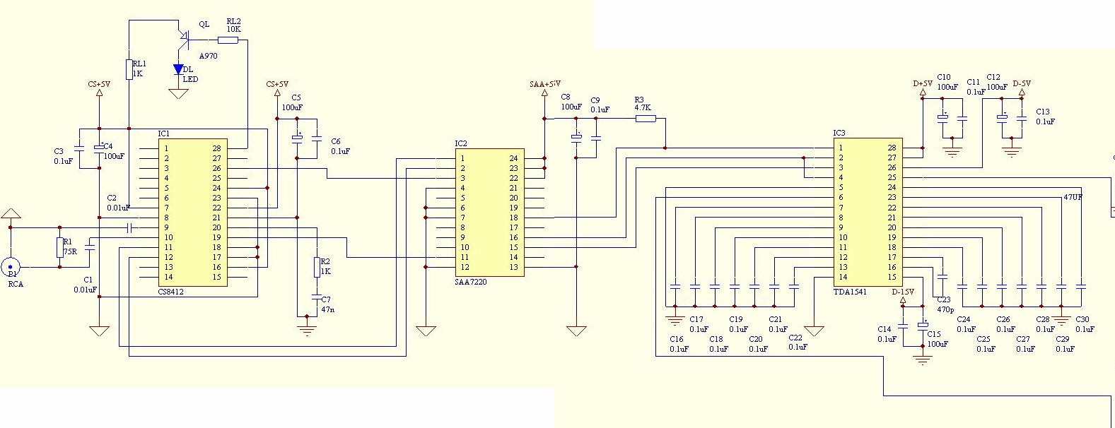

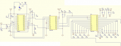

In another thread You say, that this clock is junk, too.
Well, take a look at this scheme, please. I don't remember when and where I did find it. But there are changes in the clock. Are they for something better, or not?
If You want, comment and output stage, please.

Hi ctef, The schematic you posted looks like the Analogmetric dac the same clocking scheme with the F pin on the 8412. So we can assume 2 things. It will throw away samples and make a static sound the severity of which will depend on how much the clock in the source varies from the clock in the dac. The output stage is classic SallenKey. I never liked that filter. The phase response is not good for audio. That maybe the source for the Analogmetric dac. These guys copy stuff. :warped: The dac your countryman has looks way better. That dac proves I think that you can feed I2S 24 bit to the TDA1541. Something I considered doing a long tome ago was to feed the clock from the dac back to the source. That can only work if the clock is the same 11.2896 Mhz. That way there is no variation and the reclocker as such would be lock step with the source (same clock). No static noises. Something I could try once my CDB650 is freshened up. Another reason I abandoned the reclocker was that I needed Sony mode (2's complement MSB first right justified data) this was to run the NPC digital filter. That mode didn't work with the reclocker at all. The SAA7220 is so so. We can do better. I have a few different I/V schemes and a passive filter that sounds nice. Beats any SallenKey filter. PM me with your email I can send you some stuff if interested. :) Dave

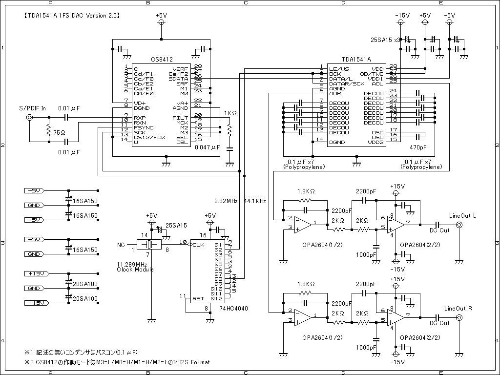

So, I'm persistent in attempts to find good working scheme for OS DAC with this chips. Is it too difficult to make DIY OS TDA1541? :eek: For me, yes, that's why I'm searching some ready project.
Please take a look at this. It is not used 11.2896 Mhz crystal. Any better words? Coming from here:Aliexpress.com : Buy HiEND DAC TDA1541 A (CS8412 & SAA7220) board finished&tested from Reliable DAC suppliers on DavidLouis Audio
For now, I don't care about the output stage. Probably going on tubes.
