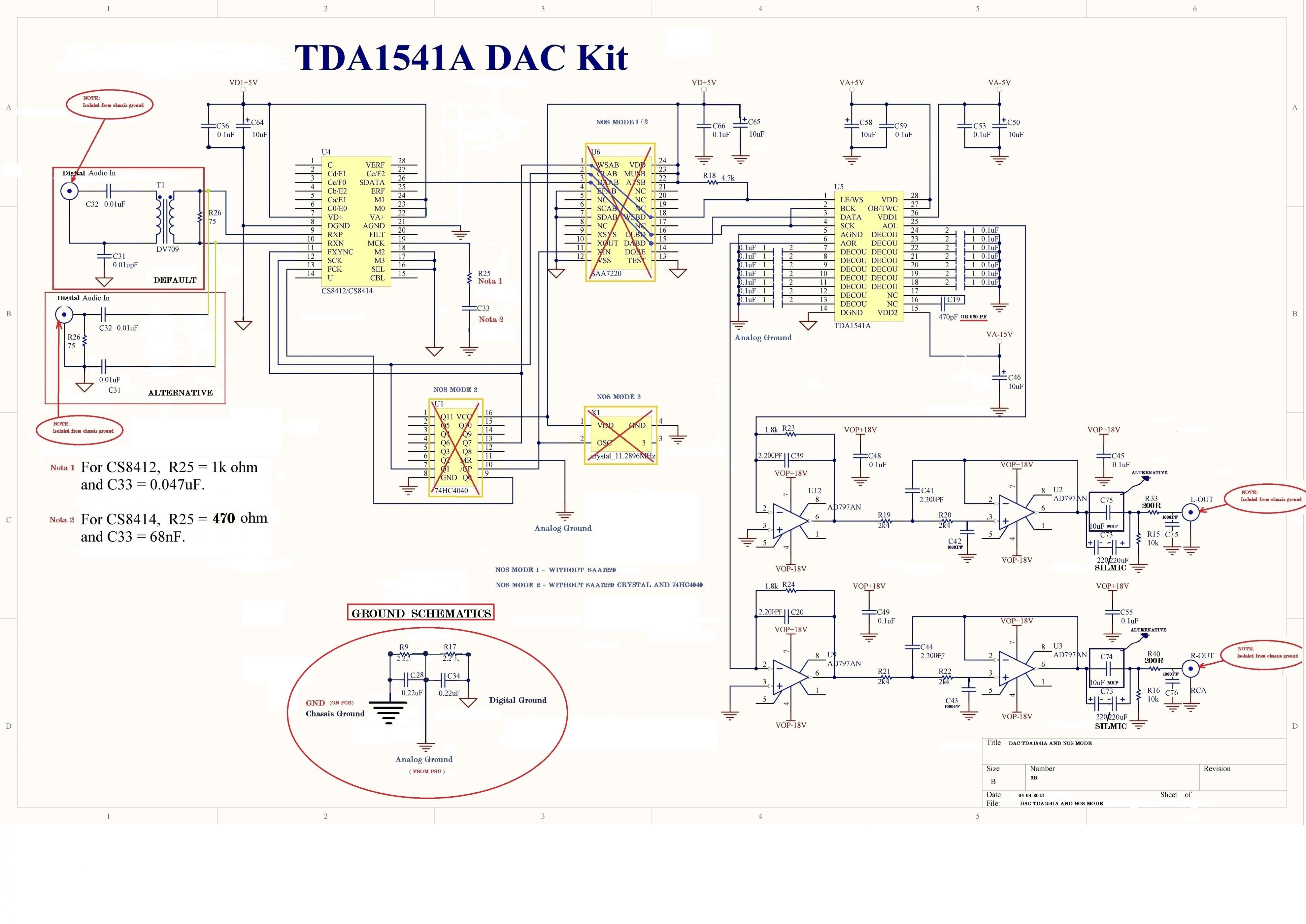

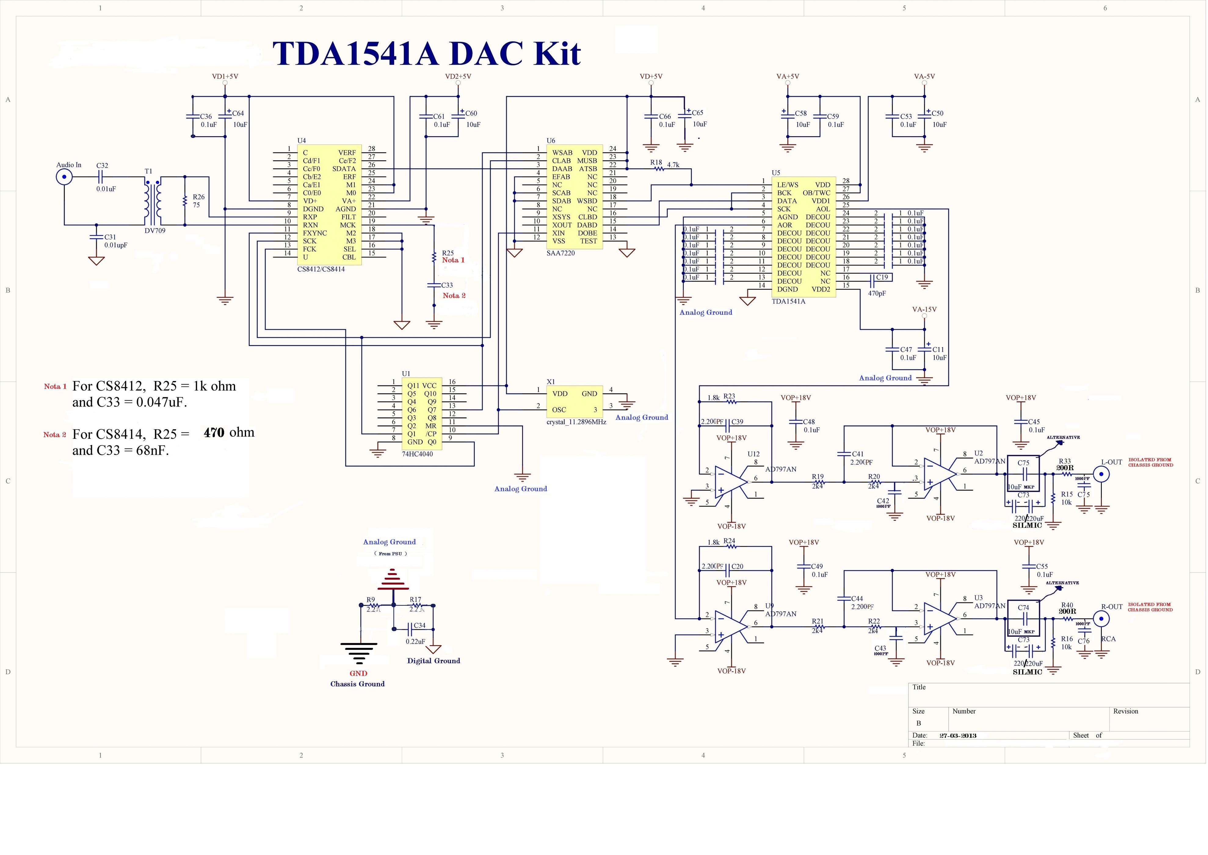

There are many mistakes in their scheme and missing components
The "socket" it is a small relay to switch from electrical in to optical in and D13 is one 1n4148 dc protec and j is for a sw (open is for electrical in) that switches from electrical to optical in.

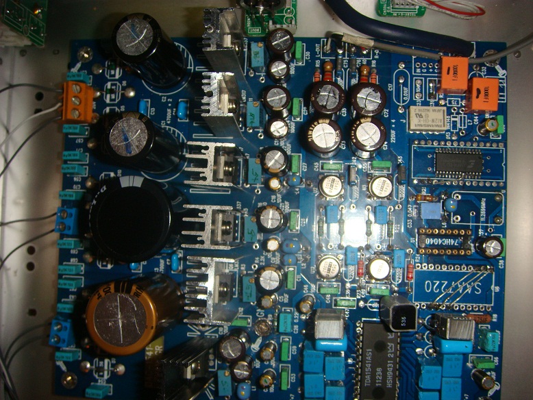

Here is a picture of my board im still making testes

Hey thanks a lot , now i have hope my board will work if you help me a bit.
I was checking your photo and i saw some differences, maybe i'll check carefully and ask you.
If you have a correct part list or modifications to do please send me.
Can you tell me what kind of relay i should buy (maybe part number)
I saw you made NOS, i tryed but mine don't works, but i saw you removed XTAL and 75HC4040 maybe thats why mine don't work.

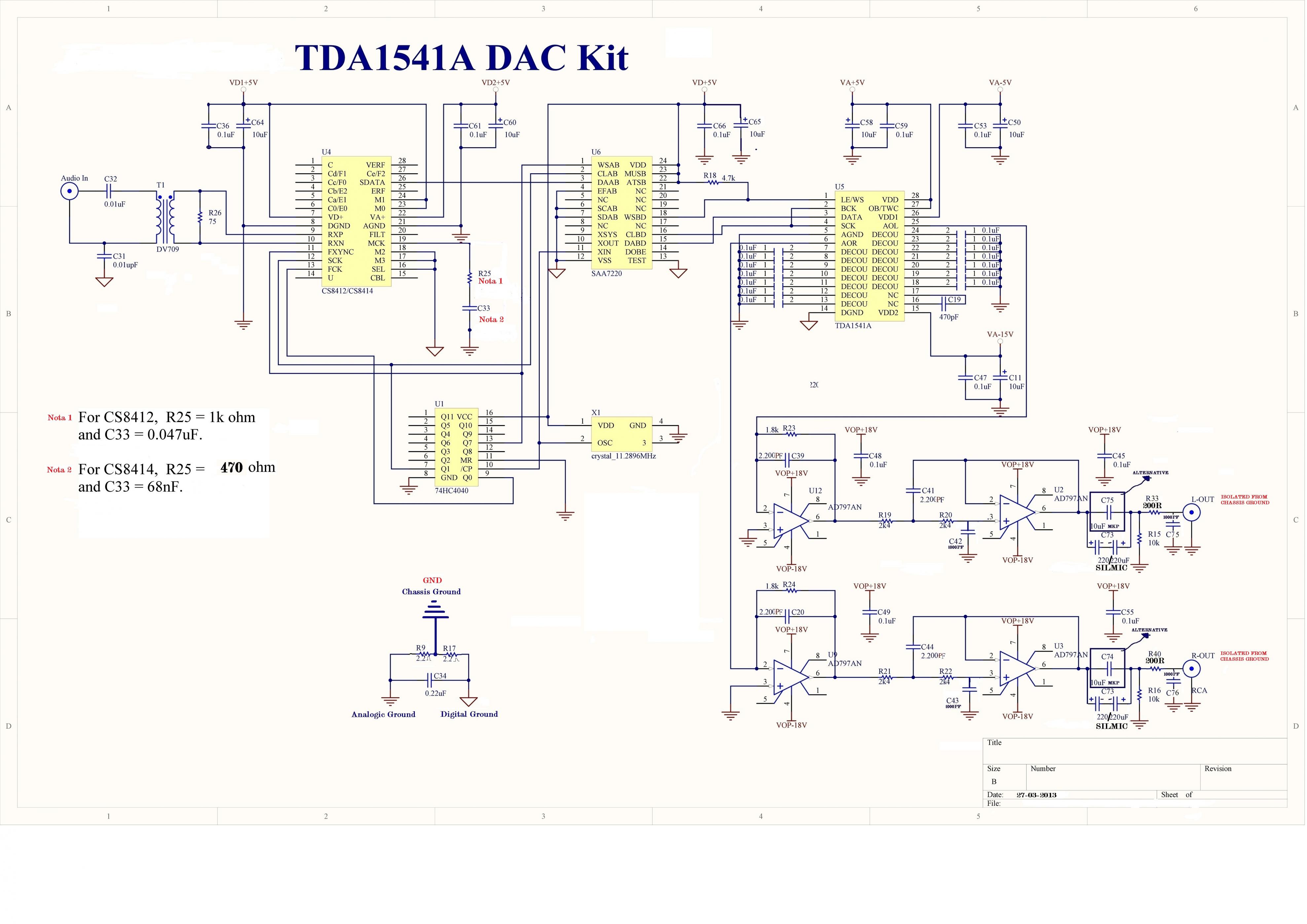

This is my second change to original schematics.
If you find anything wrong please inform.
There are 3 grounds analogue, digital, and chassis ground.
In the pcb, analogue and digital ground they are shunted.
See the pics for the change.
I have not made yet any test only check the grounds and there circuit.

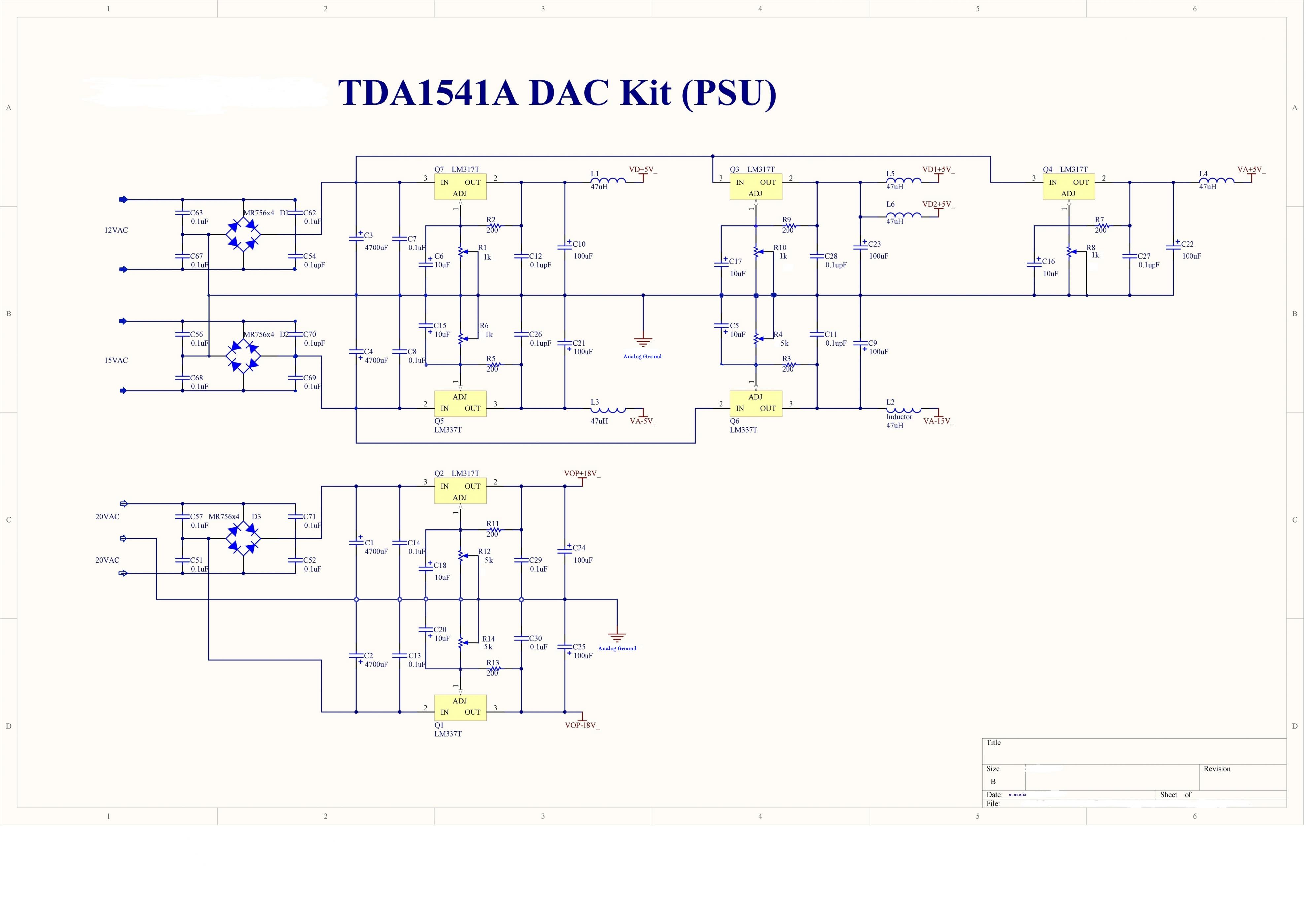

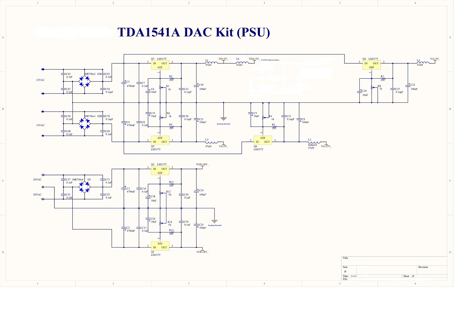

TDA1541A DAC psu
This are my last finding on the power supply and dac board.
I'm amazing whit the mistakes not only in the schematics but also in the Psu drawing.
May be it is best to test everything and then post here.
This Chinese are amazing, i I do not understand how it all worked before with so many errors.
Wrong grounds wrong dc (analogue and digital) supply
Anyway this are my last findings

Hi MANEP, The schematic is really bad. The board is more or less sort of correct. It has less errors. Your also correct about the SPDIF input, the resistor must be across the coax to properly terminate it. If you want low jitter. On my build (I have 2) I skipped the entire analog stage. I also removed the reclocker since it barely works. I used a DIR9001 adapter board that replaces the CS8412. Jumpered the master clock to the SAA7220 socket. I made an adapter to use a NPC SM5814 digital filter. The DIR9001 has 2 modes I2S 24 bit and 2's complement Sony mode 16 bit. I used the Sony mode. The NPC chip outputs I2S to the TDA1541A. There are other options other then NOS. This is how I did it. The DAC benefits from better grounding around the DAC. Check out ECDesigns thread. I made a board that allows PPS surface mount capacitors under the chip for very short ground paths. Hope that helps. Regards... Dave

It is best to put de DAC in a NOS mode (without the SAA) and better output amps like OPA627 and also a low jitter clock.
The sound it will be much better.
I bought this board a couple of years back. I have been struggling with it ever since. I have ripped out the input transformer and put a 75 ohm resistor across the cable. I can now see a signal from the transport. I removed the SAA7220 to follow mod 1. I can see data on pin 3 of the TDA1541, but nothing on pins 2 and 4. On the left channel of the dac I get noise, but nothing on the right. It appears the onboard clock does not work. Should I continue to mod 2 by removing the 74HC4040 and the crystal or try a different clock?
Hi msmart2b, I agree with erin. Junk the clock and 4040. If you have the datasheet for the CS8412 or CS8414 you can put it into "master" mode and jumper the "master clock" to the SAA7220 socket as I did. I have 2 of these. Also you should know that the analog stage doesn't have the correct filtering for the SAA7220 and the AD797 will likely oscillate. If you want to try switching to the CS8412/14 master mode I might be able to help you with that. :D Dave

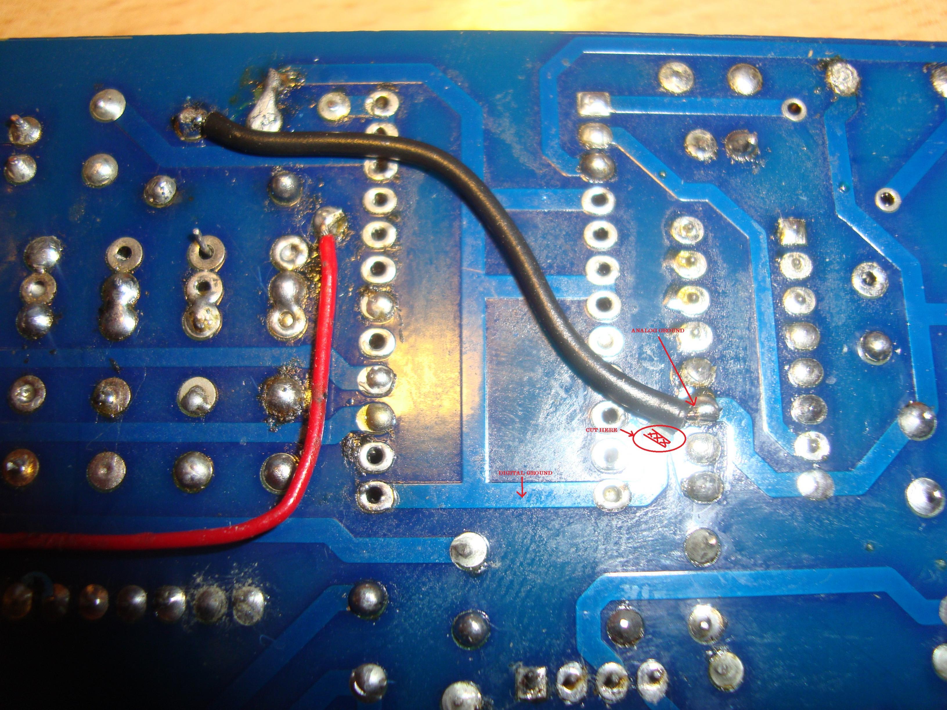

Hi ctef, Don't go by the schematic, that thing is a mess and all polarities are incorrect on the - minus supplies. The good news is the board is correct. msmart2b, Your problem is that by default the CS8414 is in "slave" mode. You will have to make a few changes on the solder side to put it in "master" mode. I will need to look at my second build. Be patient and I will tell you what to do under the CS8414 socket. I have a funeral to attend today and working after lunch. I can send you the information on the "master" mode adjustment tonight. As I recall it is cut 1 trace with an exacto knife and an jumper from there to another pin. We tie a +5 pin to ground to change the mode. Master clock jumper too. I will post the info today. Cheers, Dave :) BTW: The CS8414 probably won't work without a filter on the filter pin
Analogmetric dac
Hi msmart2b, To put the CS8414 into master mode.... Remove CS8414 from socket. Flip board over to see solder side. With 8414 at the top and viewing the solder side, the pins are "right " side pin 1 at the top and pin 14 at the bottom. The left row of pins is pin 28 at the top and pin 15 at the bottom. First thing to do is cut trace between pin 24 and 23. Confirm with continuity tester or Ohm meter that no connection is made between 24 and 23. Next cut trace to pin 23, it will be between the rows of pins. This is +5 as I recall. Follow that trace to the right. Measure with a meter, make sure pin 23 is no longer connected to that trace I think pin 7 is on that trace too. Jumper wire goes from pin 7 to pin 24. Jumper wire from pin 23 to 21. That puts the 8414 into master mode. I would run a wire from pin 19 mck (master clock output) to pin 11 on SAA7220 socket. That allows you to try the digital filter if you want to. The filter is on pin 20, use 470 Ohm resistor and 0.068 uF or (68 nF) film capacitor. Put CS8414 back into socket. Do not use clock or 4040 chip. The input receiver is now "master" and will decode the clock from the SPDIF. That should solve your issue. Dave ;)
