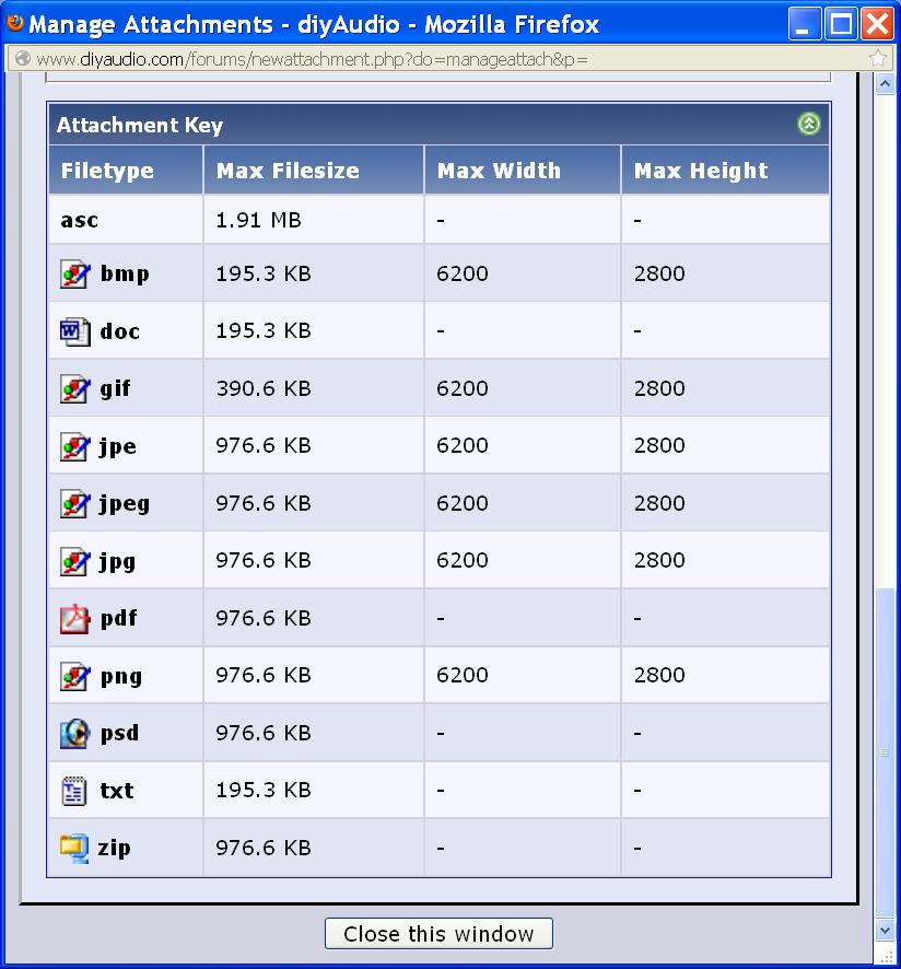

Underneath the text editor is a box called "Additional Options" and a button called "Manage attachments" Click on this and a new "attachments" window opens up.
From there you can upload pics from your computer or a web address.
No need for hosting!
And then when you want to get all fancy-pants with alt-print screen and MS Paint, you can do this:
Look at all the cool things you can attach: .pdf spec sheets, word documents, big zipped files, even weird Photoshot documents? .psd ?
