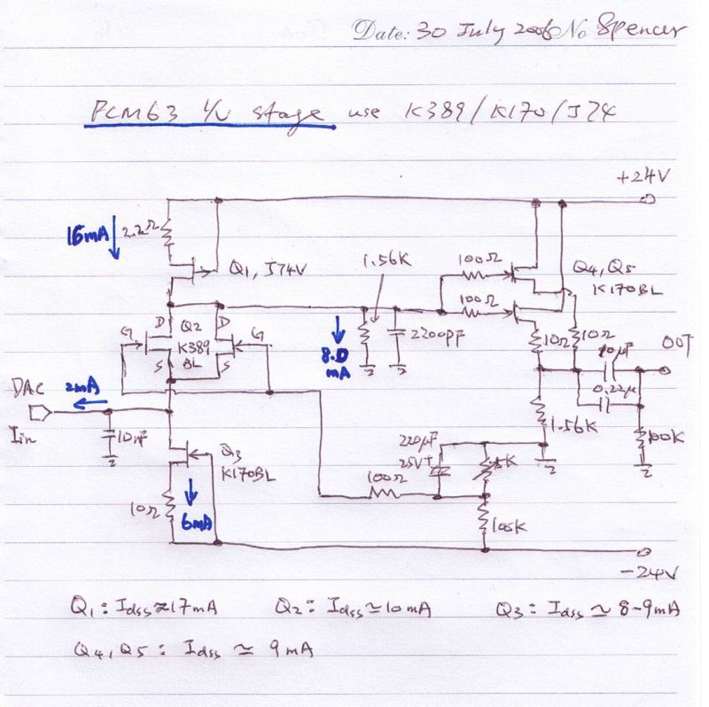

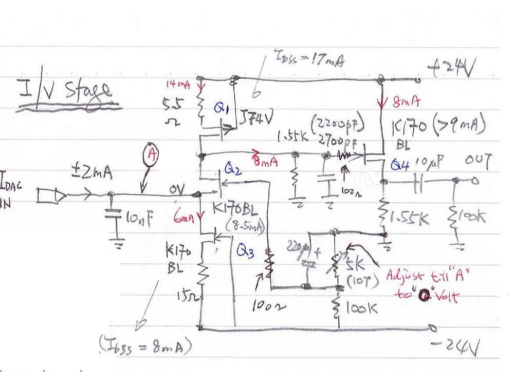

Yes I use 2sk170BL and 2sj74V.
2sk389 data sheet refer to http://www.datasheetcatalog.com/catalog/p51240.shtml
Note two matched 2sk170 = 2sk389.
389 is too expensive to get and 170 is still available at reasonable price.

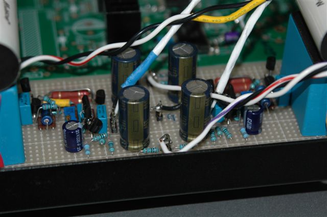

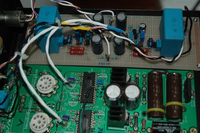

Original tube I/V is just average performance, Russian tube sound like no imaging and poor resolution. Use Nelson Pass I/V is two levels up, Jfet is even better on high frequency. You must try before you can believe. In simple term, well design discrete I/V is much better than Op-amp or tube.
Note the original power supply layout on the DAC is also no good. Need to ensure there is a CLC for each supplier pin/voltage of each PCM63. Thus total use 8 CLC from the two regulators on +/- 5V.
I also put 10uF MLCC capacitors in parallel with Tantanum cap solder direct from DAC supply pin to ground.
All receive IC and DF IC also need better power supply decoupling by MLCC.
