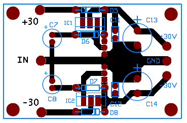

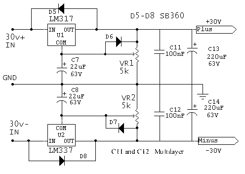

I guess I'll have to regulate everything to ±35vDC.
I did a price list just for the PSU scheme I posted and it's 10$ CAD. It's going to cost a lot of $$$. That's the PSU only for the I/V. There's also the USB to I2S converter, EIAJ to I2S, SPDIF to I2S, DAC, switch, etc. that all need a PSU and the circuit itself. I'm going to build 5 DACs. LOTS of $$$
Do you tell I could just not use the diodes? (Or use standard ones)
Is it important to select special electrolytics? I took some low impedance, high reliability 105°C ones. That's making a lot more $.
But at the same time, since I order more parts, there are some discounts that are not calculated in my spreadsheet that could make me save money too.
the SB360 are normaly OK but it would be safer if they were 100 V.
They are rated 60V which should be OK but schittky diodes are sensitive.
The SB3100 would be better.
The 1N5819 are also low voltage. Do you have these or are you going to buy them?
I would use something rated 1-3 A at 100 Volts.
No, the only components I have are the PCM2706s and the TDA1541As.
Since they're used for protection, I don't think that Schottkys would be a real improvement.
Maybe the diodes will be simply the same as the rectifier if there's a discount after x units
