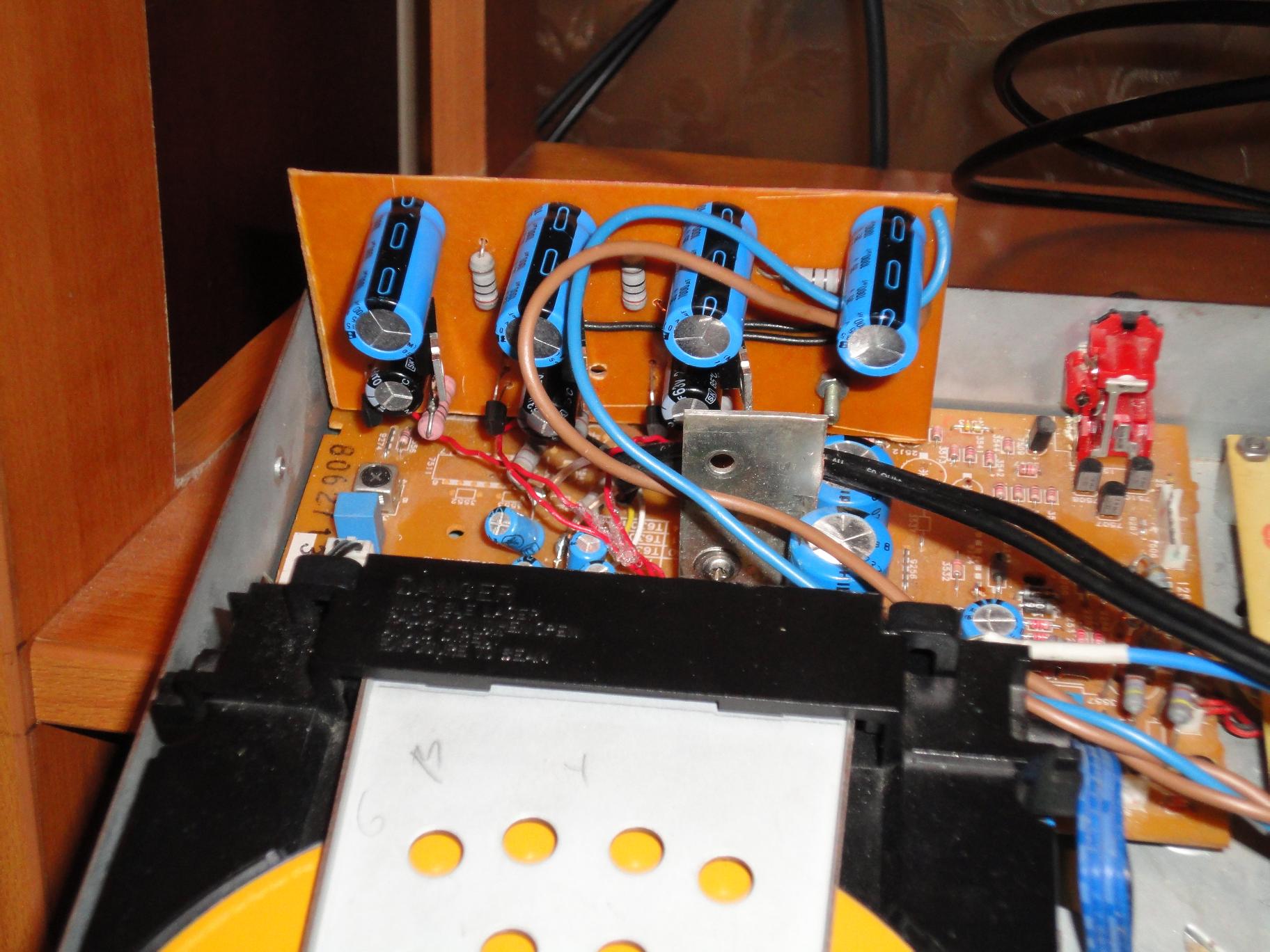

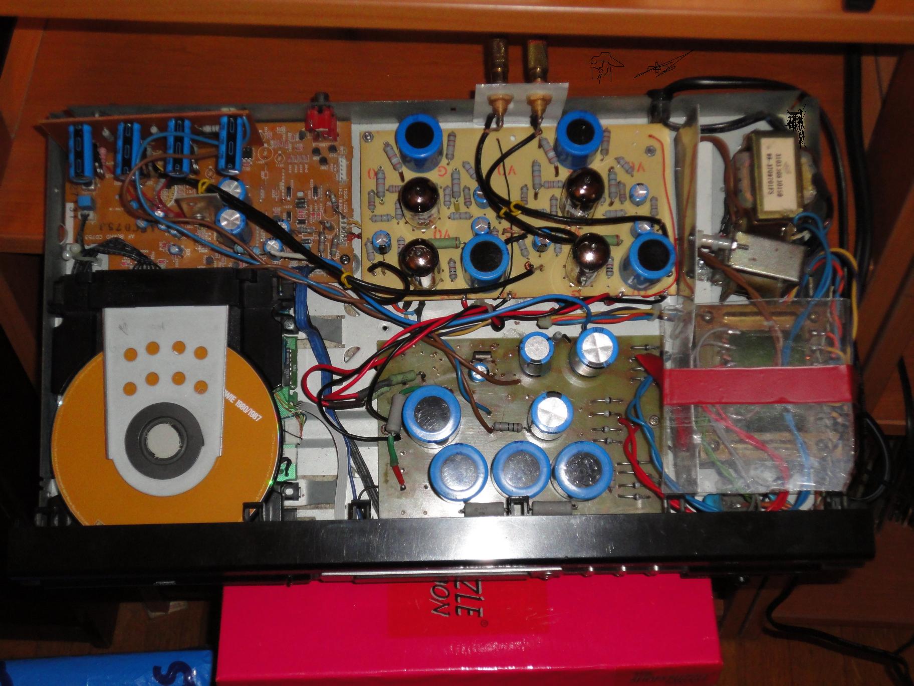

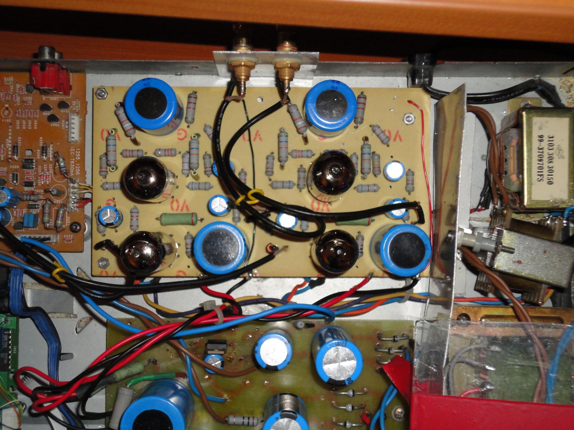

Hi to all , this is my Philips CD753 with many modifications , tube analog low gain and low distortion stage with one PCC88 and one EF183 for each channel , seperate power supplies for the DAC and for the other stages of the player , here is some fotos .
That looks very impressive. Nice work!!
Bet it sounds sweet

I just finnished this tweakings yesterday ( this CD has undergone many modifications over the years ) and I haven't enough time to listen to it , but on first impression it sounds very well , and yes there is an issue with the lid and must make some holes for the tubes to close it .
And the 753 is empty like the 723 it have only one board and one transformer and the mechanism , all the other things you see on the foto is the extra boards - parts .
You can begin the tweakings of the 723 by adding two seperate power supplies one for the dac and one for the analog output stage with an better IC like the AD826 for the output stage and later you can make other improvements .
Nice to see your CD753 guts Dimitris
What an impressive job you've done, tubing output, separate PSU, and more... ouch !
I've noticed you have left 7507-7508-7509-7510 muting transistors.
7507 & 7508 are in use for headphone section, 7509 & 7510 for line out.
Have you tried the player before tubing ?
What is the real gain provided by separate PSU sections ?

Thank's for your comments , yes I left all the muting transistors and the headphones circuit , and take the signal right from the output of the DAC ( TDA1549T ) and feeding the Tube stage , the result is very clean and ''uncolored'' sound and the seperate power supplies improved it more .Nice to see your CD753 guts Dimitris
