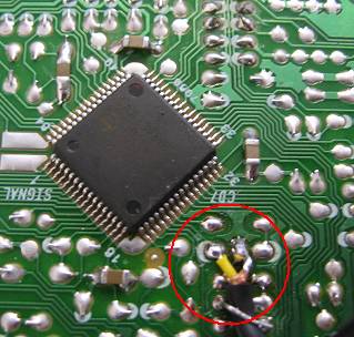

Hello,
Would anyone help me to fit an audio-gd clock in my CD713 ?
This is the clock
http://www.audio-gd.com/enweb/pro/diy/JZ-1.htm
I intend to power it with a 50VA +9V / +12V (2 outputs) toroid transformer.
What do I have to solder / desolder, what do I plug where ?
Thanks in advance.

First, you will need to obtain a circuit diagram of the CDP.
Fitting the clock is, in principle, a simple task.
Unsolder the crystal and the 2 associated small capacitors.
Identify which capacitor was connected to the Xin side of the IC.
Connect the output of your new clock to the Xin.
Connect the signal ground to a ground point very close to the IC.
Remember, your new clock requires a DC input, according to the website, of between 10v and 30v. You will need to construct a DC power supply too not just use the toroid.
Have you ordered the correct frequency clock?
Andy

Hello andy,
Thanks for the remply.
The clock can handle multiple frequencies, from 8.4672 mHz to 33.8688mHz. I have ordered type 1.

Yes, the clock module does have an onboard regulator.
The clock will go to the clock in , pin21 CRin, with the ground to a nearby point.
Andy
PS ..... I do not like this particular board. Although it provides a universal solution to the various clock frequencies, the jitter will not be as good as could be due to all the divisions taking place and the digital noise introduced.

Does it mean I have to solder the "1/4 frequency" of the new clock to the slot of the current clock which is connected to pin 21 ?
I solder the "ground" of the clock to the other hole ?

Ok, thanks Andy.
What do "CLK" and "SHD" correspond to in the audio-gd clock ?
Is "clk" = "FO" and "shd" = "gnd" ?
Please tell me if I am wrong: I have to solder
- "FO" of the new clock to the PCB hole closer to pin 21
- "GND" of the new clock to the hole close to the electrolytic capacitor (the on on this picture http://benjamin.silvestre.club.fr/cd723/horloge/horloge.html close to the poly film capacitor)
Then 2 small cables if not one coaxial
- one cable ("hot" if coaxial) to pin 21 of SAA and "FO" of new clock
- the other (or shield if coaxial) to "gnd" of clock and a groung point of the PCB
Is that it ?

When you connect the clock, assuming that you are using a 8.4xx mhz clock, I suggest you to connect it directly to the tda1545a (pin 1 if I remember it correctly), and to use a wire + 50 ohm res or something similar from there to the servo board (remove the old crystal + 2 caps, the 2 resistors aren't that important as they will stay unconnected once you've removed the caps). Doing so in my own cd713 improved the sound A LOT compared to connecting the clock only on the servo board.
