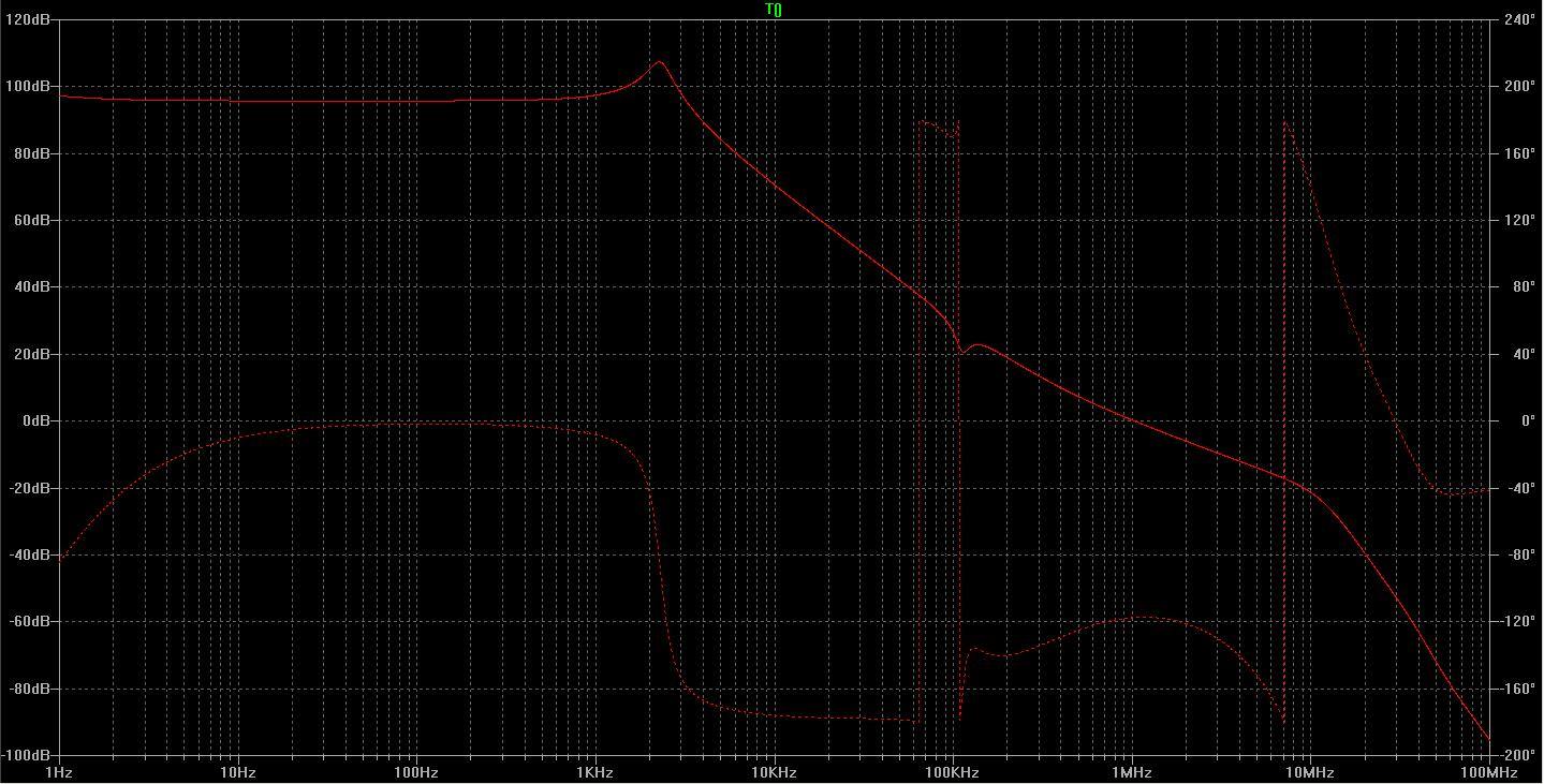

This is true. The only thing missing is an explanation in respect of why you and Bob consider it necessary to split the coincident poles.
In my view the resonant peak is completely innocuous: there is no need to reduce loop transmission by splitting the coincident poles.
I haven't done enough research to advocate one way or another. I simply provide readers of my paper with a way in which they can split the poles, should they so desire.
The thing that concerns me is not the peak per se. The higher the Q of the complex poles (if they are complex at all), the more rapid the transition of loop-gain phase from 0 degrees towards -180 degrees. Depending on the location of the compensation zero, loop gain phase can go within a degree or two of -180. Complex loads (particularly highly capacitive ones) on the amplifier output can knock this over the -180 degree barrier. Of course, the phase recovers whilst the loop gain is still greater than unity so the system is stable - conditionally. See below an example loop gain bode plot of a TPC compensated amplifier with an 8 R || 2 uF load.
It is this conditional stability that gives me cause for concern and requires further investigation.
A correctly designed TPC amplifier will not be conditionayl stable unless you're operating it at unity gain, i.e. 100% loop gain. However, this condition does not arise with ordinary power amplifiers.
And, yes, they're complex poles if you have a relatively large amount of current gain within the minor loop.
Harry, I did a lot of this 'linear' analysis on TPC type topologies circa 1990.
Can you show us a Close Loop response, either .AC or .TRANS which exhibits problems with
  • sensible gains, conditions & loads (loads can be stupid)
  • stupid gains, conditions & load eg unity gain?
But as I said, we are arguing over a single NPO/COG capacitor of at best 4p7 .. which may not do any good but probably dun do any bad either :D
The amplifier whose loop gain response is depicted has a closed-loop gain of 26 dB. When loaded with a purely resistive 8R load, it has a phase margin of 62° and a gain margin of 17.2 dB. In what way is this not (as you have insinuated) "correctly designed"?
There's something very wrong with your amplifier as, from the loop gain response, it appear to have a notch at 100KHz which really wreaks havoc with the phase response.
I have never seen a TPC amplifier with such a loop gain response.
I said, that happens if you load the amplifier with 8R || 2uF. With a pure 8R load that notch isn't there. The amplifier has an EF output stage with 200 mA standing current and 0R1 emitter resistors. Transistor models are Bob's.
There is a standard output network of 10R + 100 nF to ground directly at the EF output + 10R || 1 uH output inductor. (i.e. 10R || 1 uH inductor comes before the 8R || 2 uF load).
First get rid of the resistor in parallel with the output inductor; the resistor ruins the load isolation provided by the inductor.
Simply use a shunt capacitor in series with a resistor at the output of the amplifier, and then connect the inductor, without a shunt resistor, in series with the amplifiers's output.
See "Ironing out distortion" articles in EW by Cherry.
A 1 uH inductor doesn't have impedance magnitude of 10R until 1.59 MHz so I don't think the 10R hurts in terms of load isolation with respect to ULGF. It doesn't feel like a good idea to have an undamped inductance in the output and certainly every text I've ever read about power amplifiers recommends a damping resistor be placed in parallel with the output inductor.
Unsurprisingly, removing the 10R parallel resistor doesn't improve the notch - in fact it makes it worse as before the 10R damped the resonance between the output inductor and the load.
The debate you should be having is not whether that notch is there if you load a "correctly designed" TPC amplifier with 8R || 2 uF [the notch is there - deal with it]. The debate is whether 8R || 2 uF is representative of any likely real-world load. I think not but nonetheless can't shake the desire to be cautious.
Would appreciate Bob's input on this...
I could be wrong, but I recall D. Self indicating in his book that it isn't representative of a real load. Personally I don't think it is.
Maybe so, but an amp doesn't have 9 lives. Basic protection from faulty crossover wiring or zealous tinkerers (are we all not!?) is a very sensible investment. Especially since an amp is liable to destroy whatever else is connected to it in uncontrolled conditions.
Again read Cherry's EW articles for correct way to design Thiel's load isolating networks.
I believe that 8 ohms in parallel with a large capacitance is not representative of a real load, as even highly capacitive loads usually have some equivalent resistance in series. It is arguable that a large capacitance in series with a resistance as low as perhaps one ohm might be representative of such a load.
However, direct shunt capacitive loads in the 1000pF or more range are conceivable due to things like certain speaker cables, so these should be considered.
In some cases a fairly long unterminated speaker cable can be an upsetting load as well. Although transmission line effects are not in play in the audio range, they can come into play in the frequency range in the vicinity of the gain crossover frequency of the amplifier's feedback loop. I show an impedance plot of such a loudspeaker cable load in my book (the cable was not an exotic cable, either). The possible bad effects of such a situation can be mitigated by placing a zobel network at the loudspeaker end of the cable to at least provide some degree of resistive termination for the cable at high frequencies (certainly not an optimum termination, but enough to calm down reflections).

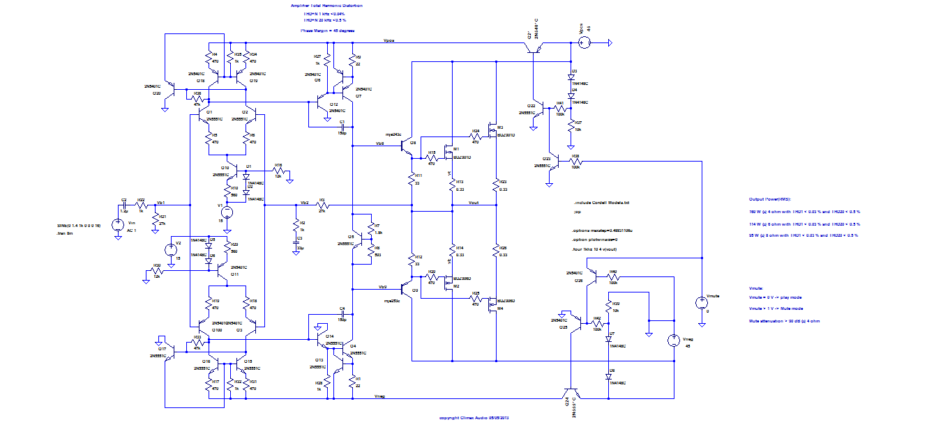

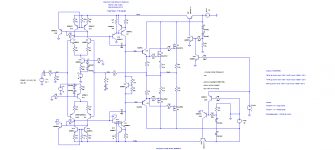

MOSFET output complementary IPS-VAS
Hi everyone,
I've simulated this circuit based on the circuit found on page 139, figure 7.10, of Designing Audio Power Amplifiers book by Bob Cordell, and it's an amplifier with complementary differential input stage with stabilized current mirrors, I wanted to know if this circuit will work in the real world?
I'm thinking about making a thermal shutdown circuitry connected to the Vmute network, using Schmitt trigger comparators and NTC voltage divider, I also wanted to incorporate a good S/C protection, but I don't know if I should use a single slope or multislope VI limiter. This circuit made by Bob Cordell seems very stable and with very good characteristics at the simulations. I had to use two 150pF capacitors instead of the 30pF ones to maintain a 45 degree phase margin, what is causing this effect?
MOSFET gate capacitance?
I also want to thank Bob for the Cordell Models, and for the LTSpice tutorial
Thank you very much for your attention,
Best regards,
Daniel Almeida
