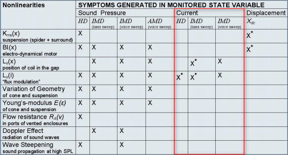

Us true speaker jocks just want amps to do what they say they'll do; ie provide a stiff voltage proportional to the signal and nothing else .. under ALL conditions. Even the 'damping factor' myth is an Amp marketing thing. Good speaker designers are well aware of how much difference this makes (I exclude the legions of pseudo speaker gurus.)
Actually there are many advantages to current, rather than voltage drive of speakers. Its just that designers have stuck to a voltage standard since the invention of Rice & Kellog's Moving Coil Speaker Notes on the Development of a New Type of Hornless Loudspeaker in 1937?. No one is quite sure how to do proper current drive speakers.
Conversely, their paper has many insights which the majority of Thiele/Small pseudo gurus have still to grasp. R&K also designed and built the first HiFi amp, with one giarnomous Watt of undistorted power, to drive their baby.

Bob, maybe a mention and brief survey of Current Drive or controlled Zo amps in the 2nd Ed. I don't think its worth too much effort until us evil speaker designers get our fingers out. :)
It might be worth mentioning in section 17.8 that some designers, like Bob Carver, believe the circa Ro=1 of valve amps is a big part of their sound.

Actually, I am somewhat of a DIY speaker jock, having designed several, both passive and active, which are described on my website (CordellAudio.com - Home). I also developed the EQSS (Equalized Quasi-Sealed System) system for better bass in a given size box. So I plead guilty to being somewhat of a speaker jock. I also admit to being a Thiele/Small believer :).
Anyway, I've never bought into the use of current drive, at least for conventional louspeaker systems. Perhaps you can explain the advantages of current drive. Or are you advocating current drive of loudspeakers that are specifically designed to be current-driven?
I've been fascinated with the idea of controlled Z amplifiers since I think the Leak amps which had variable damping. Also interested in negative output impedance amplifiers for use in quasi-motional feedback arrangements that don't need an accelerometer (ElectroVoice did something like this back in about 1970). Might be worth a mention in the book - thanks for the suggestion. I plan to discuss a bit amplifiers for use in active loudspeakers, and maybe a bit on active loudspeakers themselves as examples of those amplifiers. That might be a place to mention variable Z. Each of my 3.5-way Athena louspeakers has four 125-watt vertical MOSFET amplifiers in it.
I tend to agree with Bob Carver that the ~1 ohm output Z of tube amps accounts for a good part of their sound difference, although that effect will vary considerably from speaker system to speaker system attached.
Note that on page 371, Section 17.8 "Optional Output Impedance" I do show a circuit for switching in an optional effective output resistance of 0.4 ohms without flowing the speaker current through a switch.

I think it was kgrlee ? who gave a link to Loudspeaker Nonlinearities by Klippel http://www.klippel.de/fileadmin/kli...rature/Papers/Klippel_Nonlinearity_Poster.pdf If it was, Thanks, if not, Thanks to who did :)
I might be misunderstanding the data in the screenie ? but i don't mind being proved wrong to find out the facts. If you don't ask ;)
It "appears" to me, to show that, out of All the possible causes of Distortion, Current is the least offender ! In which case to me, it "suggests" that Current Drive "might" actually be beneficial ?
Don't bite my head off, i'm Only throwing out an idea i had :D

Richard Small is a good AES friend of mine, and I think he is one of the finest, smartest gentlemen in the speaker business. He is also kind and humble.
Bob
