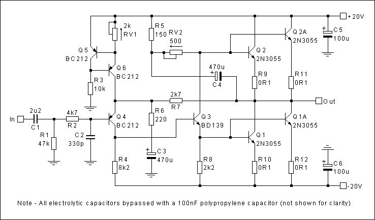

traderbam said:Graham,
I believe the number of junctions is more influential on the stability of the system than the notional number of stages. You implied earlier that you circuit had two stages and was therefore inherently stable. I inferred that you meant that each stage could only contribute up to 90 deg of phase lag and so two stages never quite becomes completely unstable. However, I disagree with this reasoning as each "stage" is not limited to 90 deg. Each junction can contribute 90 deg or more phase lag and so having three or more cannot strictly be said to be "inherently stable". It might be more stable than a 4 junction circuit, however.
The classic Class AB amplifier is regarded as having 3 stages,
an input differential stage that used properly only has current
gain, a voltage stage that effectively has all the voltage
gain, and a buffer output stage with only current gain.
In this context GM's circuit is a two stage amplifier, as is JLH's
classic class A design. Here the voltage gain and driver stage
are combined with a "phase splitting" transistor, very similar
to standard valve amplifier practise. The White cascode follower
class A push pull output stage is also based on valve practise.
The 3 stage circuit is certainly not inherently stable
without correct compensation arrangements.
According to this :
http://www.tcaas.btinternet.co.uk/jlhtrans.htm
Neither is a two stage design.
http://www.tcaas.btinternet.co.uk/jlhesl.htm
For the 2 ohm Quad ESL version of the JLH, I believe GM's circuit is a development of this.
sreten.

Hi sreten,
All of my circuits follow the non-complementary bipolar output as first published by JLH.
John knew what he was writing about.
I first built a triple push-pull 50W-8 ohm just after the original 69 article came out. It used two mirrors plus CCS, was rebiased to 6 ohm, and then a rather hot but still reliable 4 ohms. It was very clear sounding and is right beside me as I write this more than 30 years later, though one of the psu elecrolytics has recently left a puddle.
JLH himself wrote about 90 degree phase shifts per device, but whether they have an impact was not covered !
You have attached the circuit suggested by Jos in post#34.
R4 and R8 are the best compromise for the single ended input, but provide insufficient pulldown for really good high frequency response at large amplitude.
Better results are also possible by reducing R6 and R7 to 47R and 560R.
A differential stage however further reduces distortion by a factor of ten, and I am sure that Rtirion has seen that the stability margin of the 'One ohm' circuit remains excellent, with both of the 90 degree stage turnover poles being clearly defined, and no minor poles showing at all, as with the circuit you have just posted.
My use of the words inherently stable does not mean that the amplifier cannot be made to oscillate due to load induced phase change interacting with the amplifier's first 90 degree phase change. I have not implied any meaning that is different to what I have stated.
Electrostatics are hard to drive cleanly. An amplifier which suits them is not automatically best suited to driving all other types of loudspeaker. However any good amplifier should be able to drive electrostics if the transformer has sufficient primary dc resistance, or if a low value series resistor is inserted, say 100 to 220 milliohms.
Note that the response of this JLH circuit is softened by the inclusion of an input filter which might increase stability with electrostatics by reducing the maximum slew rate. I choose to leave all input filtering to the pre-amp or source, and thus enjoy clearer reproduction by not fitting them.

Graham Maynard said:Now that the circuit is up, your questions should be answered. I said amplifier output - which is - V at terminal !
I was referring to what you said the second trace was of. And with respect to the second trace, you said two different things. First you said the second trace was "bass driver output" and then you said the second trace was "V at bass driver."
Steve. Your use of the word 'Huh ?' shows not only that you don't understand what I have written, but that you have an attitude which is keeping you from thinking for yourself before you ask questions.
Thinking for myself isn't very helpful when it comes to trying to understand what it is that YOU are trying to say.
And my understanding of what you have written can only be as good as what you have written. And some of what you have said isn't very understandable. And I'm not sure whether that is due to a lack of understanding on my part or a lack of communicating on your part.

Millwood,
You keep bringing up Mosfets for the JLH circuit.
I said they will not work.
Due to their gate-drain capacitance, which don't forget wrt resistor fed gate drive is dynamically amplified by the Mosfet stage gain - which is also influenced by the load (loudspeaker) and *its* reactivity, the JLH circuit, which naturally amplifies treble transparently, is turned into an unstable three stage amplifier.
The varying Mosfet gate capacitance upsets the current splitter by causing hf imbalance. The original JLH was slightly affected by bipolars, that is why I use low value resistors in the circuit I submitted to LineSource.
The stabilisation components that become necessary with Mosfets then introduce high frequency first cycle distortion, which audibly affects transient reproduction, and can be measured by Fourier analysis using a simulator.
No.
The Williamson does not work anything like the JLH.
In its phase splitter the anode resitance went to a low impedance voltage supply to optimise voltage splitting.
The collector resistor in the JLH splitter has a high impedance source point, for current splitting.
In the Williamson there is a differential triode stage following the phase splitter to further improve the and match the voltage waveforms - AND - isolate the triode connected tetrode's grid-anode capacitance, which is also influenced by load reactivity, from the push-pull voltage phase-splitter itself.
When you tell me that you can make the JLH circuit reproduce first treble cycles more accurately using Mosfets, than the circuit I have already forwarded to LineSource, only then will you prove me wrong.
