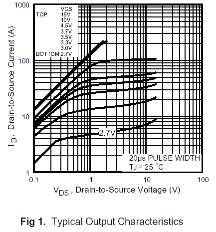

Charles Hansen said:
The "on resistance" value is only pertinent in switching applications. In linear applications, it really doesn't mean much (except in a very indirect secondary way). What's relevant here is transconductance. In this case (3.5 amps of idle current), a bipolar output stage will have a transconductance of around 150 or so. This gives an output impedance of around 10 milliohms before any feedback is applied. This cannot be matched by any practical MOSFET output stage.
testing my sim with a 1 A 5KHz sine current source on the output gives ~ 6 uOhm Zout @ 5KHz with the feedback loop gain helping out of course
looking at U3 gate voltage i get ~ 60 S tranconductance for the output stage, 30 S per device isn't quite bipolar performance but it seems adequate, particularly as the drive circuit is a to-92 bjt buffering an op amp
there seems little reason for output Q impednce to be much lower than the current sense resistors - we are talking class A here so i assume some degeneration/current sense of >> 10 mOhms will be necessary
WHAT?!
"looking at U3 gate voltage i get ~ 60 S tranconductance for the outputstage, 30 S per device isn't quite bipolar performance but it seems adequate"
Unless I have missed something, you were talking about a pair of IRL3103s............... The minimum transconductance in the data sheet is 22......... FOR AN Id OF 34 AMPS!
At 2 or 3 amps of bias current you are probably looking at a transconductance of something in the range of 5 to 8 for most of the high transconductance vertical mosfet I have played with The graph doesn't show this in the data sheet for the IRL3103 since it does go down to a few amps. Look at the trends of Gf verses Id for a few other Hexfets like the IRF150, IRF240, ect. Without a feel for transconductance as a function of temperature and Id you have no reality check for Spice results. When you get results verging on an order of magnitude different from realistically expected it is time to find out why.
http://www.irf.com/product-info/datasheets/data/irl3103.pdf

hi Fred,
certainly i've pushed the sim to the point where some “ground truth” would be the next step, i've mentioned my mistrust of the model several times
but 30 S doesn't seem impossible, as you say the 22 S is a min # and the transfer characteristic graph in the data sheet fig 3 shows gm beginning to level off in the high amp range, it looks to me like there is room for the curve to steepen below 10 A
in fact, looking at fig 1 i think you can find the current going from 4 A to 14 A for a 2.7 to 3 Vgs change, …that sounds like 33 S to me

Fig. 1 is for a temperature of Tj = 25 degrees C. I (and I would imagine Hugh and Grey as well) would sure like to see to cooling system for that amp! Liquid nitrogen perhaps.........
Fig.3 is a linear to log graph and estimating the trend of the curve past what is shown on the graph can be Very misleading.
In school this is what we use to call cooking the data. I am reminded of a story told by my Dynamics professor. They were doing a study on auto collisions with an experimental collapsible lightpole. They were using a very large steel ball swung on a chain to simulate the cars mass and velocity. The only thing they could find to weigh it was a truckstop scale. They explained to the scale operator what they needed and he said "How much do you want it to weigh?"

hi Fred,
i think your current objection is that the data is from an "undercooked" transistor
turning this to a discussion of thermal dependence of gm when you originally claimed the sim # had to be an order of magnitude off
the fig 1 data can be interpolated well enough to show ~ 30 S @ 5-14 A, admittedly pulsed to make a Tj=25 C measurement
unfortunately the threshold shift prevents reading similar Id, Vds from the 175 Tj curves
how much should we expect gm to drop at 120-150 C Tj, 30% ?

Read the data sheet. Your playing a game af apples and oranges. I am talking about trying to figure out what the tranconductance in real life under real operating conditions. Don't try and guess data that is not on the datasheet. Go look at the data sheet for something like the IRF150 to see how these parameters change from a couple of amps to a couple of tens of amps.
The data you assume is with the transistor at 5-14 amps and Tj=25 C. That is not where the transistor is biased. Base your
measurements on actual bias currents and operating temperatures. I would assume that one would want to know what the small signal transconductance is rather than what it is doing pulling the load close to the rail. Also Figure 1 shows a pretty serious change in transconductance with with drain to source voltage and doesn't look too linear.
