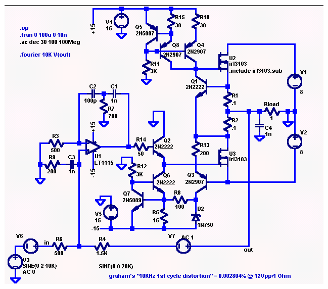

AndyC's comments and Graham’s own equation of filter and amp performance under his 1st cycle distortion confirm my first intuition that that “1st cycle distortion” is simply a measure of bandwidth
The specific formulation of 10 KHz 1st cycle distortion of < 0.01% equates to a 1 MHz open loop bandwidth requirement (at least for a 1st order roll off)
While I did use “ridiculous” in characterizing the implied high bandwidth I am not in fact directly critical of such a requirement as being a necessary condition on loop gain-bandwidth for achieving low distortion with global negative feedback
However after designing a feedback stage that fast I would then filter the input to prevent MHz signals of even mV levels from reaching the input stage, particularly with undegenerated bipolar input transistors in a low noise design

I have proceeded with a somewhat more conventional grounded supply variation on my original op amp/mosfet circuit (instead of doing my tax returns)
U2,3 are IRF logic-level fets rated 98W by IRC – meaning that they can probably handle ~30 W power dissipation without water cooling
Q1 with R1,2 forms a feedback current servo controlling U2 to ~4A Iq, taking the output from the center of the R1,2 current sense gives a push-pull class A output (Q4,5,8 provide 50 mA bias to Q1, the parallel Q4&8 are necessary for worst case power dissipation with t0-92s)
U3 is a common source output fet with Q2 providing low Z gate drive
The LT1115 is a low noise, high bandwidth op amp that provides large gain, the compensation is somewhat complicated by the additional gain and inversion from U3
The most unusual feature of this circuit is the bais for Q2 which partially compensates the huge gate C swing of U3 at low Vds, Q6,7 feedback current sink is set at 50mA, at higher U3_Vds R13,Q3 shunts some of the current, reducing the bias and increasing the incremental R of Q2 – increasing damping as U3 gate C decreases
The circuit’s compensation is trimmed to reasonable margins that still give enough audio frequency gain for most distortion components to be below –120dB, but the whole effort could in fact be a pipe dream given the likely accuracy of the subcircuit model of the IRL3103 with respect to analog behavior
Less aggressive compensation could likely tame real mosfets with some distortion penalty

Hi jcx,
You found that 0.01% first cycle distortion equates to approximately 1MHz of bandwidth.
I have never checked, but the original 1969 JLH class-A did have a 500kHz bandwidth, which they did not realise at the outset because this was higher than the measuring equipment itself.
That's a mighty good first cycle distortion figure for Mosfets !
Nice to see something different.
I note your use of (borrowing your word) agressive pull-down of gate voltages. It is inverting; could the other 500 ohm R3 be used as input ?
If you have 0.002%, is that circa 5Mhz on the simulator ? I wonder what the stability margin would be like out there ?

Hi jcx,

While I have explored R3 as a non-inverting input the main reason for going inverting is that R3 must be well grounded for MHz AC signals, not something to rely on at an input
R6 is shunted by the noise gain R9,C3 and is less sensitive to high freq input impedance of the driving circuit – which I would still like to be very low at MHz, perhaps a ef buffer inside the op amp feedback loop of the (assumed) preceding active filter stage – I wouldn’t expect 500 Ohm input Z to go over well in a general purpose audio amplifier
Reversing driver wires is easy for biamping diyers if the inversion isn’t canceled elsewhere
Stability was checked (and compensation adjusted) by looking at 1 Vpp steps at 0 and +/-5 V out, leading to the realization of the need for some compensation of U3 gate C variation with bias point
.ac analysis with V7 gives the loop transmission, evaluating gain and phase margins at the differing bias points gives >40 degrees phase margin at 5 MHz and 10 dB min gain margin at 23 MHz
if I even halfway trusted the mosfet model I would suggest that a skilled builder might have a chance at getting the circuit to work, but I would be surprised if further serious reengineering wasn't necessary too
