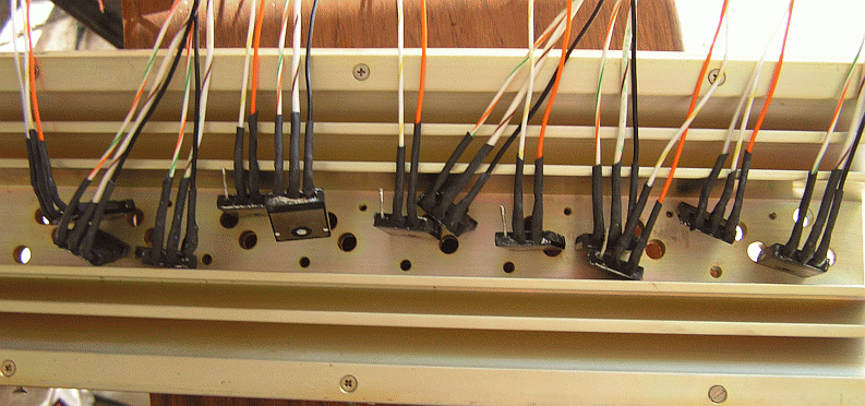

LineSource said:
I built a point-to-point breadboard and learned the following:

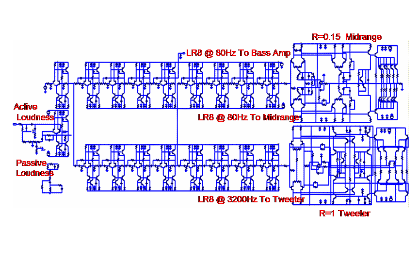

AndrewT said:Hi,
with a load that low, how well would a transformer work?
I am using a 0.15 ohm to 4 ohm transformer now, but a vector impedance bridge shows phase shifts which I wanted to experiment removing with a specialized DIY Class A amp... I use a +/- 5V LC filtered power supply. The output uses 8 pairs of 150 watt Sankens.
Almost finished the PCB layout:
1) Both active and passive ISO 226 loudness contour circuits. ISO 226 is a room adjusted modern version of the anechoic Fletcher-Munson work.
2) 3-way LR8 crossover at 80Hz and 3,200Hz using Pass discrete JFET opamps
3) 0.15 Ohm Midrange ribbon direct drive 32-watt Class-A amp using dual differential topo.
4) 1.0 Ohm Tweeter ribbon direct drive 16-watt Class-A amp using super-sym JFET-Bipolar folded cascode topo which provides 2x the 4.4V midrange power supply voltage. This allows sharing one 35 AMP CLC filtered +/- 4.4V power supply.
5) The Bass amp is a 200 watt Class-D module driving 2 ohm load from four Lambda TD15S.
6) Planning to put all into one chassis at the speaker.
I’ll post an update if it doesn’t smoke and measures well.
