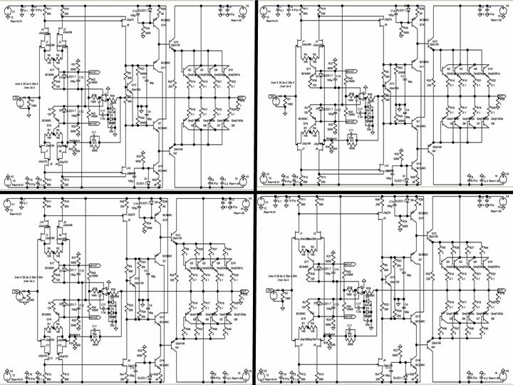

Most of the semiconductors I ordered have come in and I have soldered up three different input-VAS stages and started tweaking and listening.
1) MAT02/MAT03 complementary differential..current source per diff.
2) JFET-JFET complementary differential..current source per diff
These two keep the servo out of the input signal path by tugging on the current source bias resistors as shown in my "design 2"
3) Stacked JFET-JFET_cascoded input complementary differential as shown in my "design 1"
All three sound different! My ears favor (3) until I hook up the servo opamp, then the sound becomes dull. Matching JFETs is very difficult and time comsuming. I had to purchase parts from two different vendors to get a close match.

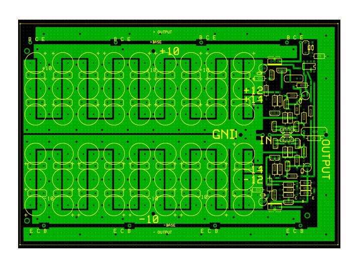

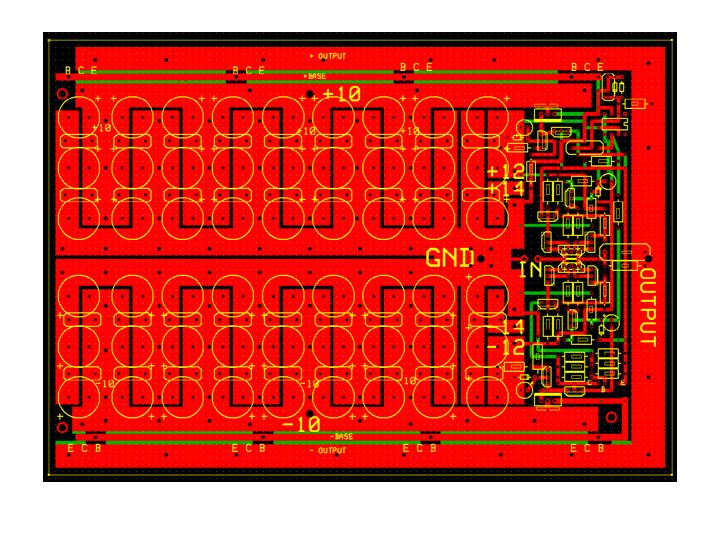

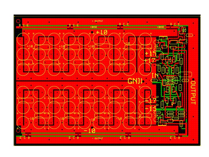

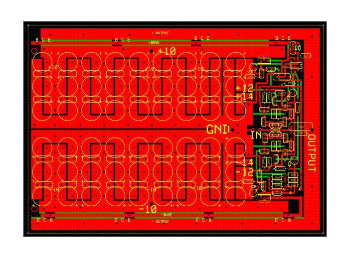

This PCB layout can accomodate all four circuits topos described above.
Any critique of the layout would be appreciated before going to fab. The board is 60 sq inches, approximately 9" x 6.6" to evenly spread the heat on a 12" x 12" heatsink, 2oz copper, $23 protos. With 4oz copper it may be better to put a star power grid on the bottom layer, and signal output star on the upper layer with the circuitry in the center.

actually the schematic appears as an unreadable group of four
jpg is not the best for lines and text, if you're using paint gif is better, png can also give good compression of line drawings
as for the pcb layout, why not ground plane over pwr and why route large currents in a loop around your lowlevel input circuitry - not as urgent a problem with class A as with class B but still unecessary - just take the output from between the low level circuitry and the output with a pair of heavy twisted wires
PCB DESIGN 1 TOP LAYER
Top Layer for first PCB design. No jumpers are required. 2 oz copper.
jcx....The output was run around the outside perimeter to bring it close to the input for a good quality feedback path....thinking this was more important than the current induced noise you mention could be a problem.

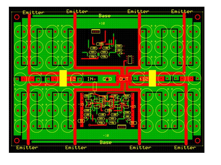

Sketch..alternative PCB design
Unfinished layout of alternative PCB design using star connection of outputs. Three jumper wires probably necessary, including + and - 12 power supplies. 4oz copper may be necessary.
Would this be a better PCB topology for low noise and low distortion?

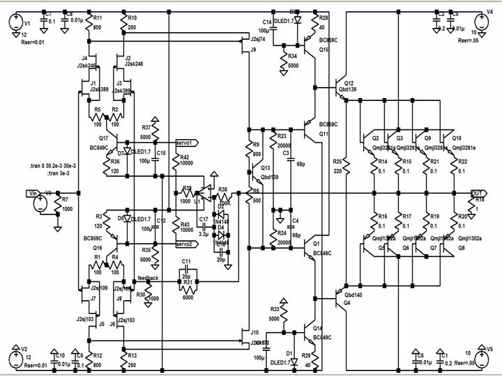

I built a point-to-point breadboard and learned the following:
1) A servo that adjusts the current sources into the symmetrical input diff pairs is not capable of a deep null... ~50mv still remains. A standard voltage summation servo drops this to just a couple mv.
2) A folded cascode with JFET inputs and Bipolar cascodes gave higher current gain which reduced distortion. In addition, I changed to a full symmetrical topology with push-pull bridged output design. IT SOUNDS FANTASTIC on my Full Range Apogees.
3) I have adapted the Class-A symmetrical-bridged folded cascode to direct drive the 0.15 ohm midrange ribbon using 8 output pairs, and I have completed a 60 sq in PCB layout to hold the two amps plus 12 JFET descrete opamps for LR-8 crossover. I'm experimenting with low level loudness compensation(see post) before I buy PCBs.
