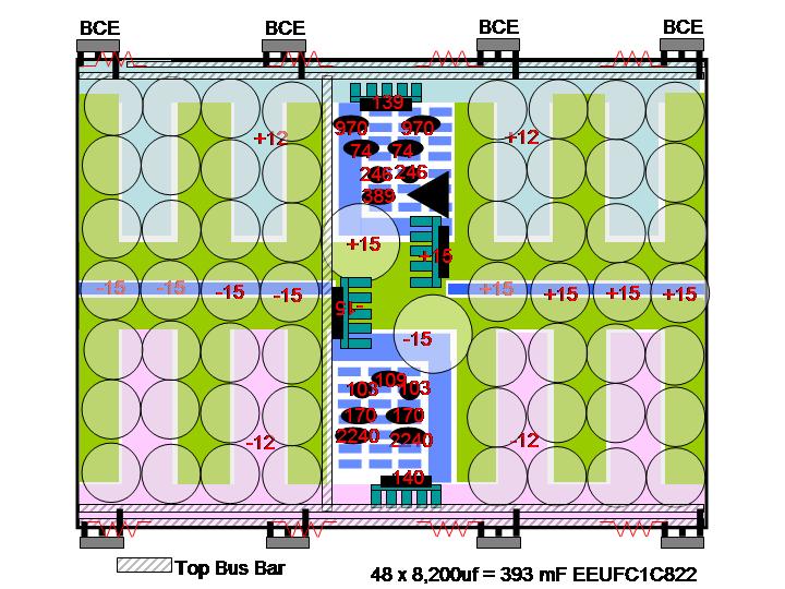

MACHINE SHOP PCB
Has anyone constructed a PCB for a power amp by gluing a thick sheet of copper to a fiberglass or Teflon substrate and running it through an XY router in a machine shop? The thick copper would allow mounting the power supply filter capacitors next to the output devices so the entire amp could be on one PCB. The tolerances seem fine for capacitors and transistors, but the 0.1” spaced thru-holes for opamps and D/A chips would be a challenge. A single layer PCB that uses resistors for jumpers and a couple bus bars to connect the NPN/PNP outputs together seems possible. It would also seem possible to build a “generic” PCB this way which could accommodate many circuit topologies.
The attached PCB sketch is for the 25W/1ohm design in this thread. The 8” x 6” PCB with over 400,000 uF would be mounted to a 12” x 12” heatsink.
Is 8 oz copper the thickest PCB copper? What DIY PCB fabs can produce 8 oz copper or thicker PCBs? A two sided 4 oz copper would likely be the standard alternative.

Personally I would increase the supply from +/- 12 to +/- 15 (Vdc).
btw. For high frequency stuff they are using metal-base boards where
you grow or machine copper as thick as you like and even use for mounting
the semis. Expensive but nice.
/ Mattias

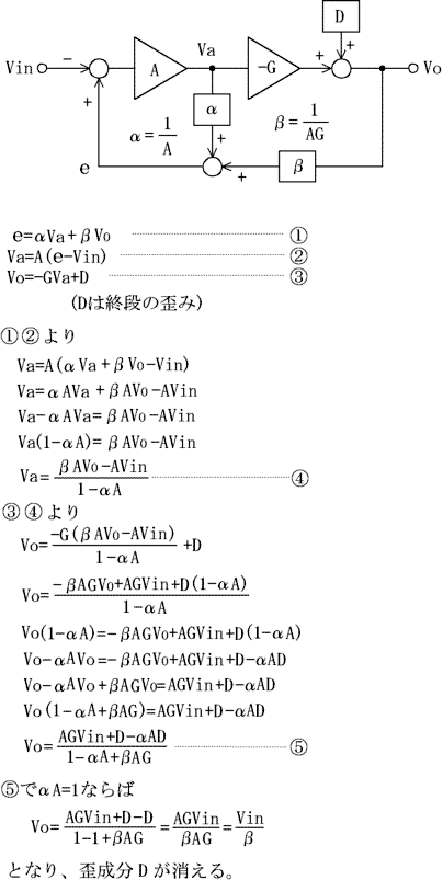

thanh said:
oh! I can't ...
...Perhaps it is a good techique which every forgot :)
you're in great company thanh,
Mason (inventor of "signal flow graphs") analyzed "zero sensitivity" amplifier topologies like this with his new tool but despite generating quite some interest at the time the "infinite" gain from the inner positive feedback loop has remained largely unusable
Horowitz used Bode's phase integral relation to show the limitations of this approach in "Synthesis of Feedback Systems" (1963)
Someone seems to reinvent this technique every few decades since the arithmetic is so inviting - but the fact of the matter is that phase shift is unavoidable and what you really get is at best a (very narrow) gain peak at one frequency
