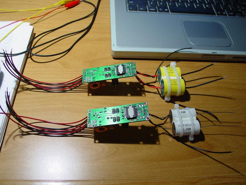

serengetiplains said:Brian, hang in there with the Sonicaps to give them more time. I've read good reports on these caps, and I see no reason why they shouldn't perform well. 50 hours might be short of what these caps require to break in. I know my own experience, for instance, with Chris Venhaus oil caps suggests some caps need of the order of a couple hundred hours.
Ok. My sonicap amp and Fostex FE103Es have been running for at least 3 days straight since my last post, so tack on at least 80 hours to the burn in time (up to around 130-150 hours or so by now). Either my ears are adjusting to the sound, the caps are breaking in, the amp is breaking in, or the FE103Es are breaking in (or some combination of those), but things are starting to sound damn good. Particularly acoustic music and vocals. Imaging still sounds the same as it has from the start - superb with this amp and speaker combo. I'll have to switch back soon and see if my ears really have adjusted or not. Either way, I'm no longer that bummed about the sonicaps
BWRX said:Either way, I'm no longer that bummed about the sonicaps
That's good news, Brian. Let us know what happens when you switch to another cap and back again. The Sonicaps are not too big and not too expensive. It would be nice if they do sound good, after all.

irss said:I thought NO wires should be left when soldering new caps. however, considering your last post I understood that the caps should look like this in this picture (?)
Ideally you'd want to shorten the leads as much as possible. However, I left the full length of the leads on those caps in the photo because I'm just testing them right now. If I shortened the leads as much as possible then I probably wouldn't be able to use them with anything else if I ever want to sometime down the road. A pair of those caps cost as much as the amp3 kit so I'm definitely going to get my use out of them one way or another
Yes, Brian is correct. You can only get so close, because of the size of the caps. He left his leads long for testing.
