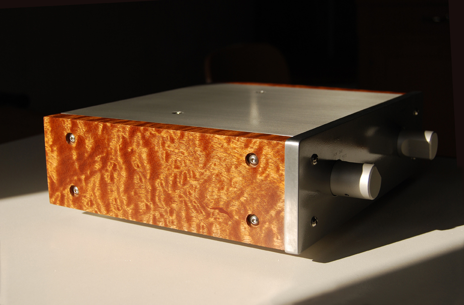

I've seen in many of your amplifiers/projects that you have chassis bolts going into wood. How does the threading hold in the wood? Is it a wood screw you use? Or do you insert a metal cylinder with threading inside into a hole in the wood? Specifically, how do you attach the wooden sides of the Patek Amp v2 (Image)? Any close up pictures? :)

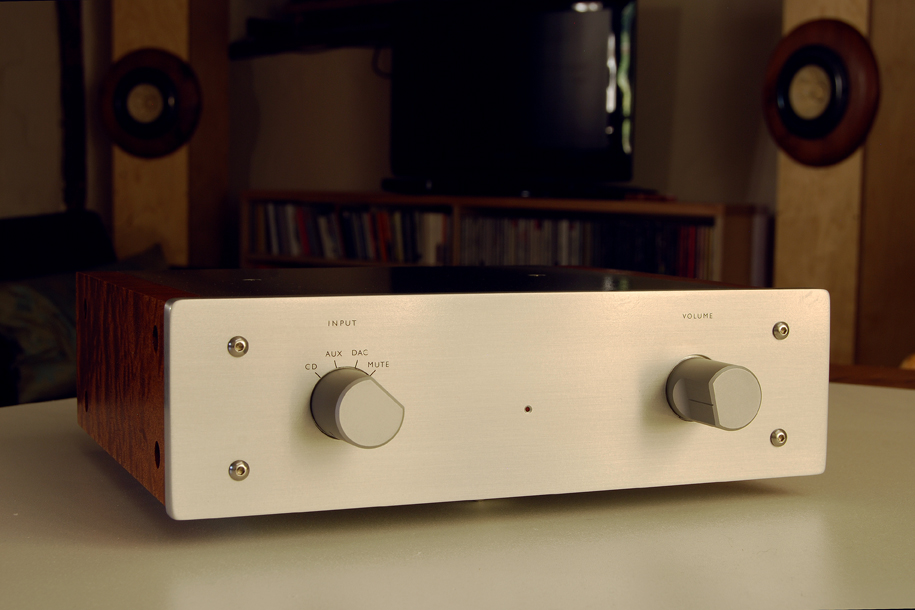

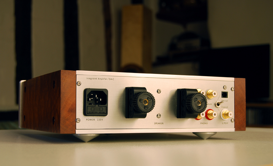

Some pics of the completed integrated LM3875 and premium NOS DAC. Pretty much identical to Peter's. I wanted to know what it sounded like. I made the chassis from scratch as it would have cost too much to post to the UK (would have been so much easier to have paid the money!)
Sound? I have had it running non stop for week to settle. Recently bought a Squeezebox Duet to stream WAVs to the integrated. This replaces a £1000 CDP with valve output and a SET I built specifically for my single driver speakers.
The Audio0Sector 3875/DAC is stunning. Actually it is the best sounding hifi that I have ever heard at any price! Effortless, open, deep but for me most importantly I have stopped analysing the sound. It sounds so natural and tangible that with the lights out I can be there. The walls and floor disappear.
Thanks and all credit goes to Peter for his superb design and professional helpful manner.
I am one happy customer!

Have his phonostage in there too?
Nice build, super clean like Peter's work.

Not got a schematic for the optical as I have done it here but Peter has one for the optical module. Mine amp prioritises the coax, which is wired direct to the DAC's input (as if it was the only S/PDIF) and the optical is wired into an on/on switch (using only 4 of the 6 poles). It can be switched on or "off" which basically cuts power by going to the empty part of the switch, enabling the coax to be heard.

I use machine screws in Patek (10-32). Before threading the wood, I soak the hole with crazy glue which adds durability.
In a DAC I use wood screws.

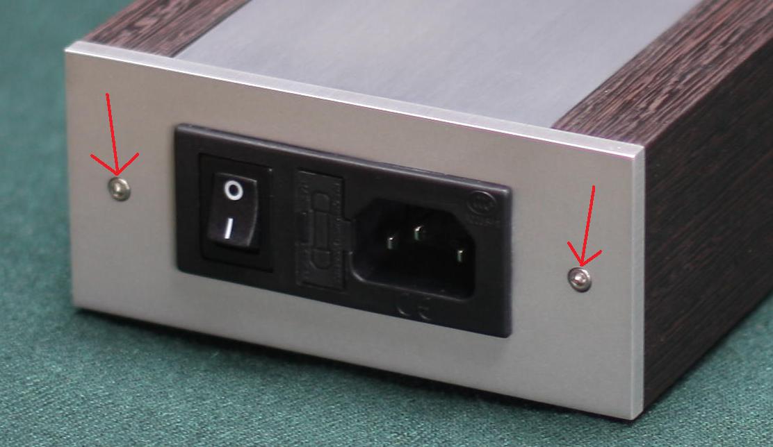

Peter, when you said "threading the wood", does it mean that you tapped the wood? I am particularly interested in how you fixed the two screws in the image attached here. The two screws in the image are wood screws? Or do you mean that you use wood screws at the side panel to attach the wood (not the ones shown by arrows in the attached pic)? I happen to you the same wood (wenge) for my chassis!
