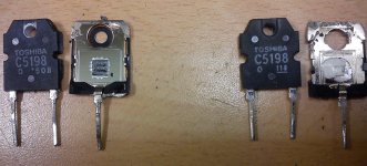

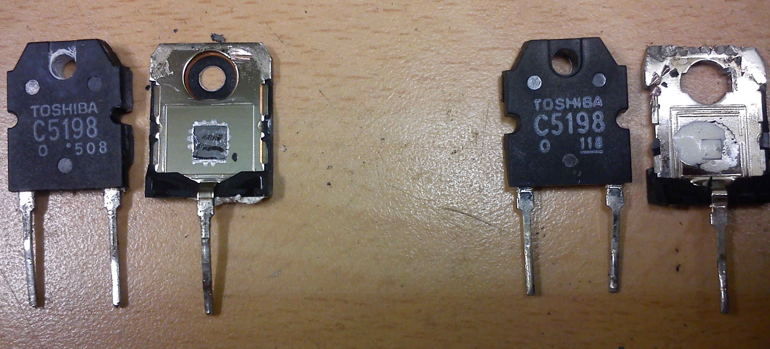

More fake 5198
I've just ordered 4 pairs of 1941/5198 from a reputable (so far!) supplier.
When fitted to the amp, the amp went DC and one of the new transistors went short.
I've cracked one of the new ones open, and compared it with a genuine toshiba.
Here is the result. Opinions??

- Are these 2SC5198 fake?
