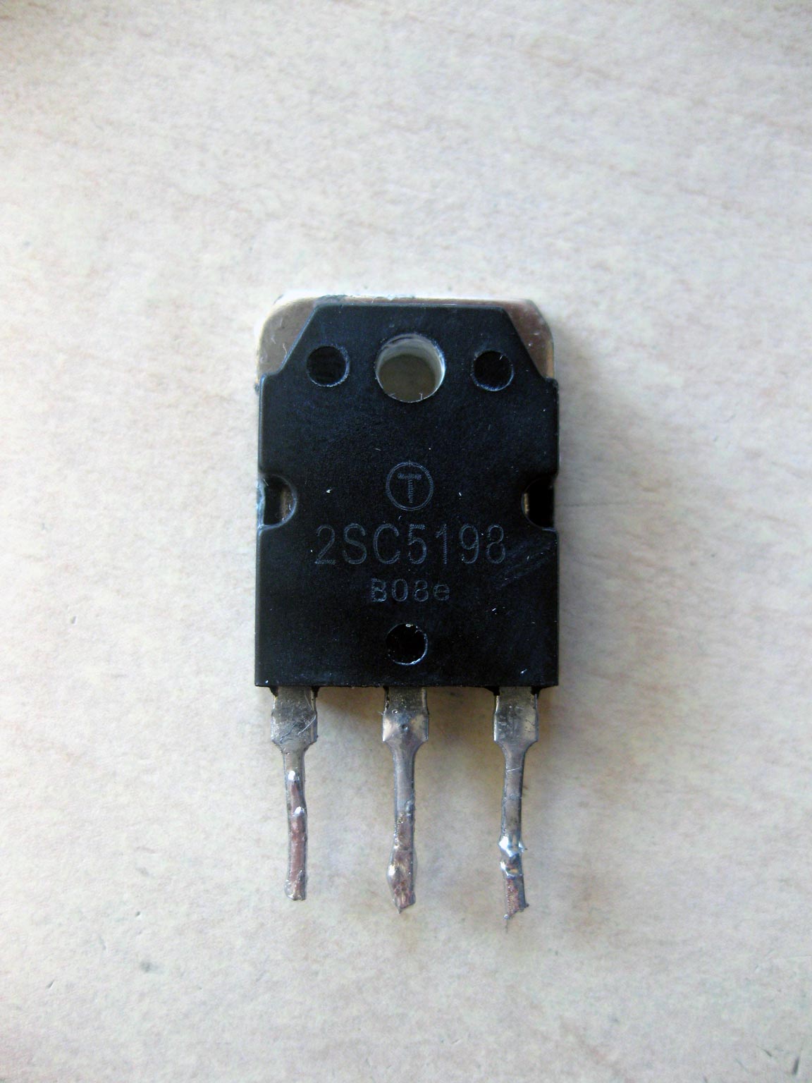

another question: i got one amp that someone already tried to repair. the output transistors were replaced by the ones on the photo. whats that brand? or are they just very bad toshiba fakes?

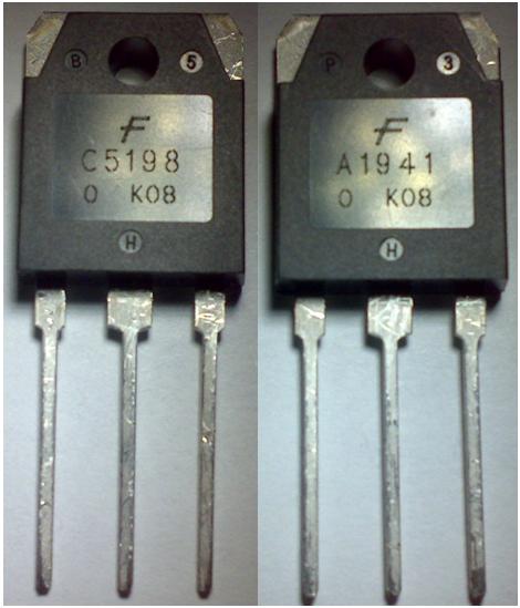

Are these 2SC5198/2SA1941(FAIRCHILD) fake?
Fairchild Response 2011-12-14 15:25:32
Mohsen,
Good morning. According to our cross reference tool, these part numbers are a cross. You will have to compare the datasheets to see if they are an exact replacement for the C5198 & A1941. We don't offer devices that use those part numbers but they do appear to cross with our FJA4310 and FJA4210. The orderable part numbers are FJA4310OTU and FJA4210OTU
Kevin Emmons
Fairchild Customer Support
WOULD YOU HELP ME ?!

Fairchild are politely telling you that they don't make those Toshiba part numbers, therefore you have fakes in your pic. and very stupid fakes for that reason.
I imagine the supply of genuine parts is very difficult for you, ACOUSTICS as I am advised that even local suppliers now supply fakes, knowingly or not.
No supplier is guaranteed apart from the manufacturer direct but international distributors with reputations to protect should otherwise be your first choice for supply of critical parts. There are no bargain prices that way but there are no bargains with genuine parts anyway.
