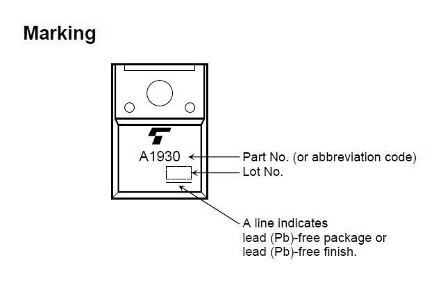

Pb is the symbol for lead. Pb free transistors do not have any lead used in their manufacture. Due to Occupational Health and Safety concerns the use of lead in certain countries has been banned.
As for whether the presence or lack of lead affects the performance of the transistors, the datasheets should be able to tell you that.
As a guess, I would say that likely the only place there will be lead present is on the tinning on the leads, in which case the difference will be the use of leaded, or lead free solder for the tinning.

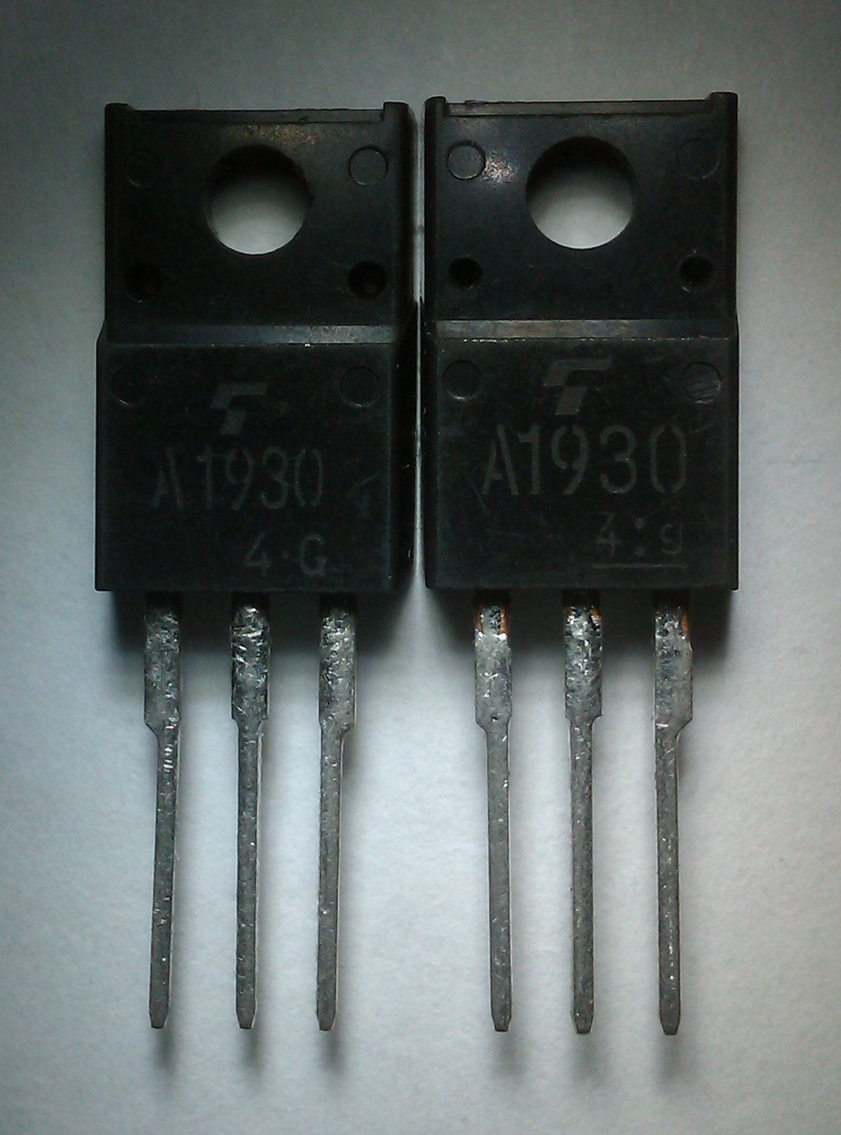

What is the differentes between Pb free transistors and non Pb free?
Ok, Pb free=Lead free

What is the differentes Specification between lead free transistors (Right 2SA1930) and non lead free (Left 2SA1930) ?what is the question?
Use normal forum fonts to type whole sentences please. Thanks.
I cannot see the manufacturer admitting to any specification differences between the two types.
I will throw in one of my own.
The lead free plating is not as universally amenable to easy and reliable soldering.
If that is an answer to your question, but I still can't truly understand what you ask.

Manufacturers are still changing their tinning processes from lead solder and clearing old stock. For example, On-Semi supply part numbers with a G suffix to denote Pb-free, whilst no suffix or A suffix may mean it still uses lead solder tinning. It is easy to read the manufacturer's data sheets to discover such details if you think they help you.
However, it seems you are trying to distinguish fakes with this detail. I think you are bound to have more difficulty with this than you can imagine since your suspicions may be correct or not, depending on the date, package and marking process of the actual manufacturing plant. Many Semiconductor manufacturers are globalized and use licensed production elsewhere so you cannot be certain whether your fakes are identical or very poor substitutes.
Some stocks, globally, are known to exceed 10 years from some sources so you can see that as the manufacturer changes his process and markings, you will need to become an expert historian to identify and predict fakes. Few of us here will ever see some Asian manufactured fakes so there will be limits to our help too.
In my limited experience, it is better to recognize the fonts and precision of markings and check your supplier's integrity and reputation "on the street" - not from official nonsense.
Again, your source's integrity is your only guarantee and you will not be any more satisfied if we can't confidently identify the markings on a particular part you have.
