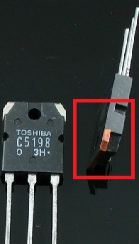

Picture on the Toshiba transistor is the real thing. Really see from the above side pipe is red or yellow. The use of OFC copper production.
Forged silver white.
Observe the color of copper.
The surface of the word white. There are also laser. They are correct.

Can you read the codes embossed in the dimples?
But don't post those codes here. Fakers would probably love you to death, if you told them what the real codes said.
Ask if any Member knows what valid codes to expect and keep that detailed info private.

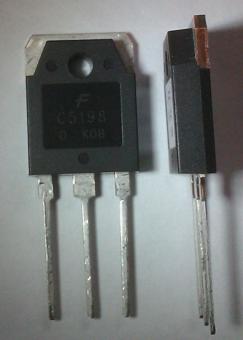

I think Fairchild already gave a clear answer that they never made those C5198/A1941 but ACOUSTICS doesn't want to accept that. :confused:
Edit: The genuine parts should look like these:

Hi ACOUSTICS
We can not see the marking of your transistors (#51) but they appear similar to your first posting. It is not possible to identify what you have, except you tell us they are 2SC5198/2SA1941 and they have suffix R or Y. Are they different to your first post? :confused:
You understand that these are OEM Toshiba part numbers and not currently supplied by other manufacturers. If you don't see official Toshiba trademarks, according to their PDF data sheets or Hi Tec's post (above), you don't have genuine parts. That is simple.
The laser etch panel (glossy area) is not specified and the only Hfe ranges offered are R and O. This does not seem correct either. This information is available for download on the Toshiba (semiconductor) Website. Read "marking"
http://www.toshiba.com/taec/components2/Datasheet_Sync/66/7886.pdf
