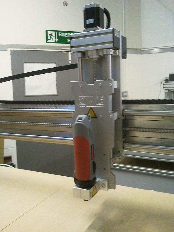

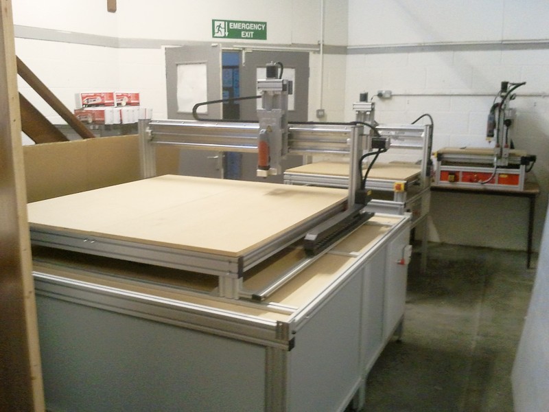

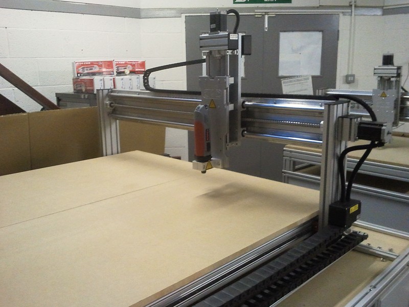

The cnc has been delayed because the control box still needs wiring and then testing. Its now going to be sometime next week. Shame, I was looking forward to playing.
They've sent a few more images which shows the machine is pretty much complete.
attachment.php
attachment.php
attachment.php

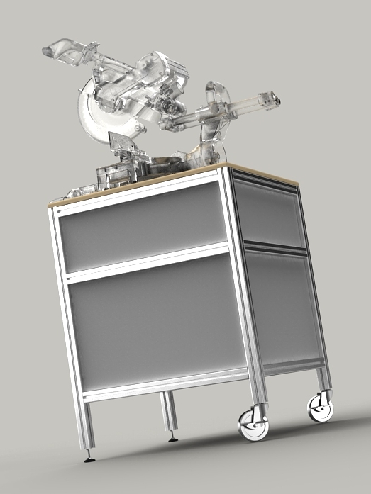

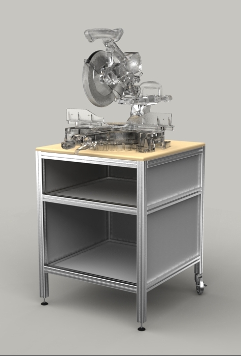

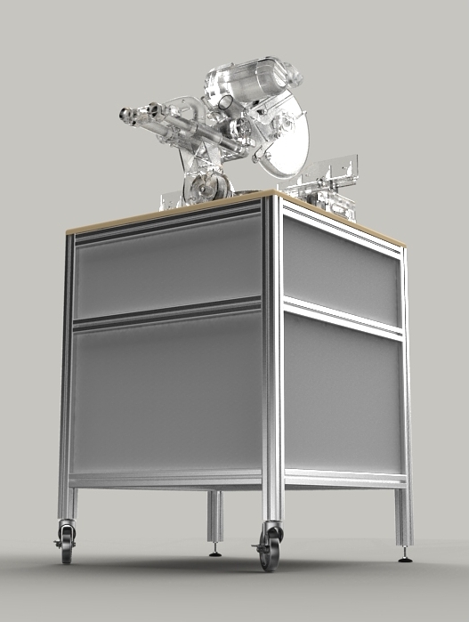

I've also designed a simple mitre saw trolley constructed out of 40x40mm alu extrusion. Should be an easy but very sturdy build. The whole thing is on casters too because with a small workspace its important to keep things flexible for when you need that little extra room.
Parts sourced from these guys: Valuframe - Aluminium Extrusions > Aluminium Profile > Aluminium Extrusion > Aluminium Profiles >Aluminium Profile Systems
attachment.php
attachment.php
attachment.php

Sorry to hear the machine is delayed. Looking good though. Well, the machine looks good. You'd think with that level of tech they'd be able to afford a decent camera to take pics to send to customers :D.
Trolley looks good - and thanks for the link - I've been looking for a decent supplier of extrusion material. Are the prices ok?
Thanks. Oh and I blame those damn smart phones, the camera's in the lot of them are junk :D
From the few places I found online they were the cheapest. You have to sign up on their website to get the price list and catalogue. There's a lot of stuff in there but to give you an idea the 40x40mm is £8.55+VAT per meter and the 80x80mm is £28.59+VAT/m. They'll cut the stuff to length(£0.99-£2.95 a cut) and even tap holes(£2.34 a go) although this is expensive if your having more than a few cuts done and would work out much cheaper if you do it yourself.
