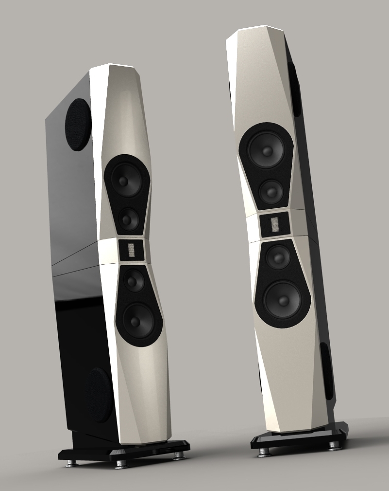

This thread is a place to put images, ramblings and other such bits into some that will loosely resemble an attempt to document the latest(and largest) design from me to date. This is truly a statement speaker standing a statuesque 205cm tall with a considerable 75cm depth and utilising no less than 9 drivers per side. I live to build speakers like this :D
A quick note to say these are being built for a forum member here - Ackcheng. Many thanks to him for his suggestion to share all this here. Arthurs initial goal was simple - take the LGT and add a separate subwoofer tower to each side to increase the low end. Whilst that would have worked fine it did seem like a missed opportunity to create something significantly better and so came about the Apollo.
Details
In a nutshell the Apollo is a 4way design borrowing heavily from the LGT but with improvements made on every level.
I particularly wanted to address the large center to center spacing of the LGT which was caused by the lengthy RAAL 140-15 ribbon tweeter and to a lesser extent, cabinet design considerations. This has now been greatly reduced by using the much shorter RAAL 70-20XR and tightening up the cabinets. The end result allows for a tighter MTM arrangement.
Other improvements include 5" drivers utilising a midrange specific surround profile along with custom designed 8" to give maximum impact in the mid bass region.
Perhaps the biggest departure from the LGT is the inclusion of four Audiotechnology 10" subs with Sandwich Cone which will give a cone area well in excess of an 18" driver. No doubt the low frequency extension and impact will be considerable! These 10" drivers are arranged in an opposing push-push arrangement, two in the top and two in the bottom cabinets. By directly coupling the mounting arrangements on each driver it'll take full advantage of Newtons third law causing the forces from each driver to cancel.

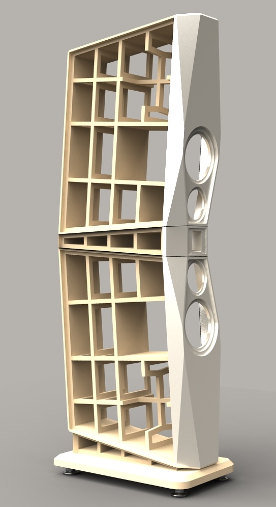

The cabinet are to be constructed from MDF and Corian. Various combinations and laminations of 18mm and 9mm MDF will be used for the cabinets. And 84mm(7x12mm) thick Corian for the baffles. Corian was chosen for its ideal damping and stiffness properties that will create an excellent mounting point for drivers working from 80hz and upwards. Unfortunately its expensive and so moisture resistant(aka Extira) MDF will be used for the cabinet sections.
As the project progress construction details will be revealed in greater detail.
Finishing will be gloss black cabinet portions with polished corian baffles(kind of like polished marble)

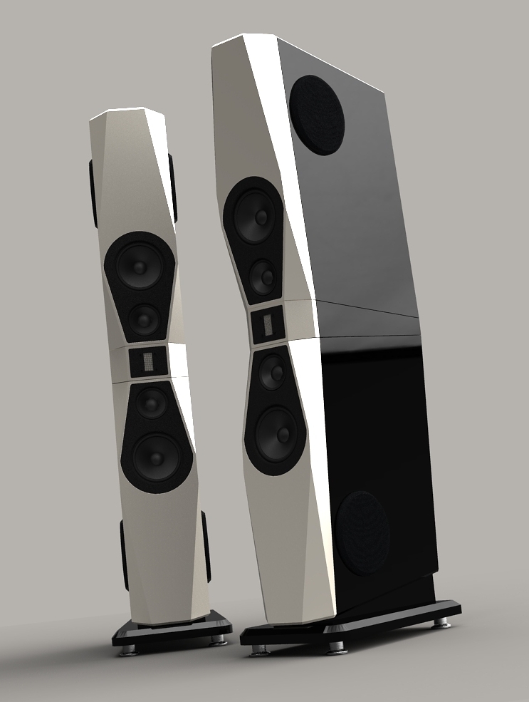

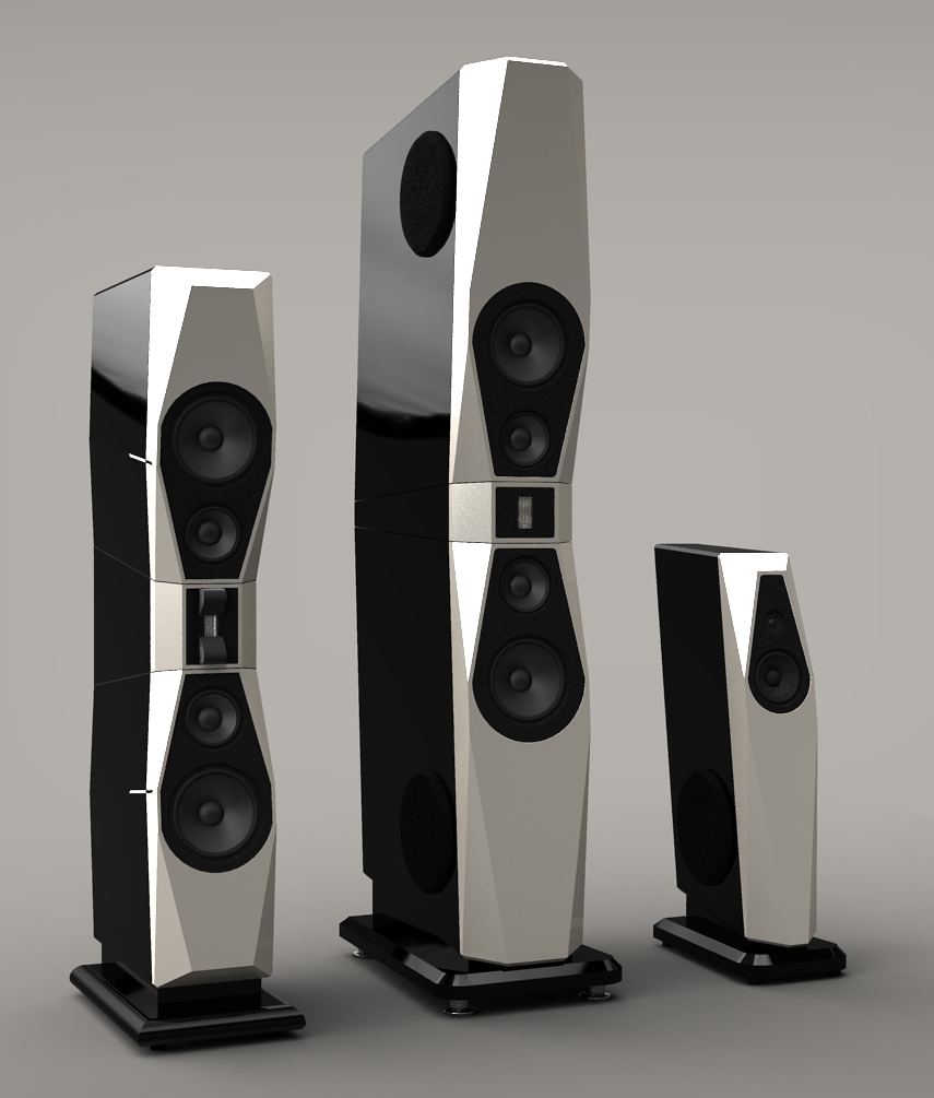

For now its early stage renders but I'll be pressing ahead at full speed with these in January. The overall size and shape is determined but a detailed model is in the works so between now and January there'll be more renders as its fleshed out.
attachment.php
attachment.php
Apollo vs. Aurora and LGT.

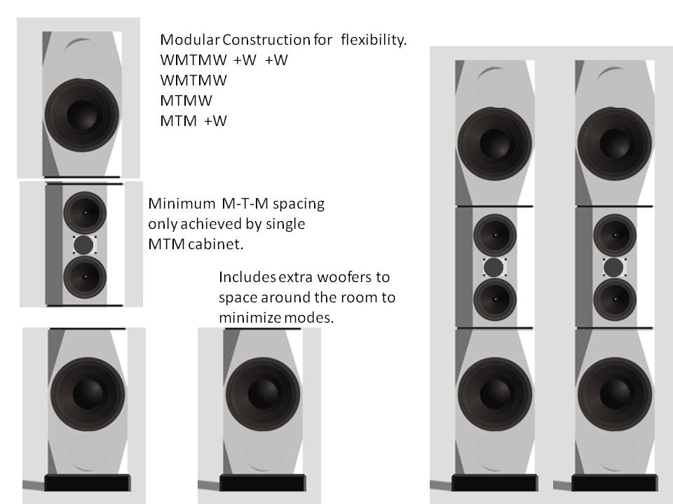

I always work to minimize the M-T-M physical spacing to reduce lobbing, and even cut off portions of the faceplate on a small diameter tweeter like the SB29RDCN toward this min-separation goal.
Have you considered a different modularity strategy with separate Woofer cabinets and separate MTM cabinets that can be stacked to create several different configurations and room multi-woofer placement options? This might provide both superior sound and a more flexible product line.

LineSource is right Shin. A modular design like this would not only fill a gap in the market but also be achieveable with minimum compromise using a pc xover. Commercial may be a thought for the future, but going the modular route gets the initial R&D costs out the way while it's still a hobby & you could bring start with the MTM & bring the other parts to market at your own pace. Sub contract the manufacturing & concentrate on fit, finnish & setup.

Thanks for the suggestions. The modular route is something I've played around with in the past and will no doubt do so again in the future.
This particular project is pretty much bespoke but for the more realistically sized speakers its definitely worth looking at again. Its a good challenge to get all the individual components within a modular system designed well on all levels and both with each other and as separates. Once you've found that however I agree its very appealing.

There's no constrained layer approach but I do use 9mm + 18mm laminations for the walls and then further line the interior walls with 2mm lead sheet and 2mm bitumen. This along with fairly extensive bracing gives a significantly resonant free cabinet.
The baffles are Corian which is basically a composite of 1/3 acrylic mixed with 2/3 bauksite and then heated together. Its a superb material for loudspeaker applications but is expensive and difficult to machine.
