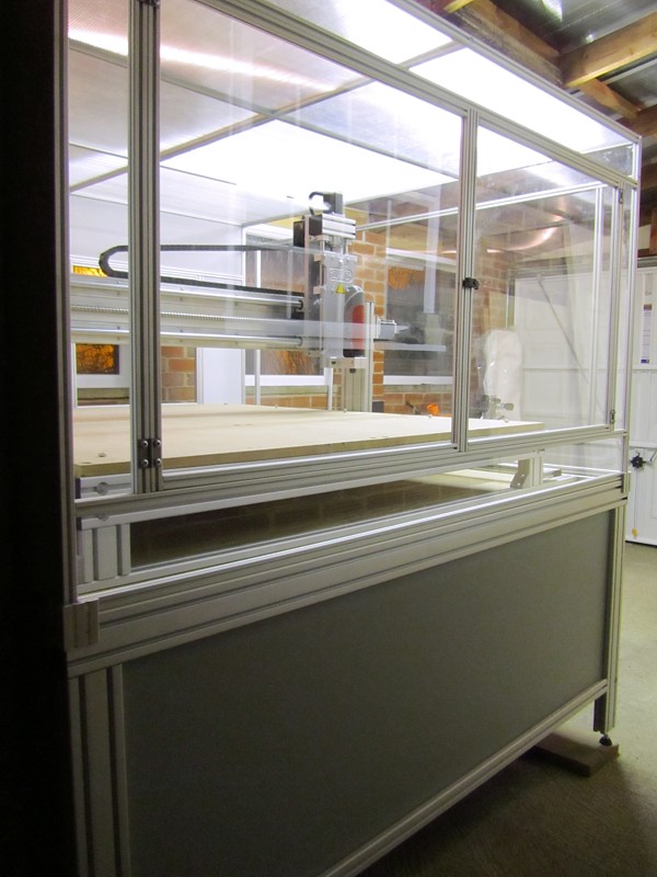

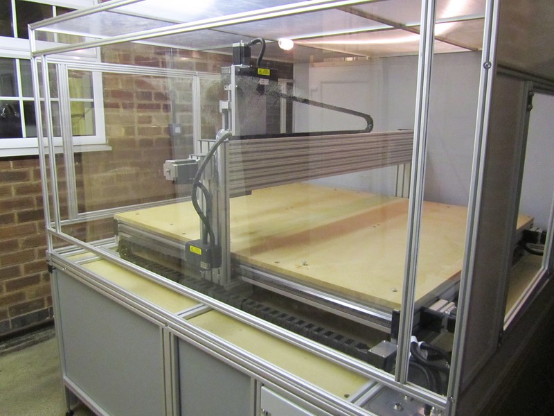

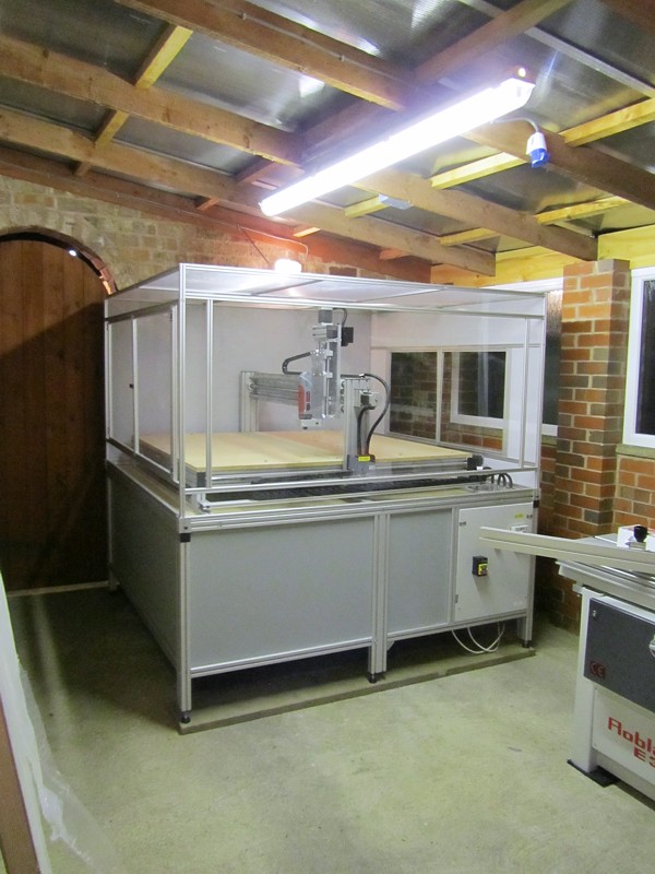

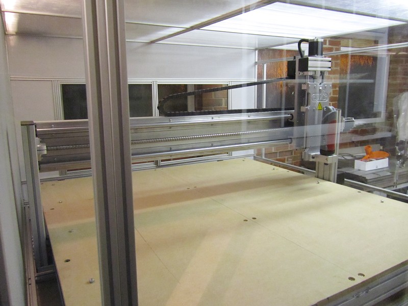

Its arrived!
I can tell you it wasn't fun getting it off the lorry and into position. I had a couple of mates around to give a hand and the 3 of us thought we'd try to lift the whole thing. Wrong! It weighs around half a ton and quickly abandoned that idea. In the end we had to break it down into 3 sections for us to be able to comfortably man handle it off the lorry and into position. We tackled it by removing the router from the base and discovered this was by far where the bulk of the weight was. Once that lump was gone the base was pretty light although a bit awkward to manoeuvre because of the size. Before attaching the router back on to the base we spent a lot of time levelling in all directions as the floor does slope a little. Once that was done we bolted the router back on. Last part was the top enclosure and carrying this around wasn't too bad but getting it back on the machine was a right pain in the backside. The low ceiling in the workshop and tall gantry made it impossible and after some head scratching and a fair bit of swearing we dismantled it and then re-assembled on the machine. Ugh, never want to do that again.
By the time we'd done it was 9pm and way too late to start taking it for a test drive. Its going to be the weekend now before I have time and its going to kill me to wait. At least its setup ready to go now anyway.
A few of issues:
Aside from those. First impressions are positive. The build is sturdy and the photo's don't do it justice at all. I've tried to shake the gantry and there's no play or flex whatsoever. Very well put together and polished package. If I can sort the bits above I'll be 100% happy.
A few of issues:

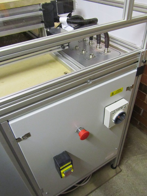

- The hand controller was missing but Michael at Strike quickly realised and said this would be in the post ASAP.
- They haven't threaded the power cord for the spindle through all the cable chains which means that's a job for me but I'm unsure how to wire the spindle into the control panel. I guess in the rush to get this out to me they missed that job.(I have been pretty impatient and emailing them asking for updates every week for the past couple of months)
- The e-stop button on electronics housing is broken, the whole switch sorta fell out after I pushed it! I did manage to get it back on but its clearly not well. There's a second e-stop on a long cable that works fine however.

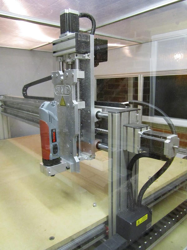

- There appears to be some play in the z-axis when grasping the spindle and gently pulling it back and forth. I'm going to have a closer look at this as I'm not sure if its on the z-axis or the x. I suspect its on the z but I was tired after all the lifting so didn't look into it too much. The Y axis(one with hiwin rails) is spot on and doesn't budge at all. Unsure if the bearing blocks can be adjust to eliminate or reduce this. Will email Strike.
- The parallel cable is annoyingly short and I'm going to have to have my PC right next to the machine. A small gripe for sure and probably easily fixed with extension cable unless long cable runs are an issue(approx 3-4meter)
Looks good.
You want the parallel cable to be as short as practical.
I'm using a laptop, and it hasn't been an issue, but laptops can be problematic. If you have issues, use a desktop PC.
Thanks Mark. If shorter is more reliable I'll have to figure out a way to move the PC closer. Its a desktop rather than a laptop.

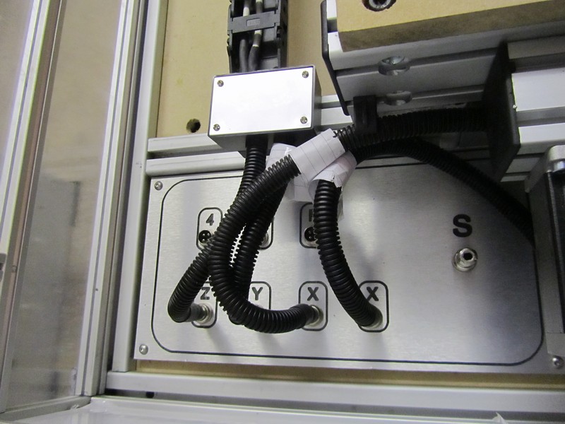

Wiring the spindle into the control panel: The socket marked 'S' on picture 9? I'm assuming yours is controlled by the electronics. On mine, the router is powered externally, so you have to switch it on/off yourself (and there's obviously no speed/direction control via the controller software as it's a standard router). Assuming you can turn the router on yourself it's OK - at least to start doing that until you can get a fix.
Looks very good overall. Though you now realise how small your workspace is by comparison

Looks great! Yeah, machinery moving is a pain.
You definitely want to eliminate any movement of the spindle. One possibility is that without power, the steppers are allowing some movement. They lock up when you apply power. Bearing blocks like those are typically not adjustable without removing all the balls and fitting larger diameter ones. You don't want to get into that...
They suggested it might be that one or two of the bolts could have worked loose during the two days they tested with a dry run cycle. I've looked over the bolts I can get to and everything appears tight.
To my untrained eye's the movement is occurring on x axis(one that moves across the gantry). These have a small grub screw like adjustment which dictates how tight it is on the rail. Problem is you have to partially dismantle the z axis to get to them.
This isn't something I'm comfortable doing and especially putting it back together accurately so they're sending out an engineer to look at it next week sometime.
I'm going to hold off cutting anything until that's done.

I've had the cnc moving around this evening and it felt good! Then I did something spectacularly dumb
It started off fairly innocently with me gently jogging the machine around at 1000mm/m but that quickly got boring so I tried upping the speeds. Now I asked StrikeCNC to set the stepping rate to the most accurate end of the scale and this reduces speed because current is reduced to the motors. Anyway undeterred I started increasing the speeds on the Y axis in increments of 500mm/m until I hit 5000mm/m and it stalled. OK backed it down to 4000mm/m to be safe and all was good. Then I assumed(yep that word) all the other axis would be happy with the same setting so did the Z and tested, yep worked fine then came the X... and things kinda went south.
Now the X has dual motors to give constant tension when travelling in that direction. You can probably guess what's coming up. At the higher speed setting one motor stalled and the other kept moving which knocked the gantry out of square with the table
Now comes the part where you say "That was a bit daft"
I'm sure StrikeCNC are gonna love me when I tell them I just cocked up 2 days of testing and alignment.
I'm gonna try correcting it myself by moving the gantry to the edge of the bed and then for each side use a digital calliper against the gantry upright and the corner of the bed. I can then step one motor at a time until the distances at both sides are equal. I can't think of another method that would be as accurate but maybe someone has a better method?
Apart from that hickup its looking good. I can't wait to start cutting stuff but there's an annoying list of to do's before that can happen. Oh and out of the box Mach 3 has one of the ugliest UI's I've seen. I feel a screenset change coming on.

Ok, my CNC works a bit differently.
There is a bit of flex in the gantry with the motors off. There are two home switches, one on each side, one is adjustable.
Mach3 will home the axes separately (but moving together). As long as the switches are setup to be square, the motors will hold the axis square.
To check, cut a big square, and measure diagonals. As I only have a 150mm pair of vernier calipers, I did a 140ish square across the diagonal.
Mine is 0.2% off. Good enough for me. I need a much bigger vernier to get it better.
Unless someone else has a better trick?

To add to what I posted last night about home switches, it is a really good idea to have limit switches as well. It's not completely necessary (I currently don't have mine setup to stop my machine), but it's a good idea. For example, I used to have an intermittent electrical problem caused by my PC. This would sometimes result in the motors not turning even though Mach thought they were. One time this caused my Z to not raise after a cut. It did this several times, cutting lower and lower each time. Finally it plunged through my spoil board into one of the aluminum rails of my bed, carving a fair size swath through the rail with a 1/2" solid carbide bit before the router pulled too much current and tripped the power strip the entire machine was plugged into, shutting down everything. If I had a limit switch on the Z axis, this would not have happened. The limit switch would have tripped and the machine would have stopped. I was running the machine unattended, but on long jobs that will become a temptation. I know if you don't have these currently it could be tough to add them, but it's worth thinking about. I'm surprised a commercial machine doesn't have them to be honest.
I have limit switches on everything but -Z.
So they wouldn't have helped with a similar error to yours.
A -Z limit switch needs to be adjustable, or it will either be annoying, or useless.
Mach3 is smart enough to use the limit switches as home switches, they don't need to be duplicated. In fact they can all be tied together (series or parallel), and it will reference one axis at a time.
Strike have been in touch after I sent them a video whilst I was trying to figure out where the play in the Z axis was coming from.
They've taken a look and have decided to replace the whole gantry and Z axis at no cost.
-Build a complete new gantry. They’re uprating the extrusion sizes to 160x40mm uprights and 160x40 backplate for the gantry.

I judge a company on how they handle problems and all credit to Strike here. They're very on the ball when it comes to customer service and problem solving.
