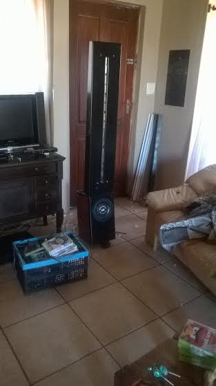

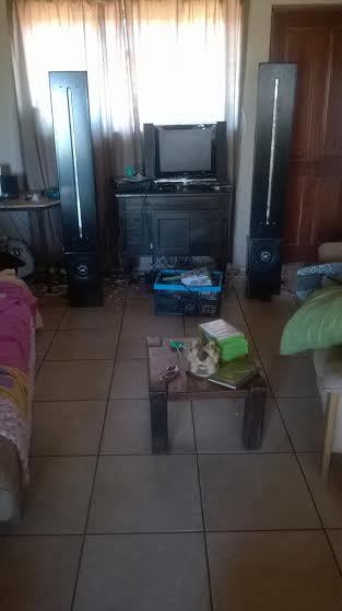

Hi All, would you classify this is a point source or a line source now as the ribbon is not directly under the Bass driver. I currently build a similar speaker to this but the ribbon sits in line with the centre of the bass driver perhaps I should move the ribbon slightly inside to where Peter has put his ribbon? I believe Apogee,s thinking with the point source was to keep the driver away from the floor to not encourage floor reflections. Soul sonic beat speakers have a line source method but the driver is angled substantial upwards.After considerable modding, evaluating etc all in an effort to improve on the stodgy overstuffed bass performance of my long lived Centaurs, I built a new 1.3 cu ft ported cabinet and a new baffle with ribbon faceplate made from solid cherry and rehoused the original drivers. What a difference!
My listening room is fairly small(15' x 13' or so with sloped ceiling) and I have never had success trying to blend a subwoofer into any speaker in this room. Now I don't need one.
The bass is more relaxed, very deep and dynamic with dual Symasym amps located in the original Centaur stands. Now crossing over at 500Hz LR4 with a minidsp. These are again my reference for my speaker building hobby. Over the past couple of years, I have had(and still have them), Royds, Frugalhorns, ZD5, 8" vifa/xt25 waveguide concoction using this same cabinet all in an attempt to build a satisfactory replacement for the Apogees. The waveguide came closest and I am currently building a TMM waveguide using 6.5" peerless nomex woofers with the xt25.
After living with the transparency of the ribbons for 22 years, it may be nigh impossible to find a suitable alternative.

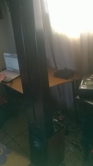

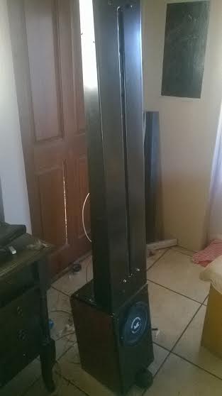

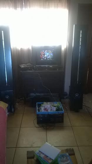

Hi Bill, yes its certainly an interesting question I am going to try and simulate the offset ribbon shortly. I experimented today with the Soul sonic Beat angled bass driver and upright ribbon and can say that it sounds incredible really detailed in the midrange and not smeared by the bass. I know Miro the manufacturer of Soul Sonic speakers has literally built hundreds of speakers and if that is his answer to a 2 way ribbon hybrid you better believe there is valid reason in theory behind this design. I have attached a few images of what the angle I used.

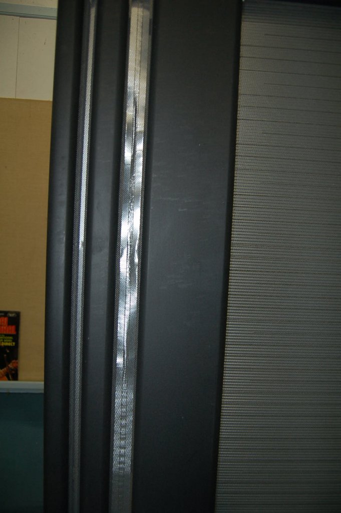

Hi my ribbons are crossed at 360hz iv got little movement on the ribbons i use a 3rd order xo and I attach my ribbons every 140mm to a soft rubber glued with 3m 90 adhesive. IV built many ribbon prototype,s and this I find works the best. ThanksHi Africa
What is the crossover point for the ribbon?
Dose your ribbon move, twist?
Apogee did use a suspension peace for some of there ribbons.

Do you fell you lose any output from the ribbon with your 3m attachment of the ribbon?
