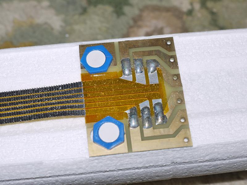

looking at the pic...the graz replacement ribbon....look like he has added risers.....at the monting holes....there blue....look to me like even if you put the bars back in.. on his ribbon....the bars would not hit the ribbon,just the blue small risers....the stock Apogee ribbons don't have any risers...the bars set right on the ribbons...........an add the mass....

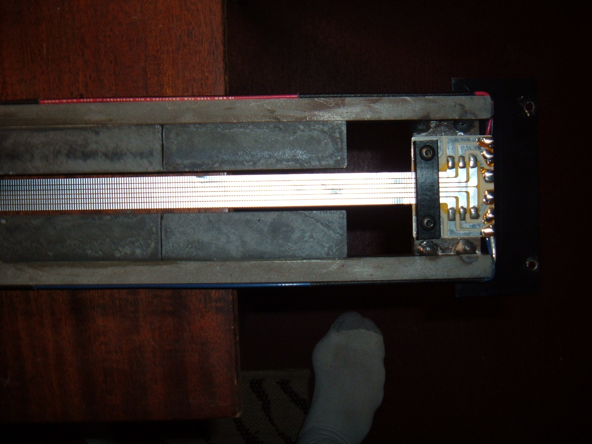

Thanks for any an all input on these old ribbons I have owen from the 1990s..
"They just make the effective ribbon length a little bit shorter , apx 1 % and maybe the ribbon is suspended with a well" ...
Say what you well.....doset take much to add mass to a ribbon....!

Sorry , no added mass. The ribs are clamped under the bar. Ribbon mass comes from aluminium, capton, and bonding glue. Thats all.
So the effective ribbon mass is exactly this length between the bars, so in fact it is lesser mass since the ribbon is shorter thus . The bar does not move, nor do the screws or the ribbon behind the bar.
Thats physic and geometry. Nothing else.

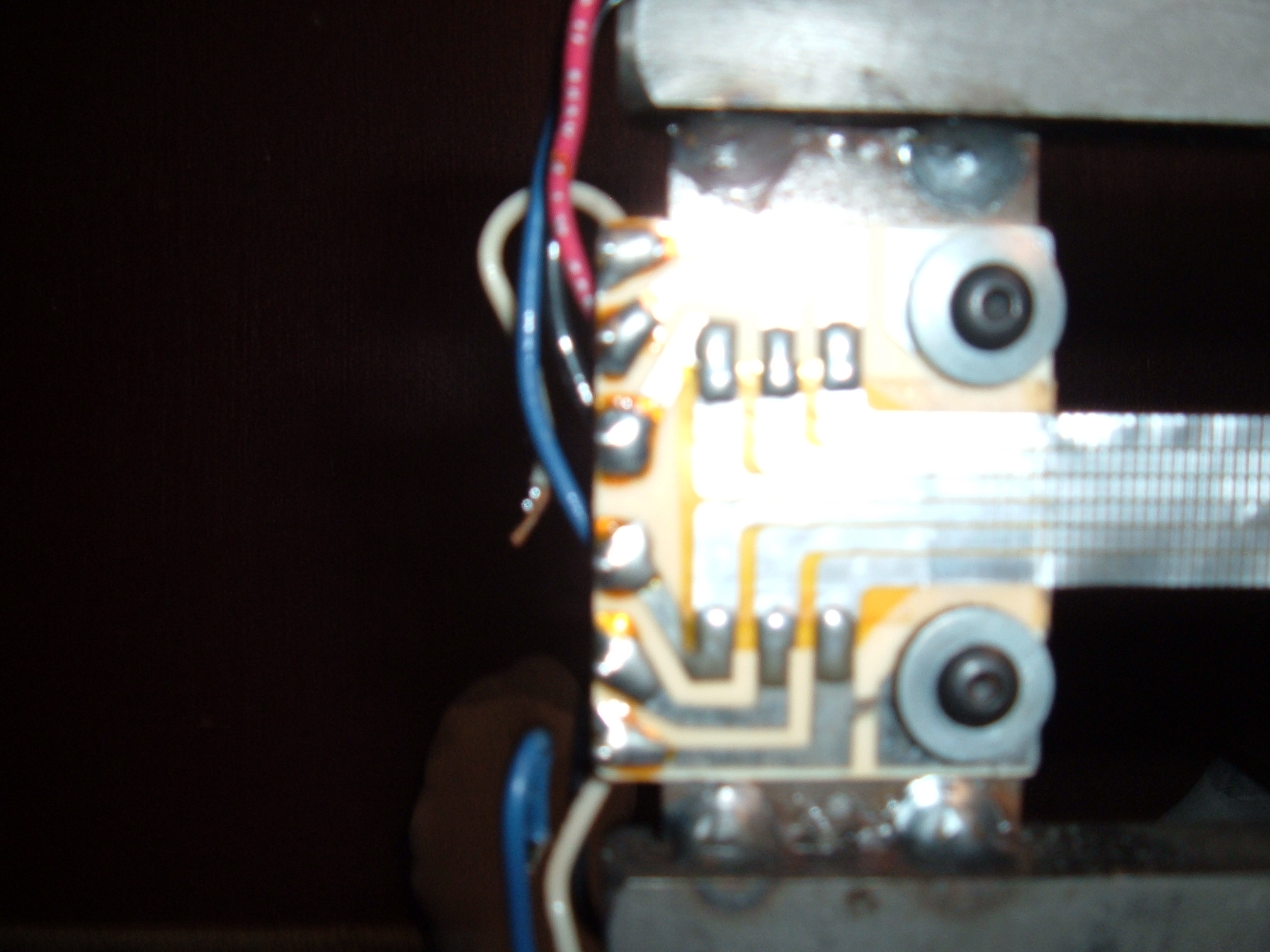

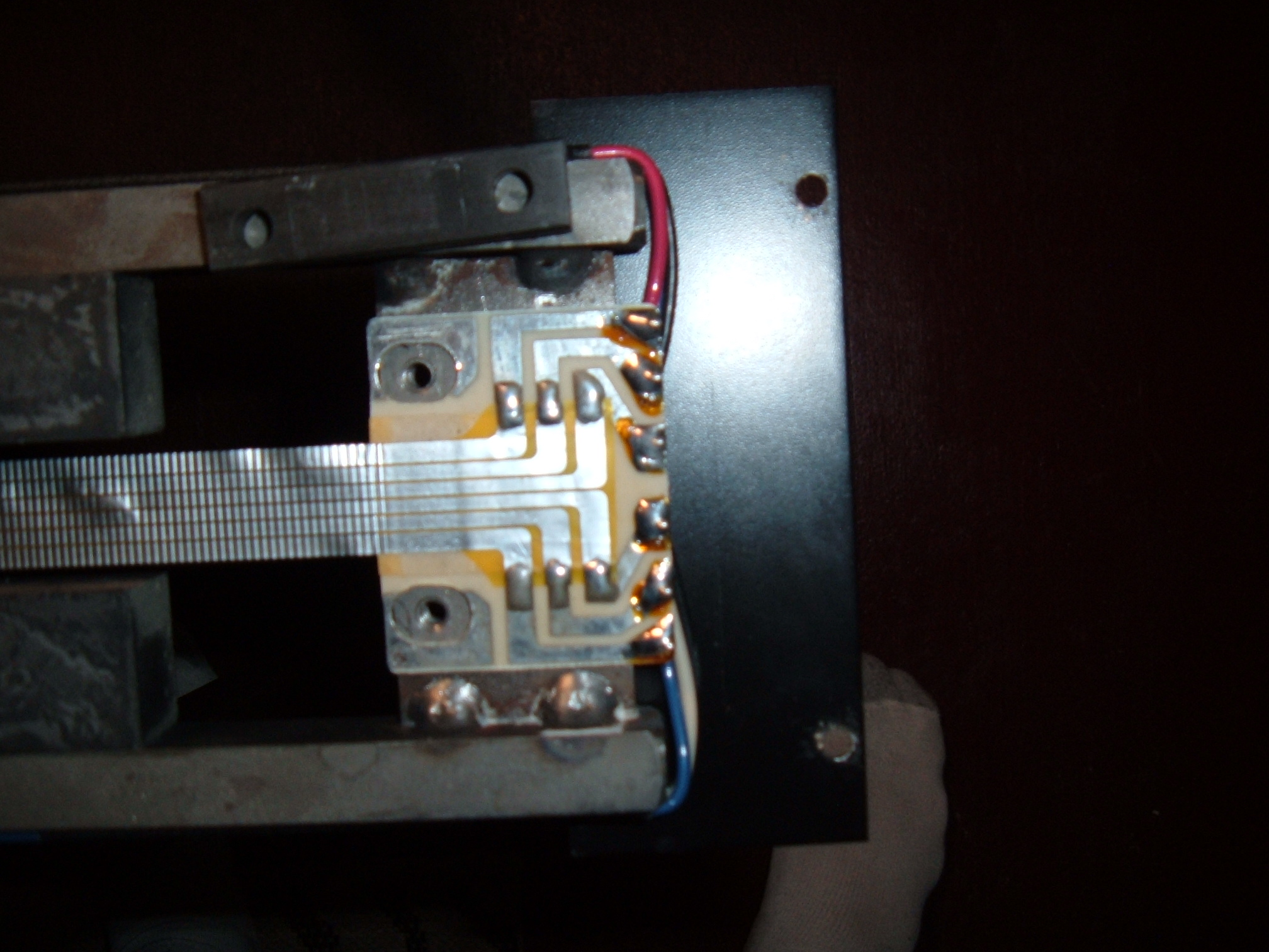

So you are saying there just mass being added to the end fiberglass mont by the bars.......?...
pic 3.... the bar is not hiting... the free hanging part of the ribbon........... just the fiberglass mont.....there for no mass would be added to the ribbon .............!.....
My way of thinking was.... that becase the aluminum foil of the ribbon runs under the bars.....the bars mass would be added to the ribbons output... it sounds that way....to me becase it makes the sound darker....
So Garz is adding mass to the ribbons monts only... ... with the metal washers an what look like a clear rubber washer............with only the yello capton gluded over the top of the aluminum ribbon........
I well say to my ears I would never use the bars......Garz way of monting sound way better.....So with Garz new 26" $400.US pr of ribbons... your not just getting new ribbons...just the monting chang alone gives better sound......wish getting rit of the bars on my old stages stock ribbons... was sas ezey to do .....with out the cost!

The moved mass is exactly between the bars or with Graz Kit between the epoxy boards,where the yellow capton ends, just the free hanging ribbon.
All other is mounting mass and has no influence.
I never made listening tests bar versus Graz Kit, but it can be possible that the bars create some damping. Up to your ears.
But Graz ribs sound better than original stock, the difference comes from the glue between ribbon and capton which have different properties.
And the kit is way more elegant to install.

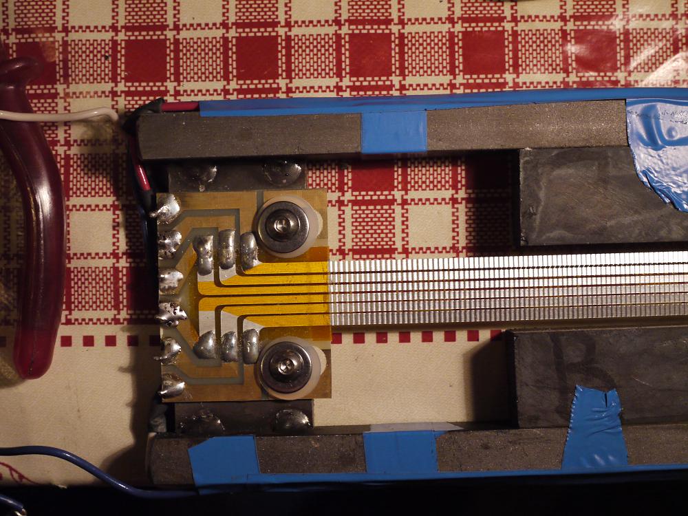

All I can say ..........is the removel of the bars..........SHocking!
like my friend said............what the hell is this.........
My rule on speakers....has been....if a speaker is 4' tall...the image hight my go to 6'...............6' tall mabe 8-9'.................but these 4'Minors.......now can have a 8'image with out these stock Bars Apogee used on these 26" ribbons.....
I don't like the sound of the stages are the Minors on there....what I say was a after thought...................Stands....to my ears it pull the meat off the bone..
makes there sound then....on the floor thay sound just right....Now with the ....Garz work on the replacement ribbons...an the removel of the bars to mont the ribbons.....just that own it own...........make the sound of a totly diff speaker!
So what would I say the sound inporovement is to this Mod.......Full Extension ....from 800-1000hz up................smooth as silk to the ear!
The sound I always though.....a free hanging driver.. with surface area of at lest 20 1"tweeters ..................would have....!
Only sound I have ever heard...........as if not better than that ESLs..
My Stages can even get close to this sound...an well not even be played till I get the new ribbons!
I must say ...if not for this post I may have ever done this Mod................thanks to all... an bill for his money well spent on the Garz replacement ribbon..........

Graz's new replacement kit just makes the ribbons easier to install, there's nothing wrong with the old system with the bars, just a tad fussy working with the ribbon and returns

pic1.........new ribbon....see the blue rizers..... to keep the added pressure... from being added too the foil ribbon driver ..
pic2..... stock ribbon from the Minors.....you see no rizers....High monting pressure on the old stock foil of the ribbon......what I was calling added mass..........an well chang the sound!...........
Now the stock Stages ribbon has a diff setp.....but with the same bars.....the ribbon foil...it self with the capton.... has the pressure added ....so the newer type ribbon well sound way diff.............for the better I think!
One thing I hope some of use.... have learned.......... in high end audio......these small things can make a BIG diff in sound............
An putting pressure on top of ...........Feather Lite foil voice coils....well chang the sound!
tyu, dunno where you get your info, but my new kit has no riser to raise the ribbon nor dampen it, truth is the orginal bar location places the ribbon about .040 closer to the front off centre of magnetic gap, I was going to fix that, BUT Graz says to leave as is, as they were built that way, so any addition to that would even raise it higher, those new clamp plates work great on systems not using return wires, but would be an absolute pain on the one's that use returns. as no clamping method an ali solder connections are CRAP.
you know in my other post.. pic1... thats a Garz replacement ribbon....for the minors right .....
An for the diff I hear.....anyone can hear.....two ears...yes my buds heard the diff from the other room.....
BY the Way give us some pic......of you new ribbons...it may help some one..some day...........
