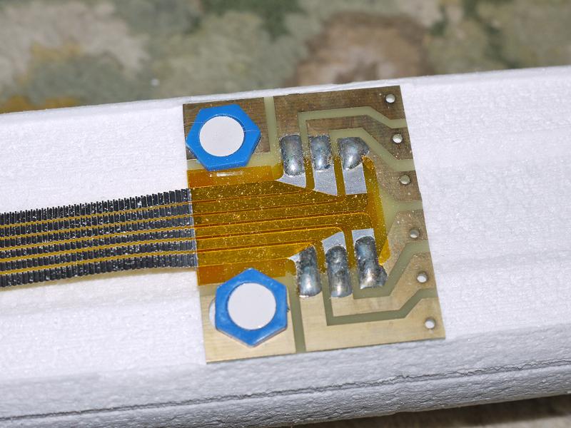

The 'blue risers' are just cork board tacks for transit. The ribbons are shipped unstretched (most nerve wracking part of the install).
I would love to be able to give house space to duettas, but they cost $$$$ here in uk and my poor little room is too small. The minors are a good compromise, even if I have days when I wonder why I didn't just build a linkwitz LX mini!!!
If you look earlier in this thread you can see pics of my old ribbons and the clear fracture across where the bars go. Sample of one as I say

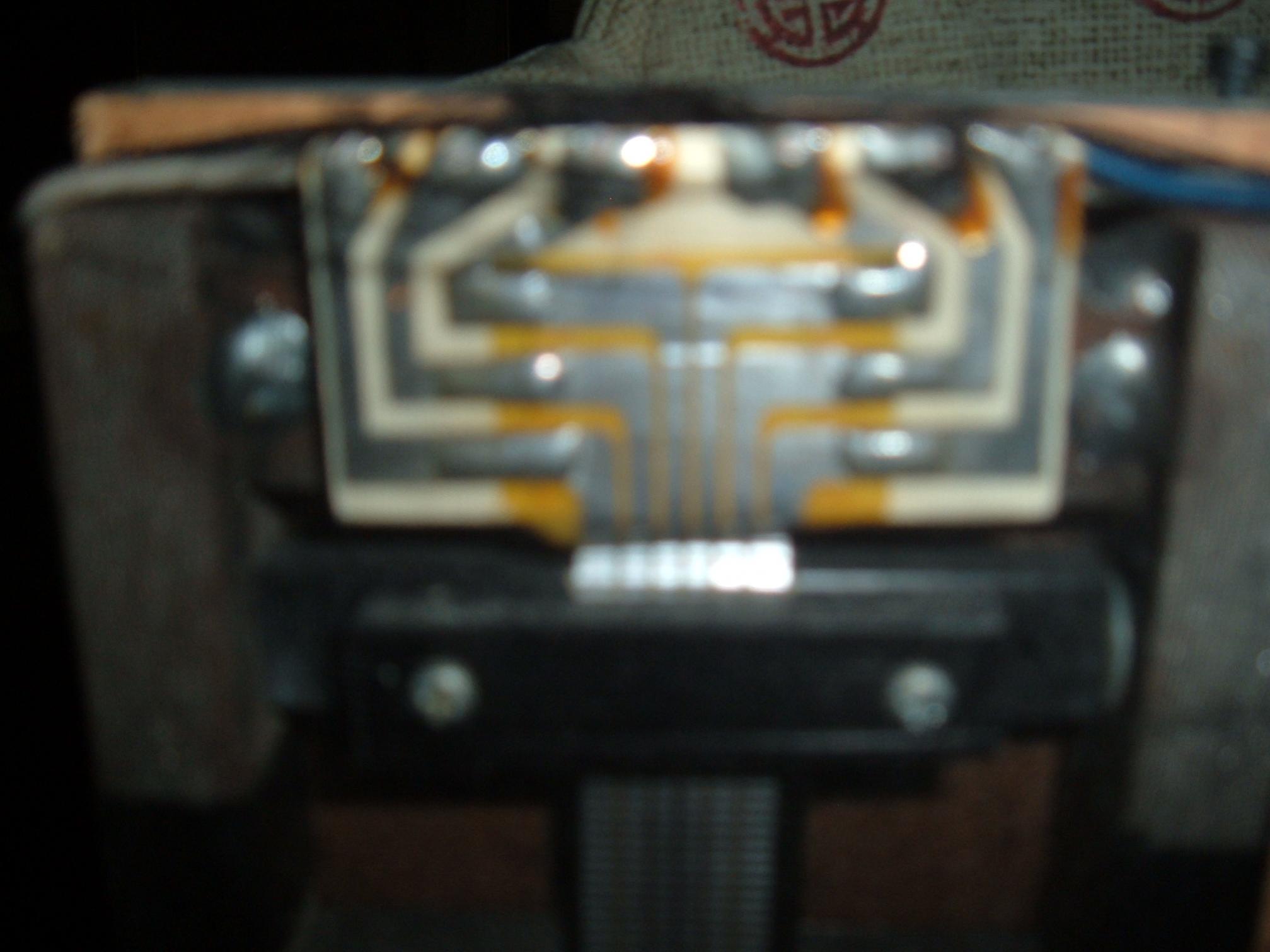

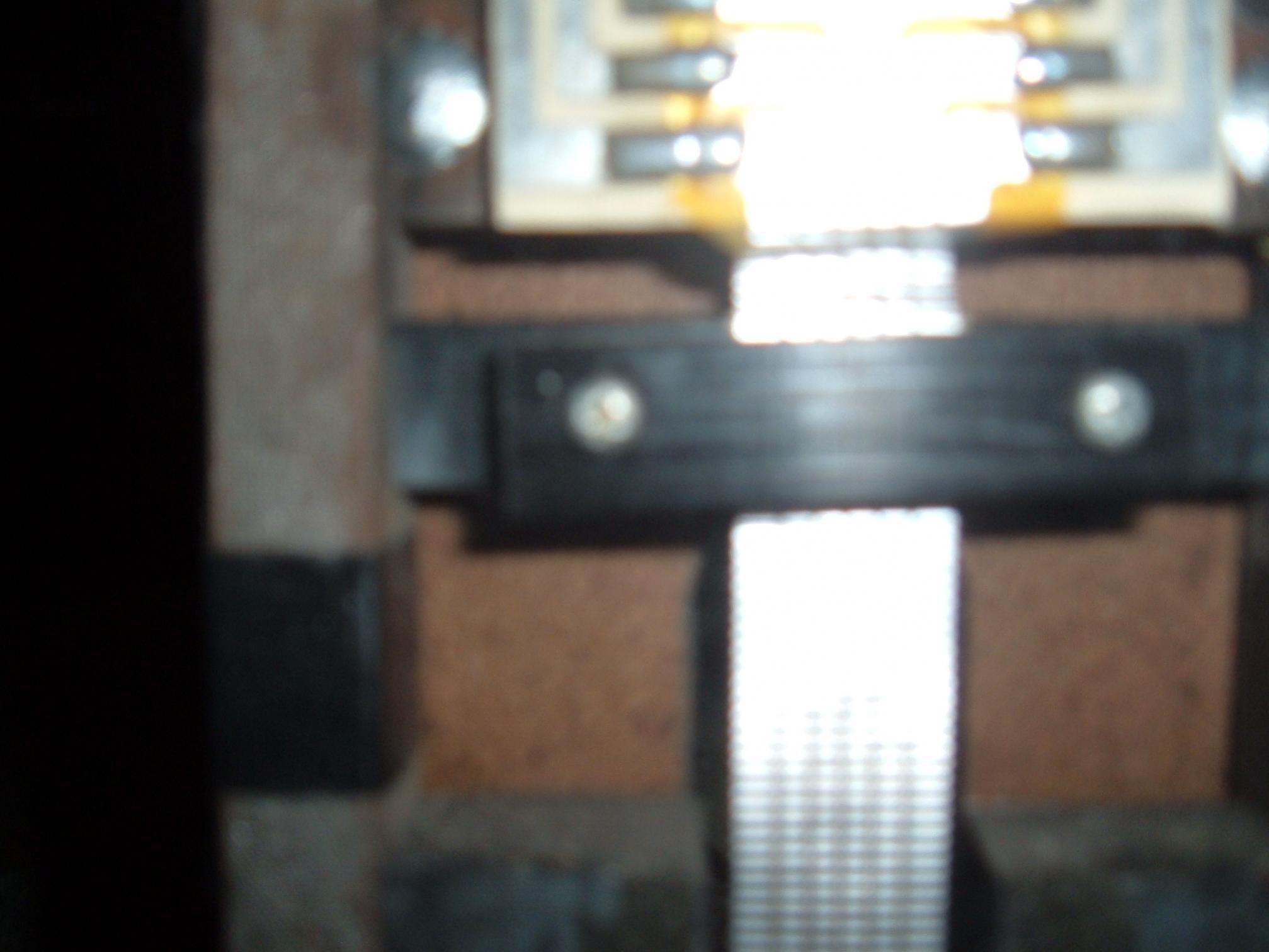

So here the take away.....with the bar off the 26" MT
The minors sound is Better than that of my Stages 26" MT with the bars ON...
an the sound of this mod....is a lot closer to the sound I get out of the fullrang Apogee....no more..no less..

Now less look as to why the Stages MT may sound Darker an has less output ........
You see that in Apogee stock mont.....we got two diff monts...one at the end of the MT ribbon.....thays bolted down from the back.....with pressure...who knows how much...........then the free hanging part.........of the ribbon it self..........is ran under the bar mont to another board....gezzs
The New Garz monts do a way with all this..............with No bars...well this sound better???
I say yes.....some may say No!....but if thay ever have to replace the ribbon
well have to live with the new mont!....mabe as we know now....the blue risers are not what thay look like.....thanks for that.....even thought it did not matter the new mont stll dose the same as if that were there....NO Bars..
So thay could just put the bars back on the new board.....hehe
One mod I well.... be doing to the stock mont setup is to remove the bolts from out of the top mont..... that has the wire to hold it in place....that well releve some stress on that board.... but the ribbon all folded over....well it is what it is...pic not that good but you can see.....pic 3 is new MT mont...
All this for me is just to get the best sound out of some of the best speakers ever made...........................an have fun doing it...hehe

Graz new clamping system for Duetta and Diva uses metal bars.
Works fine, sounds better then the previous Delrin bars.
For minors and other multistripe TW there exist no raisers. No blue ones nor other color.
That stuff is for transport only.
No bar or bar, what sounds better? No idea, i must be deaf. That why i hear no buzz on my duettas.
But my stages in the closet do buzz, both. Thats why they are there.
Currently im going on do fix my Full Range with new ribbons on all 3 ways and new transformers.
But first i have a customers diva to fix and a scintilla is also waiting.
They are 25 years old and need to be restored.
Thereafter the sun will shine again for them and their customers.

My stages both woofers are definitive buzzing.
I know where the problem comes from and it would be huge effort to modify them to avoid the problem with new woofer foils.
But since there are no new foils available for them, it makes no sense to modify.
So they stay where they are now, i don't like to ride on a dead horse.
