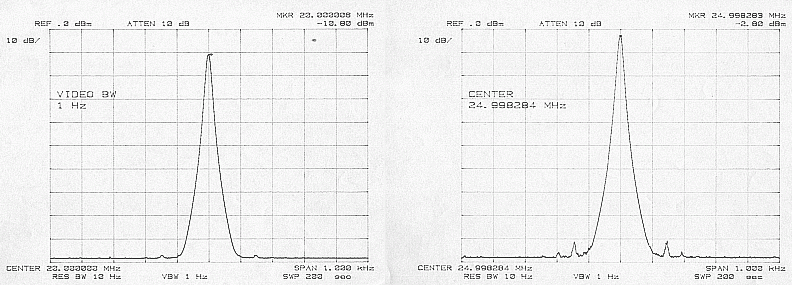

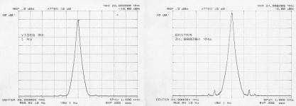

Of course - you get one great big propagation delay (being a clock divider) , but the edges are aligned up within say 5nS. The Audio data is shifted into the TAS5015 by the BCK from the SRC - so propagation delay between the Clocks is not an issue.
Yes, just connect the P661 directly to the TAS5015 HF-CLK.

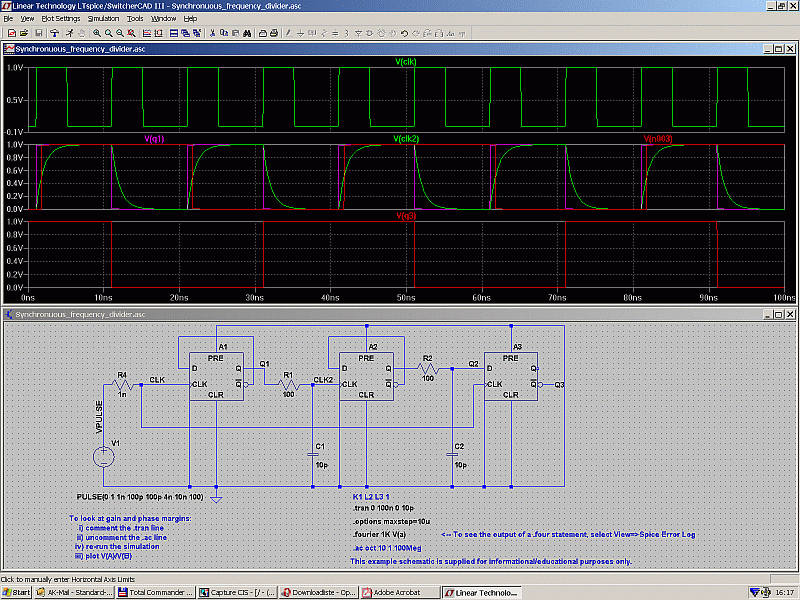

a simple synchronuous frequency divider
Don't know anything about its jitter. But it is possible to extend easily.

frequency divider
The edit button has gone...
Of course, R1, C1 & R2, C2 should be omitted in the real circuit, they should help to see the independence of the output from internal delays at the D-inputs for the simulation only.
On the other hand the small delays can make the decisions of the FFs more safe, because without them the preset time of the D-input is one propagation delay of the FF only.
In this case one must observe the maximum input transition timings to avoid oscillations or false triggering. Some months before I got this behaviour with a similar divide by two-circuit, driven by a µPower-comparator with transition times of 1µs, while the FFs were specified for max. 500ns clock input transitions. The use of Philips or TI parts with integrated Schmitt-Triggers helped.
It was a change to a second source whilst the running production.
Regards, Timo

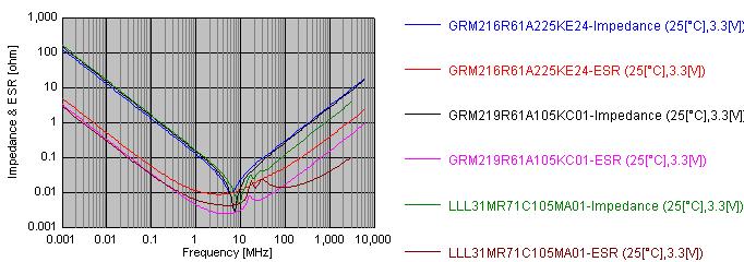

Decoupling caps: I use either ceramic 10uF 0805 caps or Panasonic SP caps. First ones have ESR less than 3mOhms and calculated ESL around 500pH. This 22uF Murata is even better. Second ones have ESR less than 12mOhms and ESL around 6nH. Typical 100nF 0805 X7R caps have ESR in tens of mOhms and ESL around 1nH. Where layout permitted I also used 100nF 0603 X2Y caps which have calculated ESL around 50pH. This may be an overkill because of the inductance of the chip leadframe. But I will add 10uF parallel to C103.

Sorry, I didn’t notice that the 10uF where Ceramics and not electrolytics, but still feel uneasy where you have just an OSCON, such as in position C137 / C138 – the physical size of the OSCON prevents short track lengths, a 0603 can be adjacent to the IC pins.
Any chance on the data (or Web Link) on the 100nF 0603 X2Y caps you have used; I’m a bit out of touch with the latest capacitor footprints – I guess you used them in positions C145, C147 etc?
I’ve always used 0612 types for low inductance decoupling, but sounds like the 0603 X2Y are better?

Your observations on decoupling capacitors forced me into action, I finally download the Murata Chip S-Parameters and Impedance library – a major undertaking using my 28Kbps Internet connection…
Interesting, for your information the Murata 0805 X5R 10uF 6.3V (Plots #2 & 3 on graph below), are better then your suggested Murata part 0805 X5R 22uF 6.3V (Plots #1 Blue & #2 Orange on graph) – and I guess cheaper.
But at the end of the day, good to see that the 0612 reverse format devices are still the best! (as I’m 2/3’s away though a large PCB design using them!) see Plots #5 Green & #6 Brown.
Checked out your lead on the X2Y caps, and seems that the 0612 is still better at high frequency for single rail PSU decoupling.

John, you are right, I should parallel ceramics to the Oscons. But I think I have discovered another flaw in design. It is not good to supply both receiver and clock from same dual opamp, since HF noise on both outputs is not correlated.
Yes, 0612caps have lower (250pH) ESL, but they are not available in very high values. By paralleling 2 or 3 0805 hi capacitance caps similar ESL (380pH for 2, 240pH for 3) is achievable, but lower ESR. You also right about X2Y caps, they are mostly exotica, but in some places they fit nicely on PCB. Mainly I wanted to use caps that are easily available and Farnell stocks them all.
Regarding Colpitts, I have no other means of measurement but HP8568B spectrum analyser. I have compared my clock to HP internal reference oscillator and found no significant difference. See attached picture, left is reference oscillator, right is my clock. Frequency span is 1khz, at 100Hz offset noise is already 90dB down. This is does not imply that I am satisfied with the circuit, It is only first workable implementation. I will study oscillators some more, in particular some patents.

Reverse format SMD devices have much lower impedance due to shorter physical distances between pads – combined with a larger contact area and lower resistance termination to the internal metalized layers.
E.g. 1206 has pads at opposite ends – and furthest apart, while the reverse format 1206, the 0612 has the pads on the closest parallel sides – which are also the widest.
The reverse format 0805 is 0508 etc.
The benefits of there lower impedance only becomes significant at above say 100MHz – but remember that the capacitor has to perform well at twice the operating frequency of the device, so if you have a logic Gate clocked at 100MHz, the PSU current is drawn at 200MHz (as you have 2 edge transitions per cycle).

How did you download the screen-dumps from your HP8568B? If you ever need spares for your unit - I have a HP8568A RF section which I use as a spare source for my B's (same unit, just older uP).
Great Spectrum anaylsers - much better performance then the newer HP / Agilent designs!
I find the HP3585 (40MHz) better for low phase noise clock work, has greater dynamic range.
